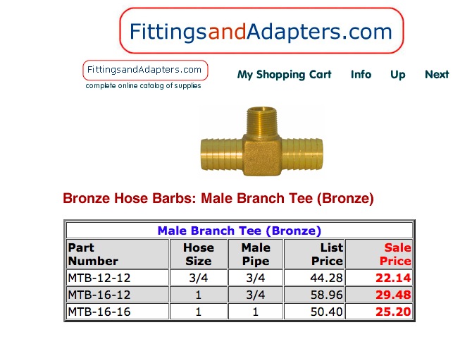

After working on winterizing systems I thought about how much easier it would be if the lines coming in after the thru hulls had inline ports to connect a hose thru which AF could be sucked.
I searched the forums and found a reference to this by Nahart51 on Oct 25, 2013 in Jen and Fred thread titled Catalina Winterize.
My questions is then, is there a reason not to do this? I searched the internet and could not find such a brass connector that would have two barbs and a hose connector of the proper size. I did find ones that are made for auto AF flushing but they appear to be made of plastic and don't know if I would want to trust them below the waterline.
Any thoughts? Thanks.
