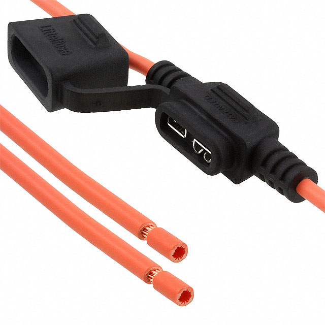

Oct 29, 2016
1,929
Hunter 41 DS Port Huron
Replace the existing with one of these, when reconnecting wire connections ensure you use the proper size crimp splice with heat shrink tubing with sealant
