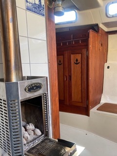

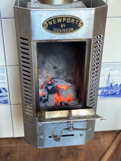

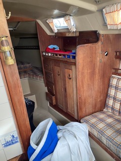

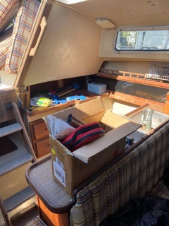

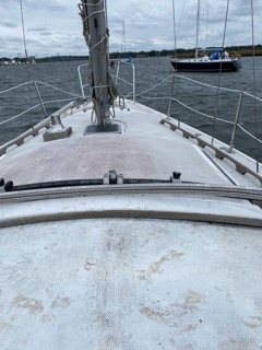

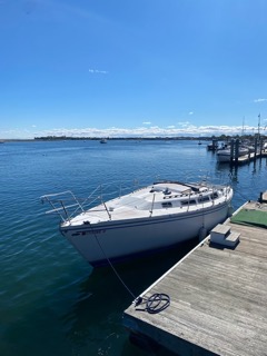

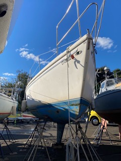

I'm the worst at posting photos - but if anyone cares. This boat has been in the club for a while and over the years, due to personal reasons, had become badly neglected. Her bones are good but she needed an intervention fast or the scrap yard was in her future. I purchased the solid fuel stove from the owner and he threw in the boat with it. Last summer she spent alone on her mooring with on the birds around to turn her deck into a toxic wasteland.

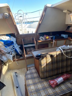

With the promise of beer and a burger and a good friend joined me in full hazmat gear to power wash / deck scrub and declutter directly to the dumpster. The was a frigg'n night-stand table in the v berth?!?! ...then haul out day.

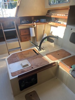

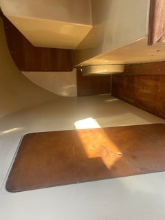

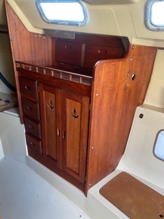

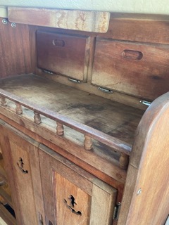

I have no photos of how good the deck came after cleaning, but it was remarkable. the Gel coat has very little crazing or chalking and will polish up nicely. The non-slip areas, however are discolored and show signs of wear. I think some Kiwi will clean those areas up nicely. The only soft spot on the deck is in the cockpit caused by a lack of sealant around the wheel pedestal. On the to-do list it goes. As I mentioned the motor will be replaced so along with all the removable teak, the galley sink area was removed.

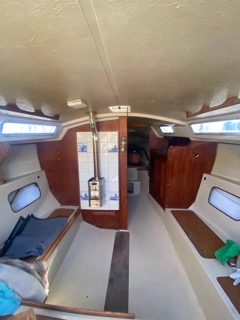

A damn good scrubbing and some teak oil and the interior trim is getting reinstalled. Soon she'll be covered for the winter and I can remove those portlights for a rebuild. Sure is fun to work on her with the little fire going.
