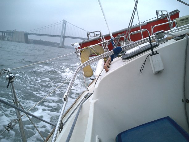

We've had them soft and hard
and hard is better, at least for us. Oyster shells on beaches eventually had the iflatable looking like a very old much repaired inner tube. It towed terribly -- would actually become airborne and land uposide down. Didn't row worth a hoot and wasn't all that stable either if you stepped wrong. We bought a hard dinghy in an emergency when the inflatable defied repair. Only wish I had bought a sailing model. The same Cruis'n'Carry engine works fine but mostly we row. Davits solved the stowage problem. See photo.
