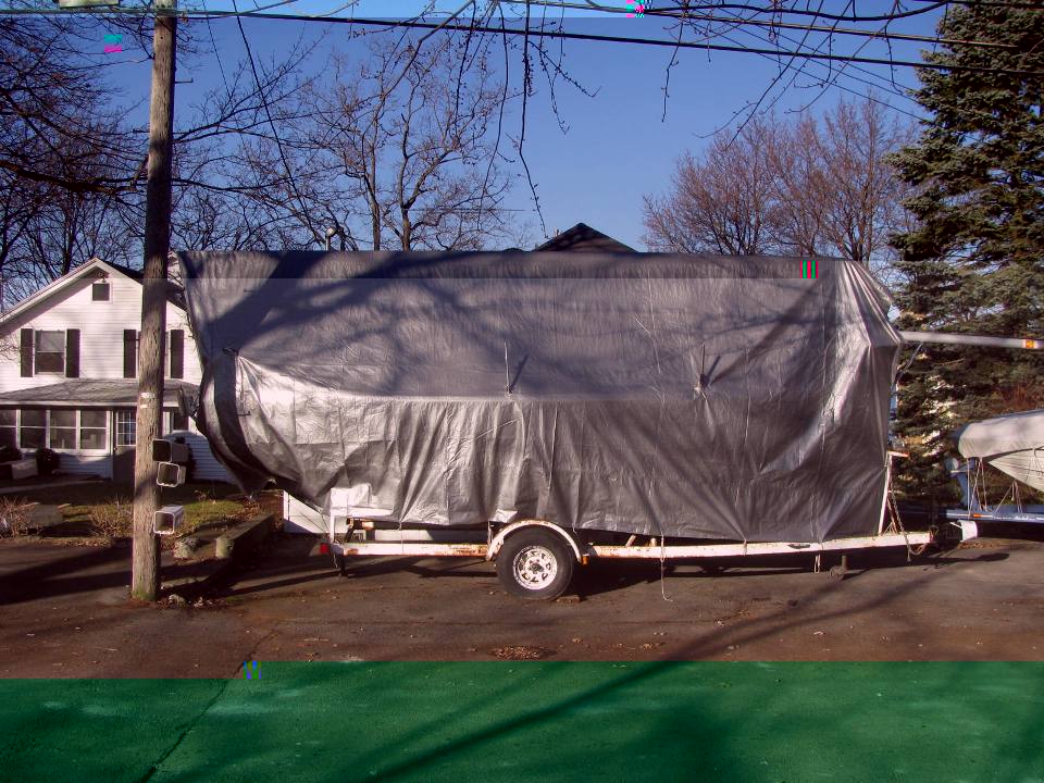

My boat is stored outdoors for now and I use a heavy silver tarp from Harbor Freight as a cover. I made some simple legs and use a mast from a derelict Ray Greene Rascal 14 for a ridge pole. I poke the stanchions through the tarp to get a good slope that sheds rain and snow. So far, I have 3 seasons on the tarp and will use it again this year. It probably leaks some, but I've never had water in the boat. I leave the front hatch and the starboard cockpit locker open a little to keep air circulating and strip all equipment and cushions off the boat.
I put a small bag of charcoal in there and have heard of people using Bounce sheets to keep things fresh and the vermin at bay.
