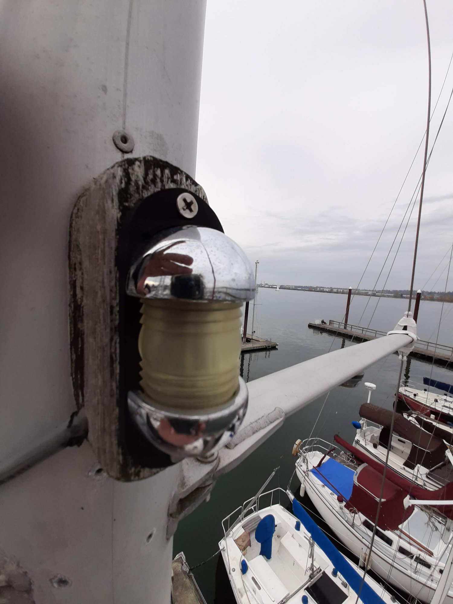

The incandescent bulbs draw a ridiculous amount of power but more importantly, the lenses on those fixtures are so fogged over that only a small portion of that light will get out and will be very diffused. These lights are for safety so you need good lenses. On my boat the lenses on my Aqua Signal nav lights were not in a bad shape as yours when I replaced them. I also used Dr LED bulbs. Now, if I forget to turn off the running lights after returning to the dock, the first person along will knock and ask me to turn them off because you cannot see to walk on the dock without shielding your eyes from them. :dancing:

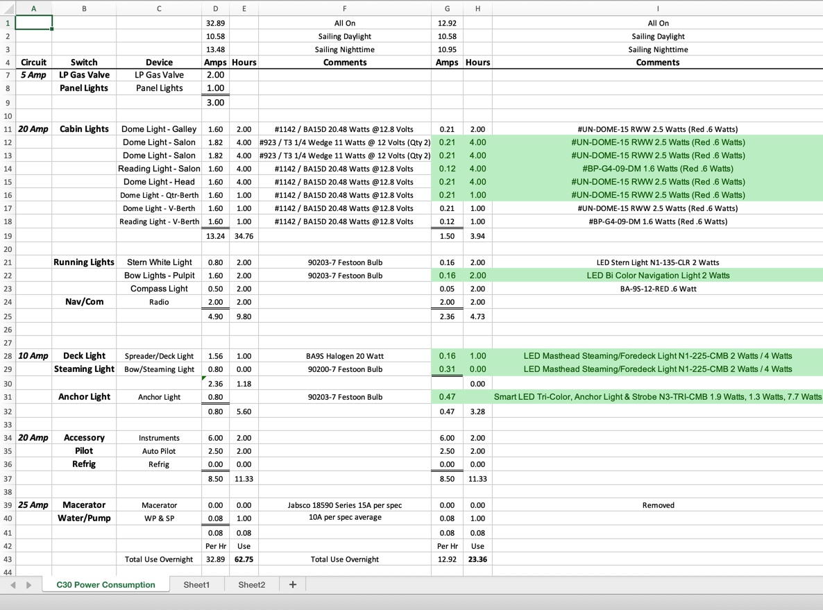

Here is a screen shot of my power usage spreadsheet. It shows several types of bulbs and the rated current draw for those bulbs.
On the right side is the LEDs I used and their power draw.

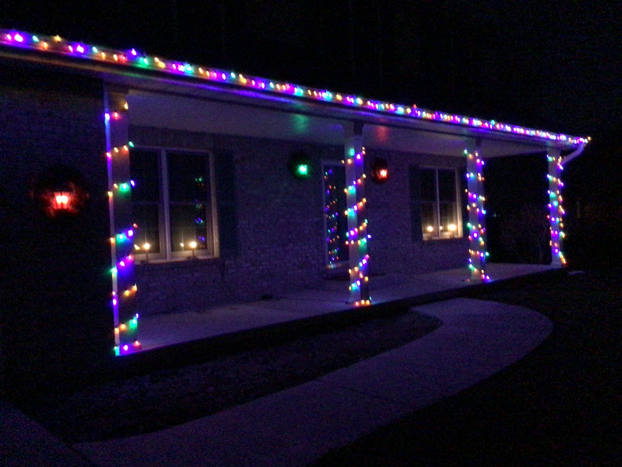

I bought some wi-fI enabled LED bulbs that I can program on my phone...
Turn on at 6:00 am in a nice warm whit color...turn off at 7:30 (at least now).
Turn on again at 4:30 pm.. Red / Green / Red / Green / Red (I have 5 across the front of the house and Garage). Then turn off at 10:15PM.
After Christmas, I will reprogram these to just be white at night.
On the boat, I bought LEDs for the cabin domes. They were way too “white”. I bought new bulbs, a little “warmer”, and really like them.
And the Christmas lights are all LEDs this year. Way lower energy draw than the strings of C7 incandescents I finally threw out.
