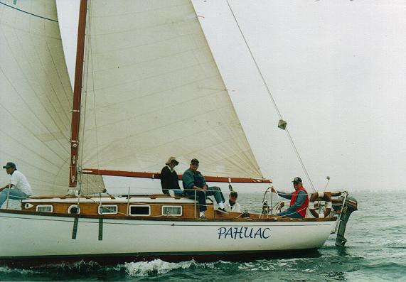

Carlos Silva
It is an outboard
Your point on the gasoline inside the sailboat also scares me. On the other hand, I think I have a nice boat but the outboard just does not make the mark. A regular inboard would probably mean sacrificing the wheel and a new engine with saildrive is just too expensive. Thanks,
