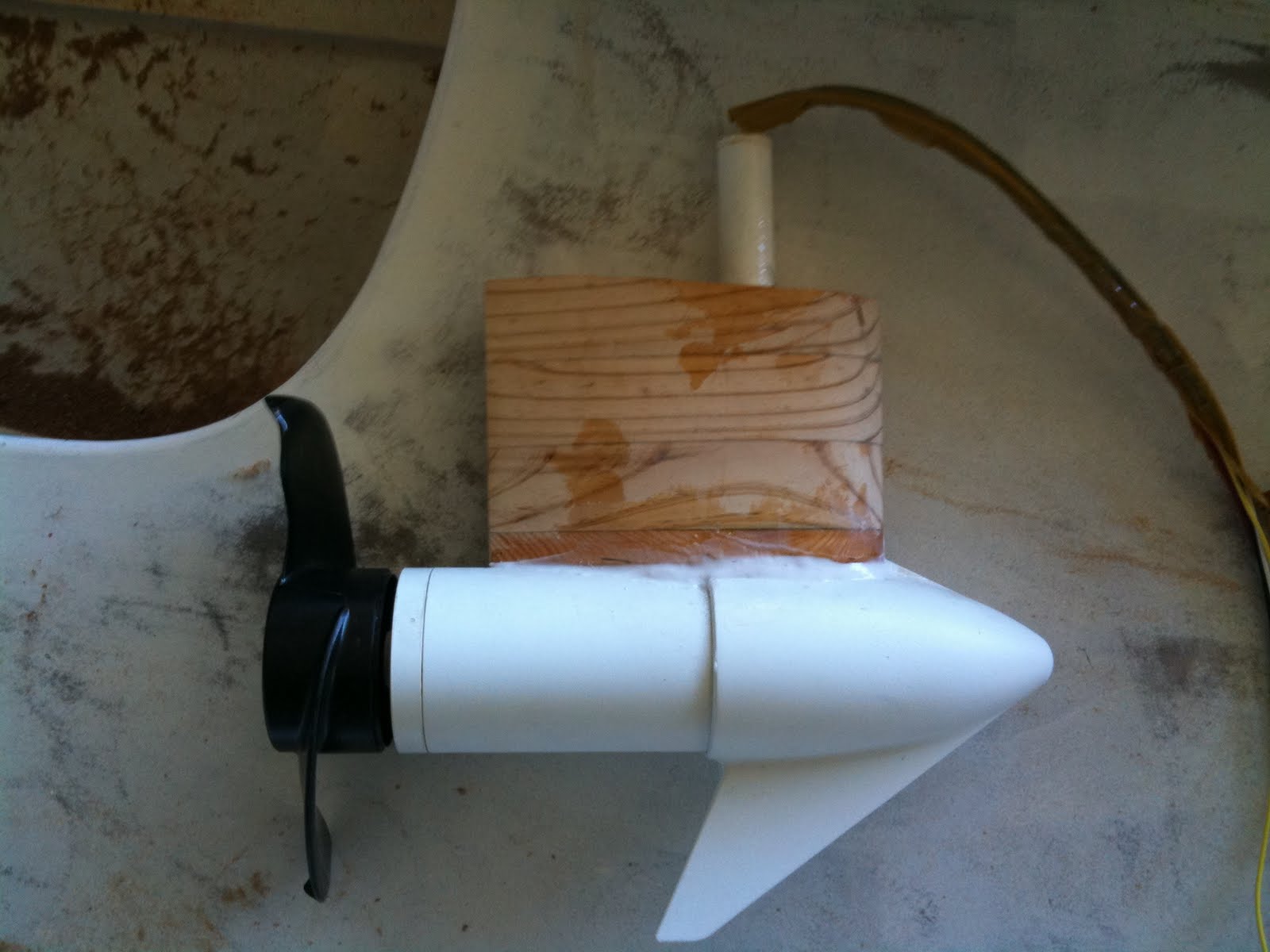

What about something like this?
I can glass a good size backing block in the bilge and screw it to the bottom and only have a small hole for the wire to pass through.
This is a 160lb thrust saltwater motor, 4 times that of what I already know works good enough. I like that the throttle is a small dial instead of a tiller I was having concerns of where to keep and 'hide' such things.
