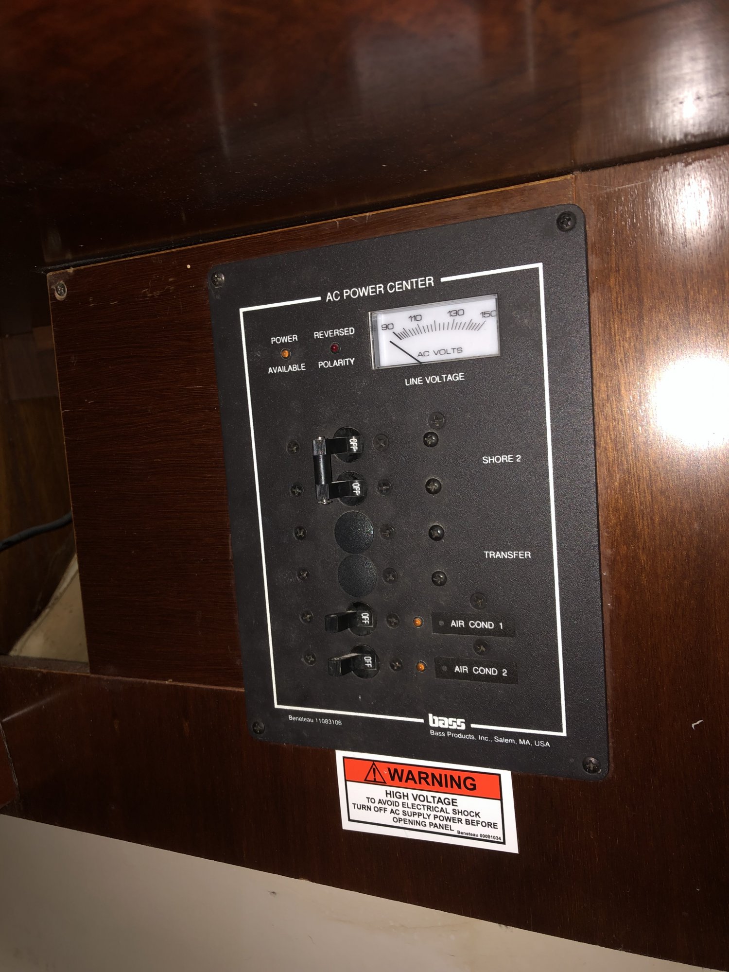

I just acquired a Beneteau Oceanis 35.2 and the boat will not hook up to GFCI shore Power on the hard. The shore power comes into TWO segments of circuit A) the MAIN circuit ( upper electrical panel) and . B) A/C :Air Conditioner circuit. ( lower electrical panel)
When I plug in from fence line GFCI to the boat, both panel power available lights illuminate, (main AC power available and air conditioning AC power available). Everytime I close the main onboard switch to “accept main ship power” the fence line GFCI trips.
When bringing the boat up during its ferry run AND while dockside, at Haverstraw, as well as previous marinas, There was ALWAYS a CONSISTENT ABILITY to ATTAIN shore power.
Note: prior to closing the main ship power switch to “ accept” shore power, all user-switches ARE “ OFF”. Despite this, the fen line GFCI TRIPS.

A GFCI will trip whenever it detects power going out on the hot wire that’s not balanced by what comes back on the neutral wire. That generally happens if power is coming back on the ground wire or through earth. It could also happen from nuisance trips caused by some appliances.

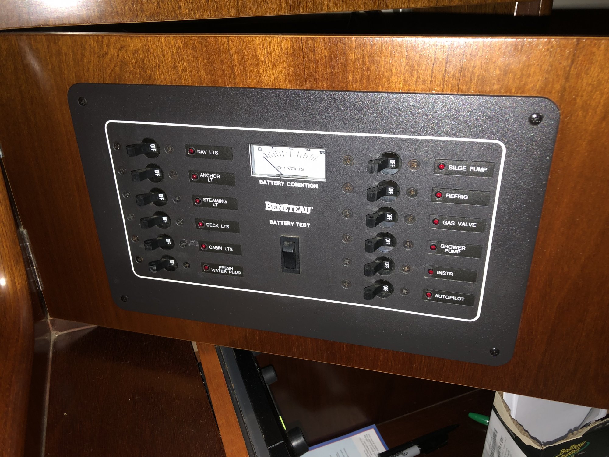

The status of the switches on the DC panel don’t really make a difference for the GFCI. The DC circuits are powered by the batteries and don’t really touch the AC side.
To help narrow down your problem - Do you have a battery charger? Water heater? Are there any other AC devices plugged in to outlets? A fault in any of those could trip a GFCI. It’s also possible that the boat is wired improperly and tying neutral to ground onboard, which could allow that imbalance.
Are you plugged into a 30A plug with a GFCI, or is it a 15/20A socket? Were the other outlets you’ve used successfully in the past GFCI equipped?
