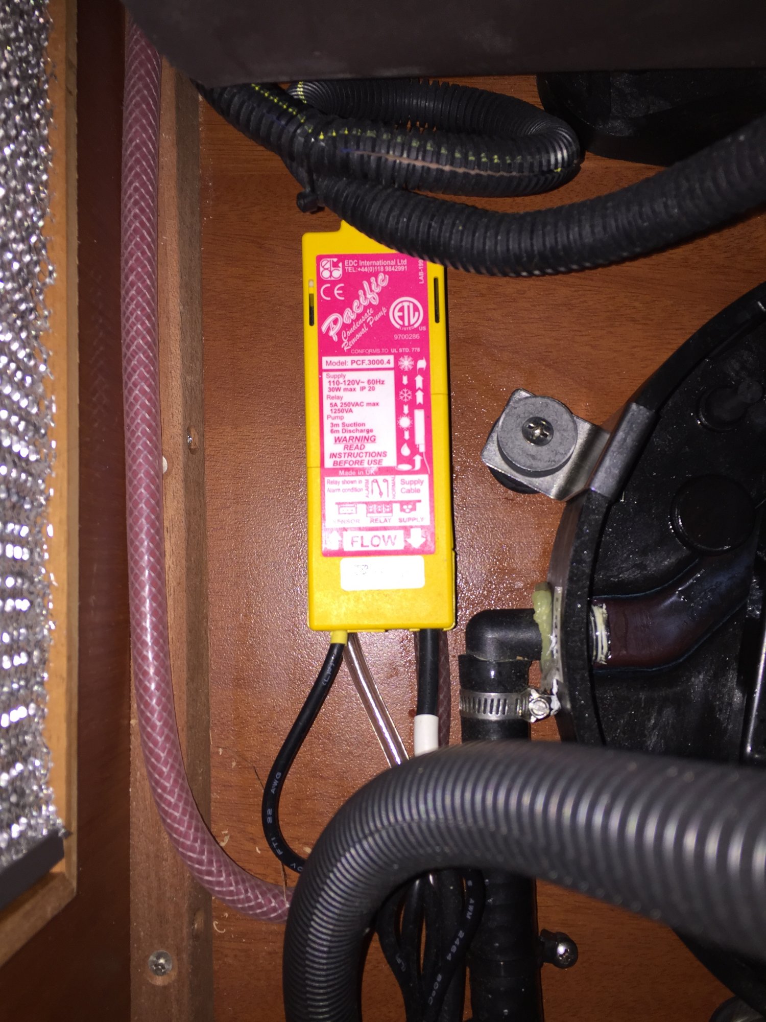

I use quite a few condensate pumps at work . They are taller than the floorboards will allow .They also need a much wider area and leave at least a half inch of water on the floor
The one we have looks like this.
It’s maybe 6”x 2” x 1”. The condensate pan under the AC drains to a hose that goes to the input of the pump. That hose has an in-line water sensor to activate the pump.

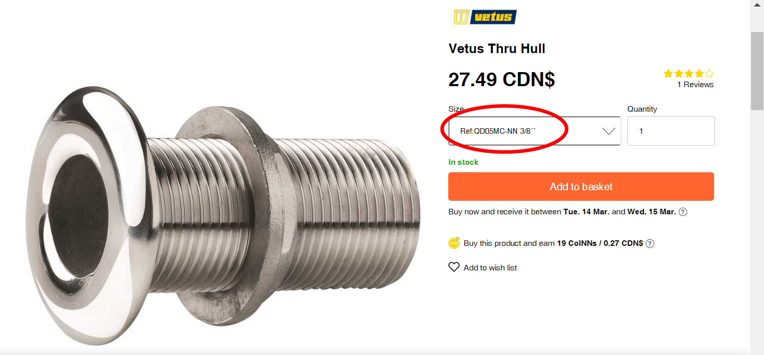

Never had or seen an AC unit on a boat but I always hear the same problem that the condensate discharge goes to the bilge. I'm assuming a gravity feed from the condensate sump of the unit to the bilge
If the AC unit were high enough, is it possible to install a small 3/8" thru hull below the floor boards under the AC and allow the water to gravity drain out the thru hull ? Who knows, if you're of a religious inclination, the through hull could be above the water line for ease of installation.
Tubing could be as small as 3/8"going down the wall. Lot's of time at the drawing board to work this out but who knows, it might work.
May 17, 2004
6,260
Unfortunately AC units are often installed in places like under settees or other storage hatches close to the level of the cabin sole. That puts them low enough that they couldn’t drain above the waterline, and any drain below the waterline would threaten siphoning either at the dock or when heeling.

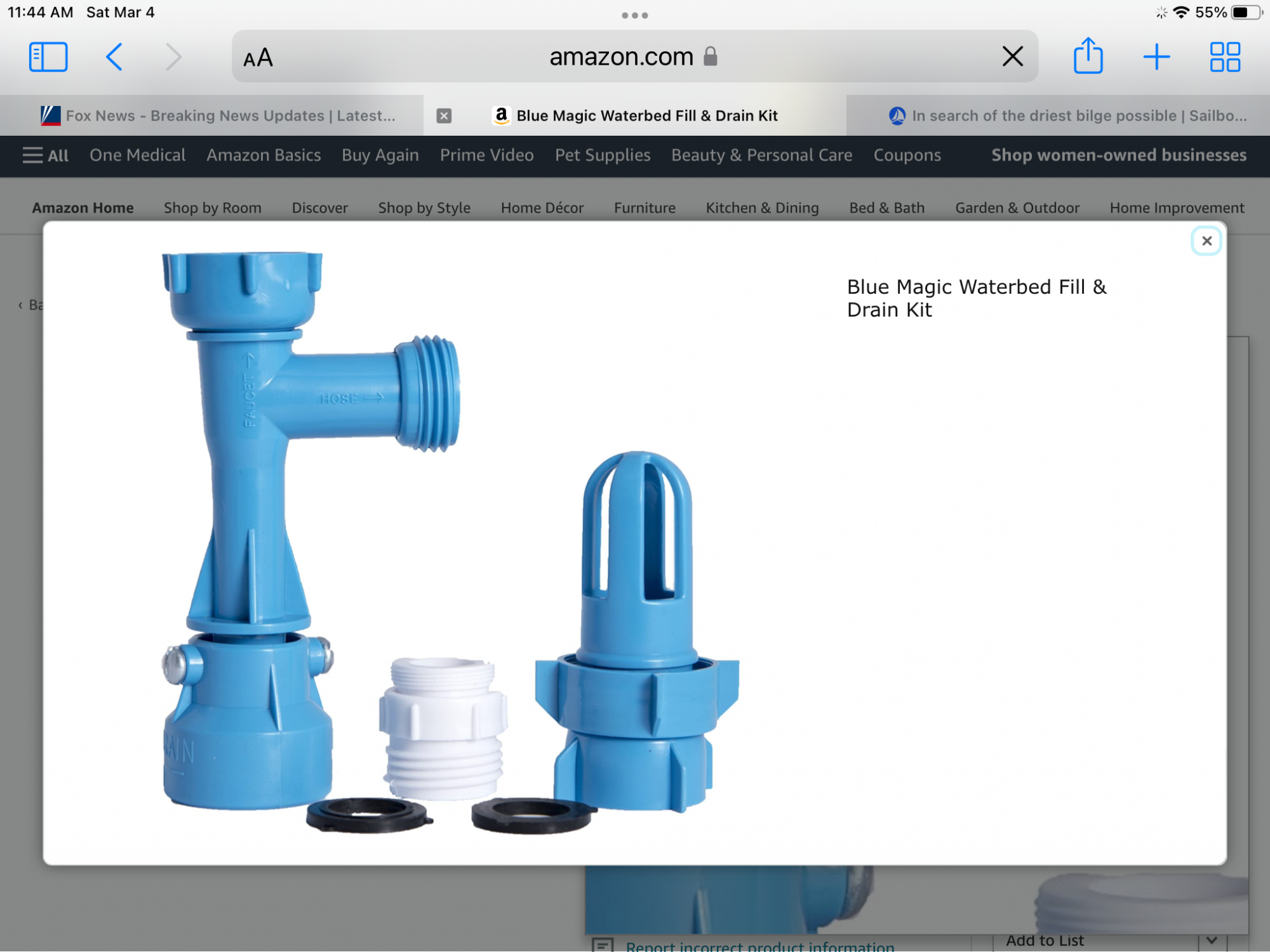

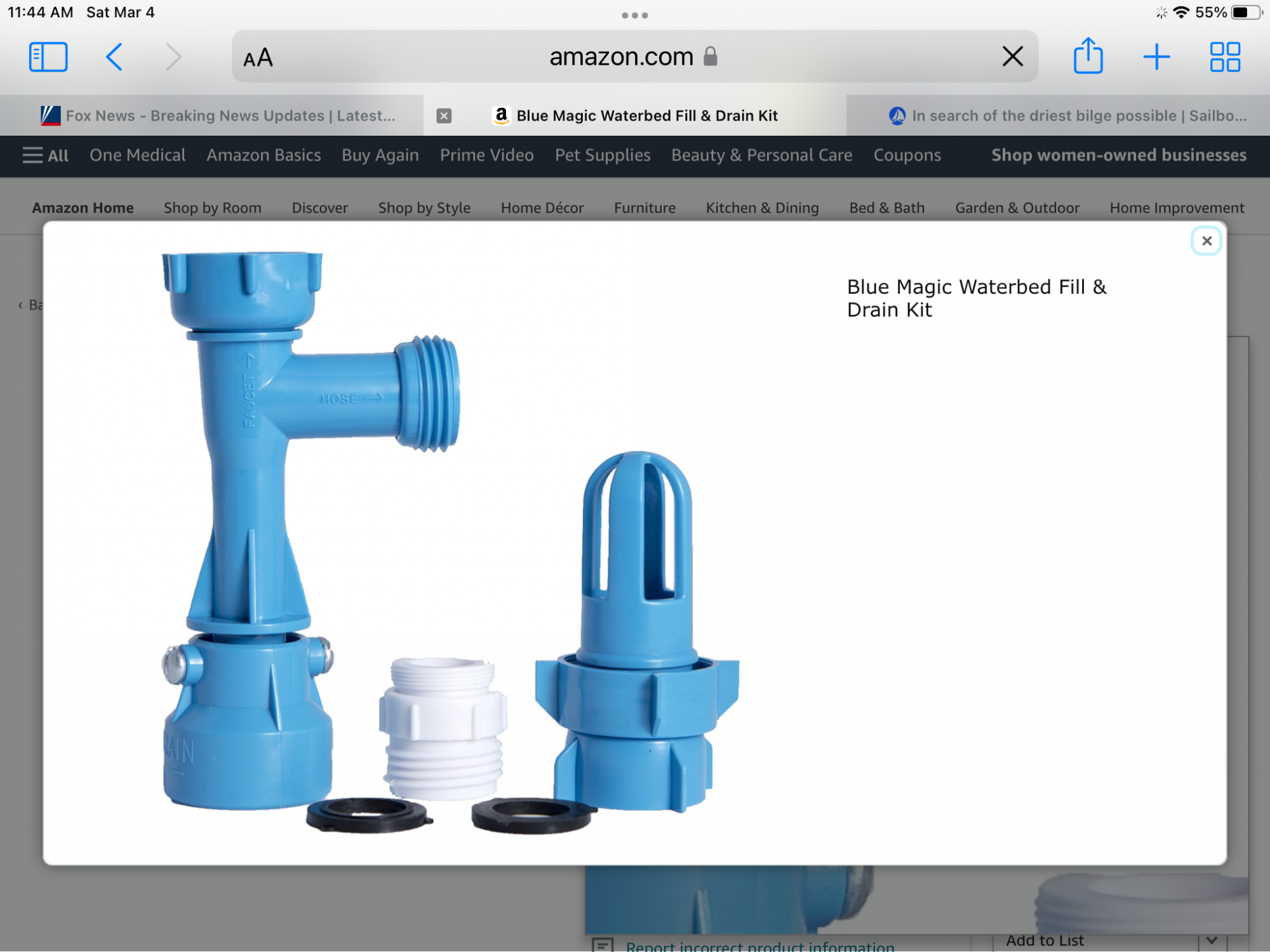

Here in Florida I run the AC the entire time it's at the dock on shore power. The AC condensate drains straight into the bilge. The waterbed drain kit looks like a viable option. Definitely cheap enough to give it a try. I don't want to take all of the humidity out, that would damage the wood.
