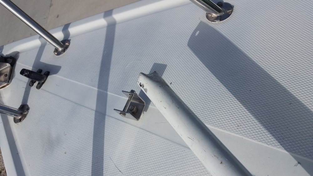

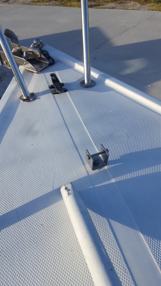

There is a swivel mount on the foredeck that I am not sure what is. There was also a pole that was in the boat that I cant seem to find any information on.
The closest thing I could come up with is that it is some sort of bowsprit setup. In my limited sailing adventures with friends I have never been on a boat that used a bowsprit setup so I cant be sure of how it works if I am right.

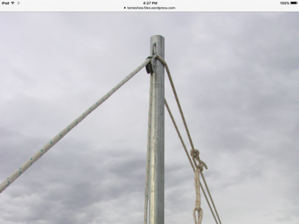

As for that pole and fitting. I'm guessing it is some kind of gin pole to assist with raising the mast. A line would go from the mast head over the top of the vertical pole and then to someone on the ground or through a block at the stem and back to a winch.
The mast probably has a tabernacle or some kind of hinge at the base. By running the line over the top of the pole, a better angle is achieved to lift the mast head making the mast vertical.

It could possibly be a boom for the jib. making it self tending. Does it clear the mast when attached? jNeed better pics

It looks like the pole could be a jib boom from this photo.

Is too far back to be a self tending jib boom and awkwardly positioned to be a mast raising auxiliary, my best guess is that it attaches to the clew of a genoa to keep it open when sailing wing to wing or in light air. From the pictures I do not see a deck fixture that would make it into an adequate bowsprit. If that base swivels it is a whisker pole holding bracket.

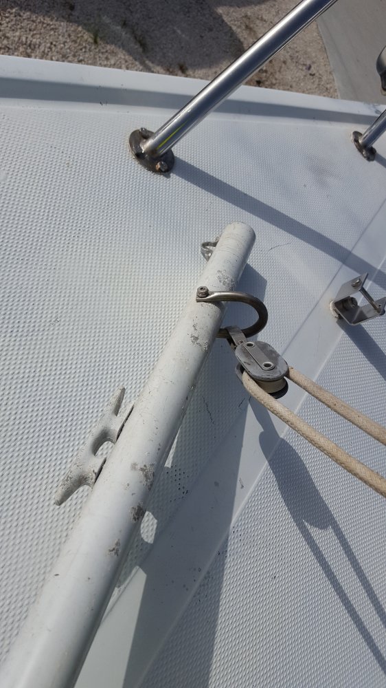

There is a block at the top of the pole along with 2 cleats and an eyes strap. Run lines from the cleats to stanchion bases and a line from the eye strap to the stem, as if it were a mast and these were the stays. The heavy line goes through the block at the top of the pole to the main halyard which is run to the top of the mast. One person picks up the end of the mast and starts walking it forward and up while another person hauls on the line to pick up the load and stabilize the mast while the forestay is attached.
Cap shrouds are loosely attached to stabilize the mast from side to side and tightened once the forestay is attached.

Show us the fittings on the ends of the pole. Many MacGregor's use a gin pole to raise the mast.
It makes it easy for a single person to raise the mast. The pole is then removed and stored until time to bring the mast down.
We need pics to be sure.

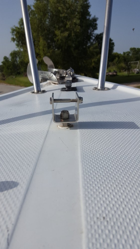

@Rward021 Welcome to the adventure. As you can see there are a lot of knowledgeable sailors here.
As always the responses are only as good as the information you share. @Ken Cross makes a good point, send us pictures of as much of the items you want help with. It helps for us to better understand what you are seeing and to give you responses that will help.
@dlochner has a lot of experience and his description of a "Gin Pole" setup is right on.
The challenge is that what your showing could be a lot of things that a previous owner thought valuable to put on the boat.
The picture of the Ushaped metal thingy with a bolt running through it, is exactly the design used on a boat I owned. It is sometimes called a tabernacle and was used as a mast step for my 15 foot sail boat. It can just as easily be used to attache a gin pole to help raise the mast. It also is a trip hazard if you are jumping to the bow to lower the jib.

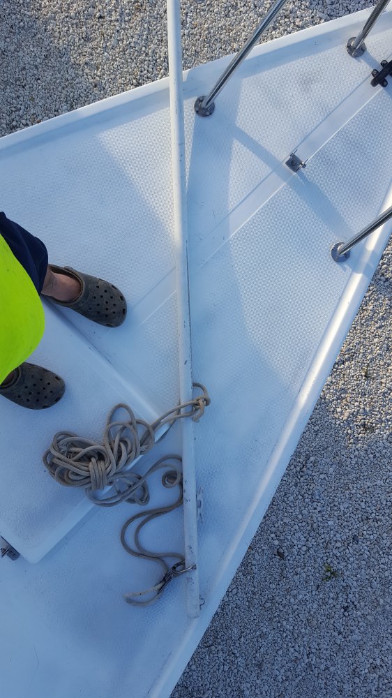

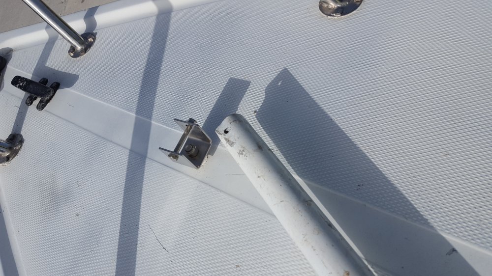

Alright so this is the poles fittings.
The pole is 7ft long
I'd try to get that pad eye or the block on the gin pole to line up with each other.
Even better, lose the pad eye and tie off your lifting line to the baled block. You may want to change the block's mounting orientation, I think.
