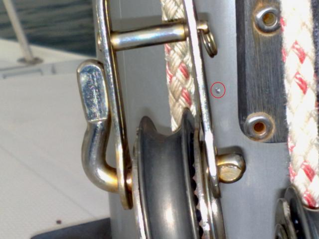

I drilled my drainhole (of pinsize) next to the vang attachment, reasoning that there would not be too much to hit inside. Also, did it with the mast full of water. This let me know immediately (with a stream of water) when I penetrated the mast wall.

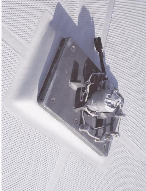

According to paulj's photo I probably could have drilled the hole closer towards the mastfoot for more efficient drainage.
Dec 25, 2008
1,580
catalina 310 Elk River
Paul does not have furllowed main, I wonder how much different my base plate is.

Have also attached picture of the hole I drilled (much smaller than suggested by Sparcraft) which seems to be doing the job.

Can you show the picture they provided?
Seems like your hole is way too high and small?
Jul 1, 2009
221
Catalina 310 Sydney-Pittwater
Agree, that the hole could be lower. I was trying to be careful not to drill into anything that may be lower down - and size does not seem to matter in this case, as it all appears to have done the job during a recent deluge. Shall check again after today's downpour.
