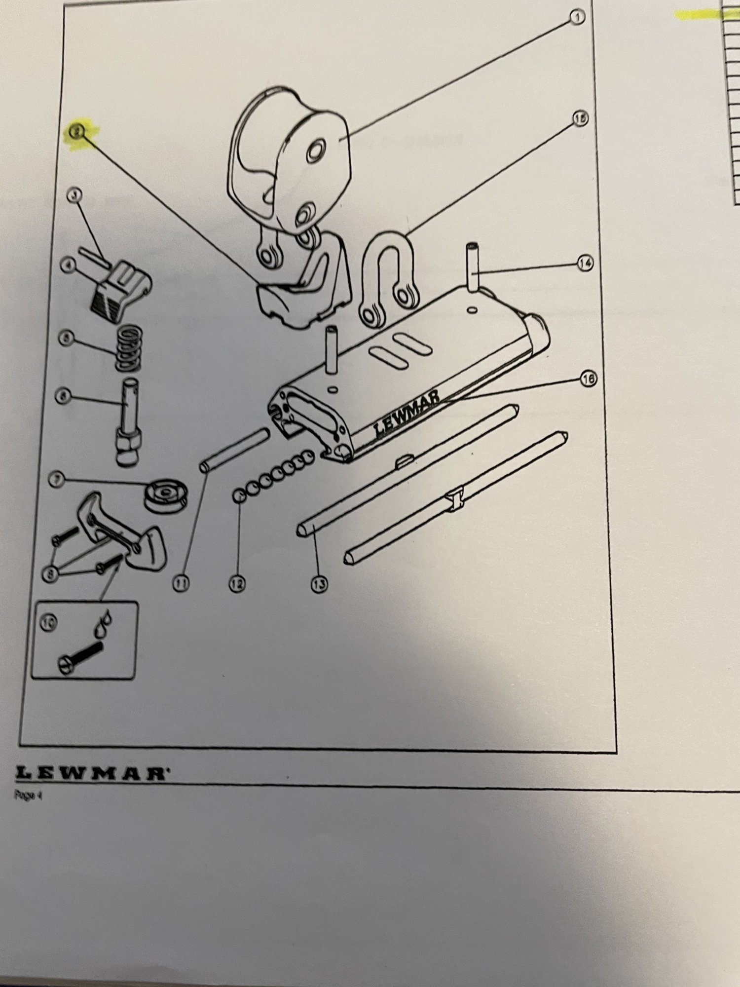

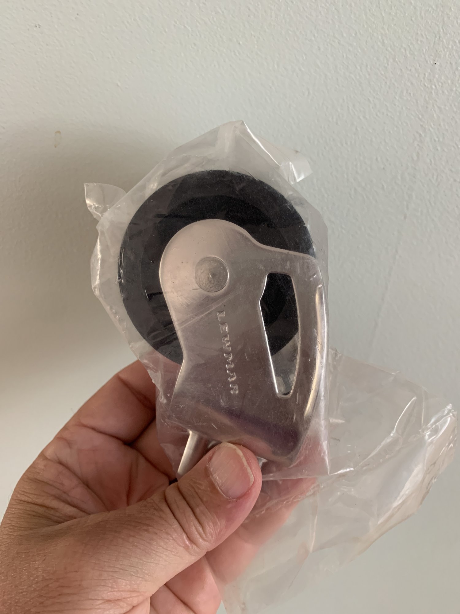

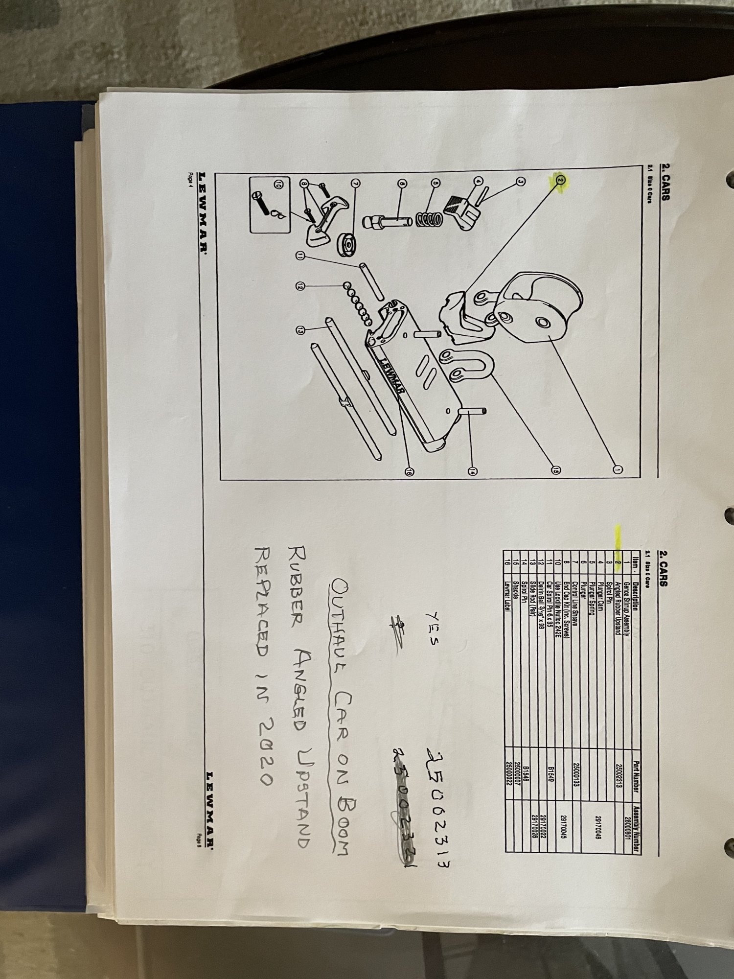

Last year the Rubber Angled Upstand fell apart on my in-mast furling outhaul car which rides on the boom. It is rubber and accessible to the sun and will degrade in time. Mine fell apart and when sailing or in the slip would whistle loudly in the wind. The Genoa Stirup assembly also becomes wobbly. The car assembly on my boom is a Lewmar on my year 2000 310. After much looking and telephone calls, a Lewmar tech gave me the part number and a drawing to help replace it. I had to nip off a little of the up-angled rubber to install which wasn't very difficult.
Lewmar part # 25002313 For size 0 cars
