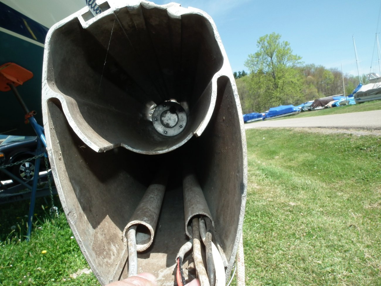

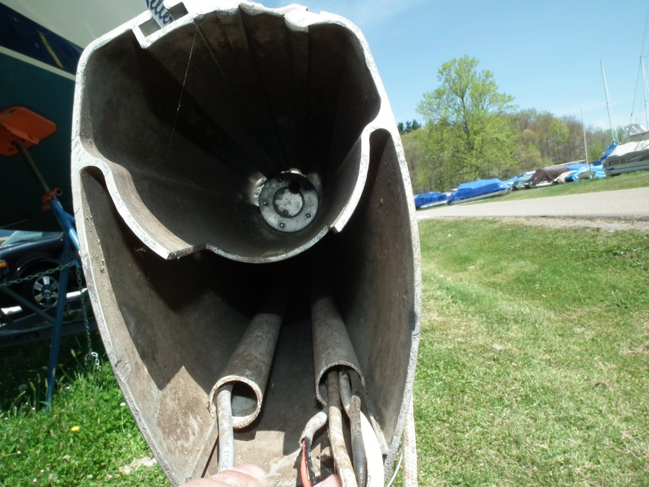

I have haul 104 with furling main. Mast made by Charleston Spar. Here is a picture from the bottom of the mast.
Apr 10, 2010
142
Catalina 310 166 Dartmouth, Nova Scotia
Thank you for the mast photo, greatly appreciated. Have contacted Charleston Spar for specific directions as to how to proceed. Thanks again.
