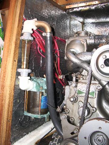

Here is an analog flow meter I have been evaluating on my salt water cooling flow rate. It has been handy to see restrictions as they develop rather than after the alarms are ringing. This particular one would not be for fuel, it is only for water. You might look around at McMaster-Carr for something rated for organic solvents. It might be pricey. Once you know what is available, scrounge around the industrial surplus stores. I got mine for $12. I get about 2 gallons/minute at idle and around 7 gpm at 3000 rpm (right on Yanmar's spec for the 22GMF). And just in case something were to fail, my strainer is above the water line.

Allan - that is a really cool setup!
[ref: post #4]
Never thought about doing it that way. Instead I bought a sensor-type device that fits on the incoming water line and when the flow gets down to a certain low amount it sets of an alarm. Installed it several years ago but never connected the alarm!!!
What you did is really thinking outside the box! Good idea.

What you are looking for is called a 'rotometer' .... slightly conical sight glass with an internal 'float' (similar to what is in Alan's description/pic.). These are available from many instrument and industrial suppliers; the reading is based on the apparent viscosity of the fluid being measured so you need to specify the fluid for a direct read, or do the math from the reading. For fuels, the only caution is that such should be rated compatible for the fuel ... and also consider to get one with a 'hazardous/explosive' rating (which wont be cheap).
