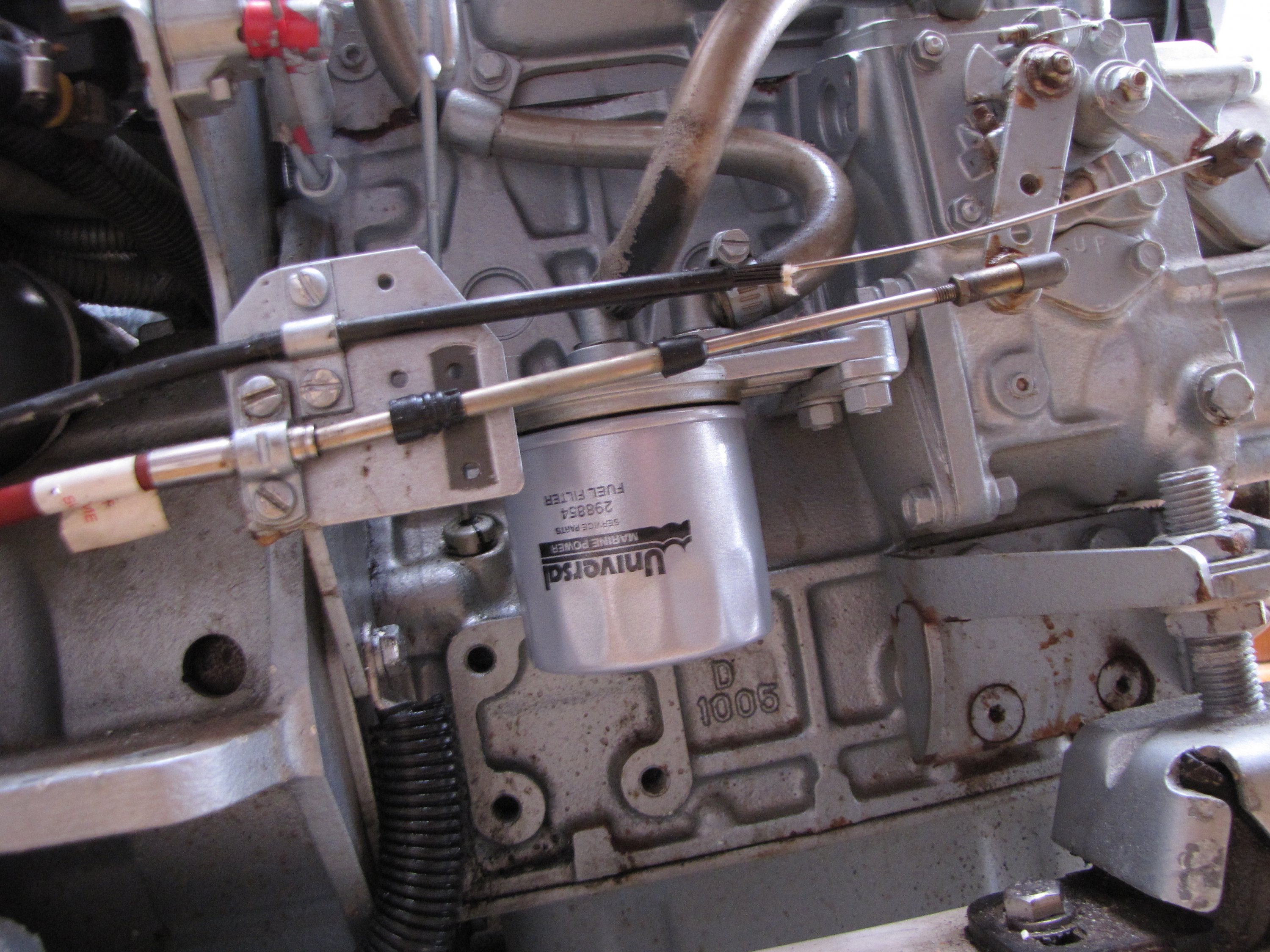

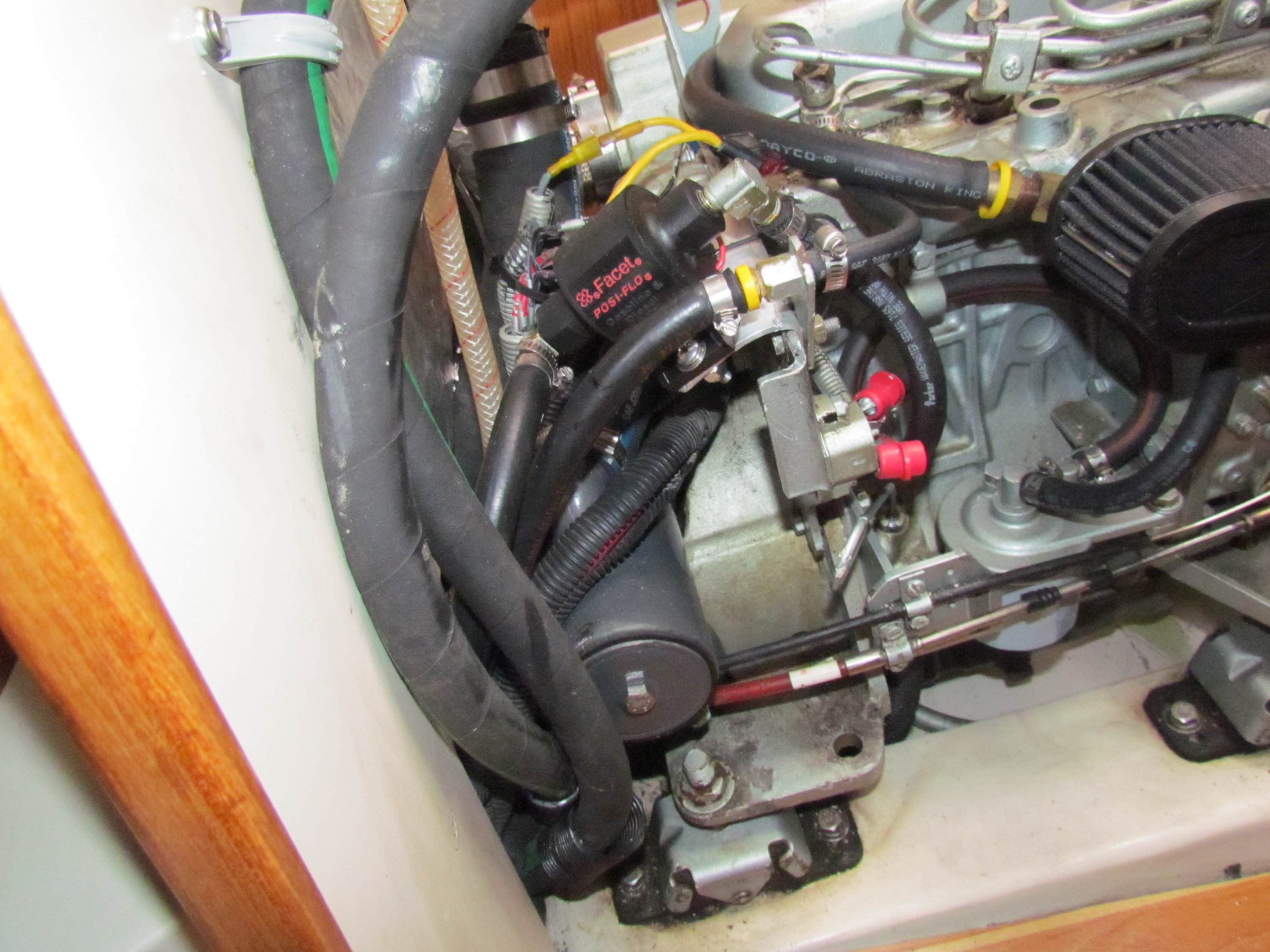

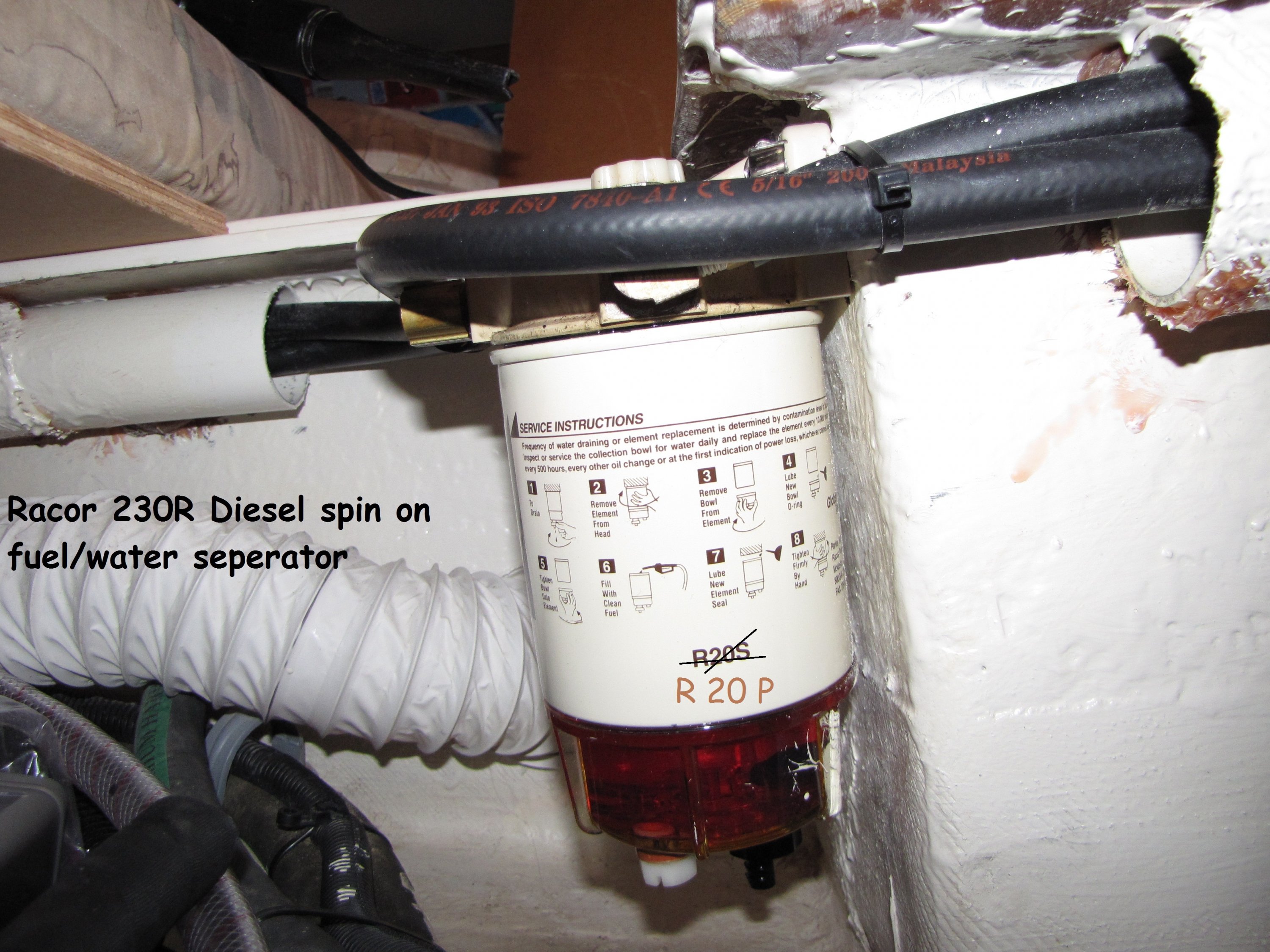

This is how my fuel system is set up.
Primary.......Racor R20P 30 micron fuel replacement element for the Racor 230R
Fuel pump.......Facet Posi-Flow EFP - 3
Engine.......Universal 298854 10 to 14 micron efficient %:what:

Not familiar with that pump, but it may be that the older ones (possibly a different manufacturer) had a built in filter?
If you have a good primary before the pump.. like 30 micron sized in above post.... it would not be necessary to have another filter, that wouldn't catch anything, in the system.

You have the newer "cube style" pump which takes the 80 mic pre-filter. The older "Gold Flo" pumps (round body) have an internal filter...
