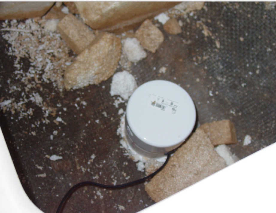

Feb 20, 2011
8,062
I like my Hawkeye D10D too. Great price, works well.
Encased in a short PVC tube. Shoots through the hull in a bed of toilet wax.
