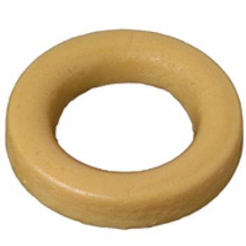

What the hell is Toilet Bowl Wax ??
LOL
Just like Turtle wax... Wax on. Wax off.
No... It is the wax seal between the toilet and the pipe in the floor.
Use a new one. You can soften it in the sun and hand mold it. Then just press it into the wax ware you want it on the hull. Or melt it in the microwave. If you melt it build a well around ware you want the transducer and pour it in . Set the transducer in ASAP and hold it in place until the wax hardens.
Pour slowly! No bubbles or no work.
