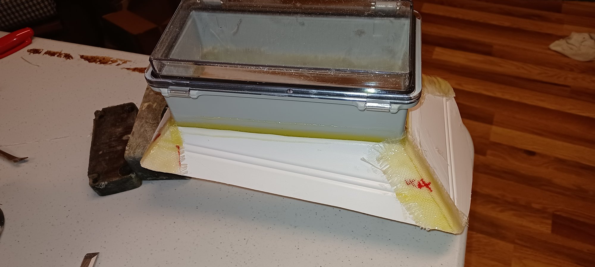

I am in the process of installing my third "In the hull" transducer. I have been using the technique for about 30 years. I do not like the mess of wax rings and the "one shot to get it perfect or else" aspect of silicone. I always mount mine in a box. The first two times I did it, the transducers were small so I cut a 4"ø ABS cleanout port to fit the slope and epoxied it to the hull. The transducer is mounted to the cap and the base is filled with polypropylene antifreeze. test the location by setting the transducer on a Ziplock baggy filled with water. I used the baggy all last summer because I didn't have the time to build and mount a box for my SideVu transducer which is about 6" long.
My new box is made from a waterproof electrical box. I cut out the bottom and used G-flex epoxy to bond on PVC boards angled out at 45º to get the proper coverage for the SideVu. I have the basic shape fitted to the hull and the bits put together but need to get a full cure so that I can sand it to get rid of the FG fish hooks and a coat of paint before I bond it to the hull with more G-flex.
Is there liquid in the fiberglass bottom part? The part that is bonded to the hull…

yes. I will bond the bottom to the "V" of the bow below my V-berth and the transducer is mounded inside the box with the wire coming out the clear top with a gromet to seal it. The box is then filled with Pet-safe Peak Sierra polypropene antifreeze to make the air-free contact with the hull. It works the same way as the mineral oil in the first video you posted but is not oily, non-toxic and can be cleaned up with water.
The extensions to the box are there to give enough depth to mount the transducer and it is flared out at 45º because it is a SideVu transducer that has a wide beam to look to each side of the boat as well as below it.
