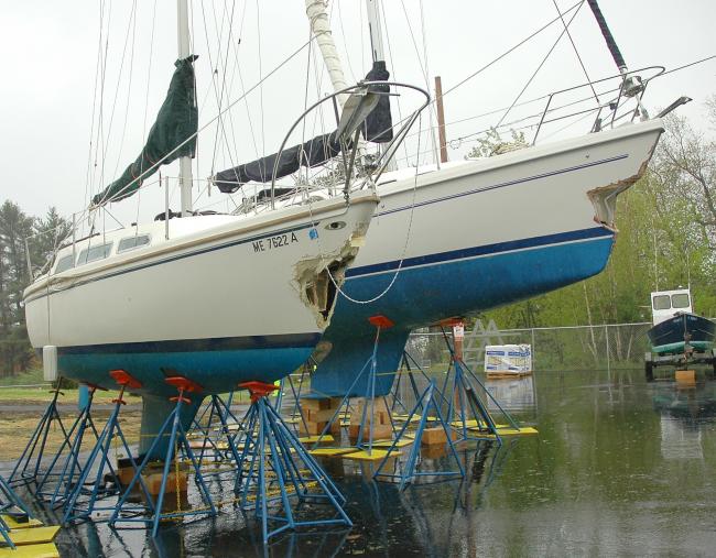

On the hard is my vote..
but with the stick DOWN... Don't do docks they can do this...

I agree, the hard is where they are the least likely to get damaged. BUT, the hard must be above the expected water rise which, in our area of South Louisiana, is pretty tough to find. They also should not be left on poppets but rather laid carefully on one side. I saw this applied successfully in Corpus Christi back in the early 70’s. My boat is about 20 miles west of the marina that Nice N Easy is referencing.. Boat stayed in slip on a bayou for Katrina, but I fully expected that it would be gone when I returned. After much careful pre-storm line tying, the only damage I had was loss of the upper port lifeline where the boat had gone considerably above the tall pilings and hooked the lifeline on the way back down. I was very lucky!
