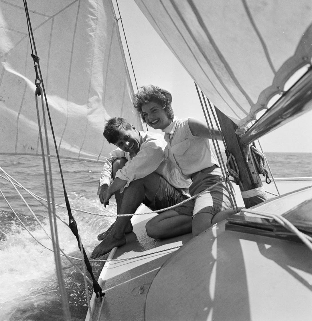

I seem to remember the phrase... Gentlemen don't sail to windward...
Not sure of the author but this image appeared as I was looking for the author..
DArcy
Feb 11, 2017
1,788
Islander Freeport 36 Ottawa

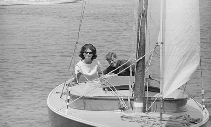

It's interesting that the Kennedys were fairly wealthy but they kept sailing the little Victura. Must have been a great boat.
Victura has an interesting jib sheet arrangement which you can see in this photo. There is a short strop attached to the clew with an eye that the sheet runs through. The sheet is lead from a deck fitting through the eye, back to what looks like a cam cleat on the cabin top.
