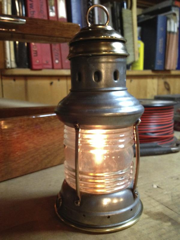

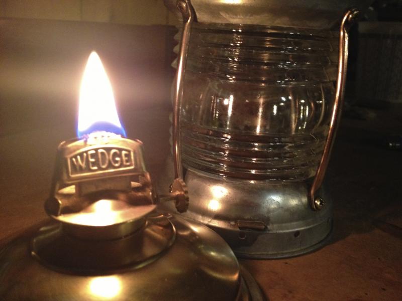

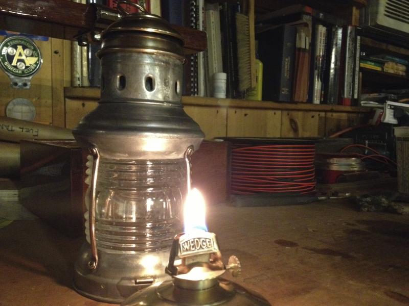

Or a more vintage solution. Given to me by a good friend. Cleaned up well. Lasts about 9-10 hours on one fill of lantern oil. It's specifically an anchor light and is wind and waterproof.

I thought it was pretty cool myself. The body is galvanized and the tank and trim is brass. Looks pretty neat cleaned up. I have a 95watt solar panel and led anchor light, but I can see the vintage model getting some use.
