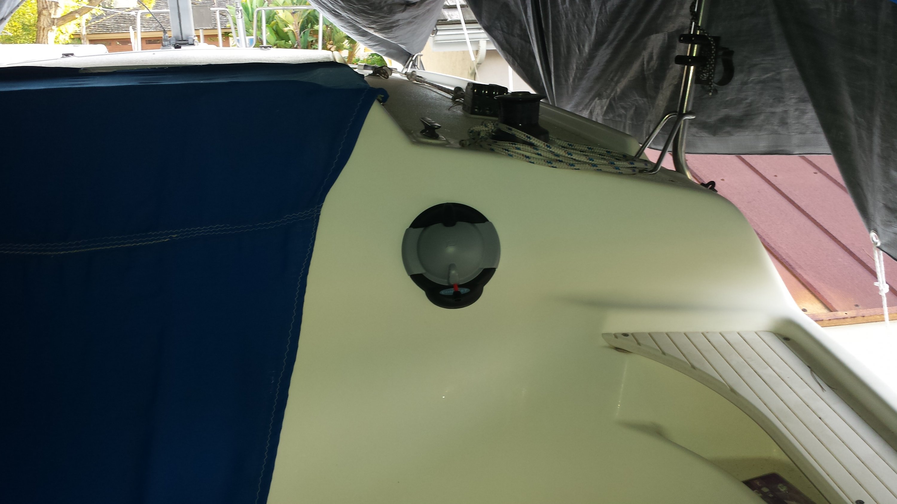

I added a new Plastimo Contest 101 compass. I like this one because you can see the compass from inside the cabin.

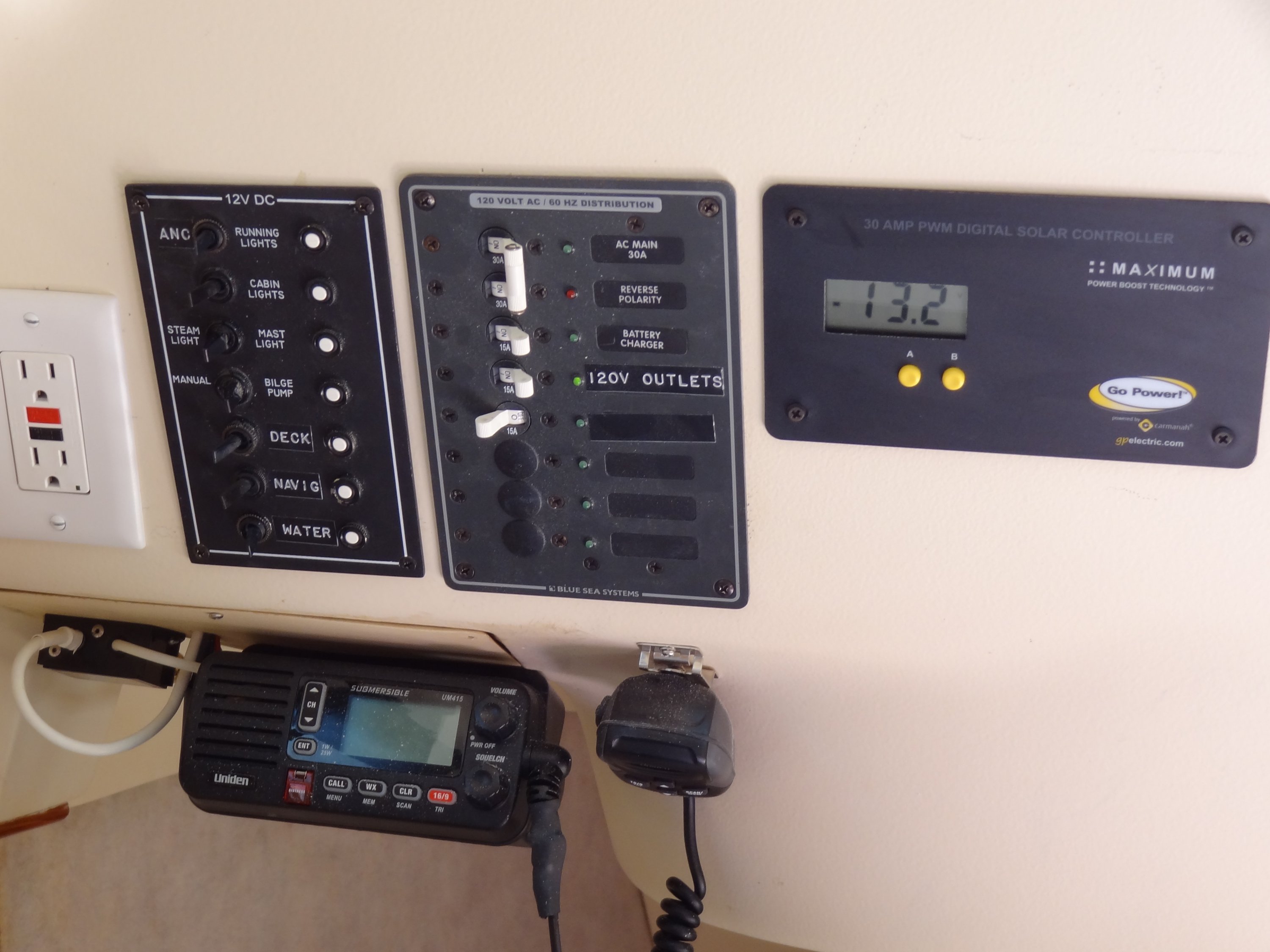

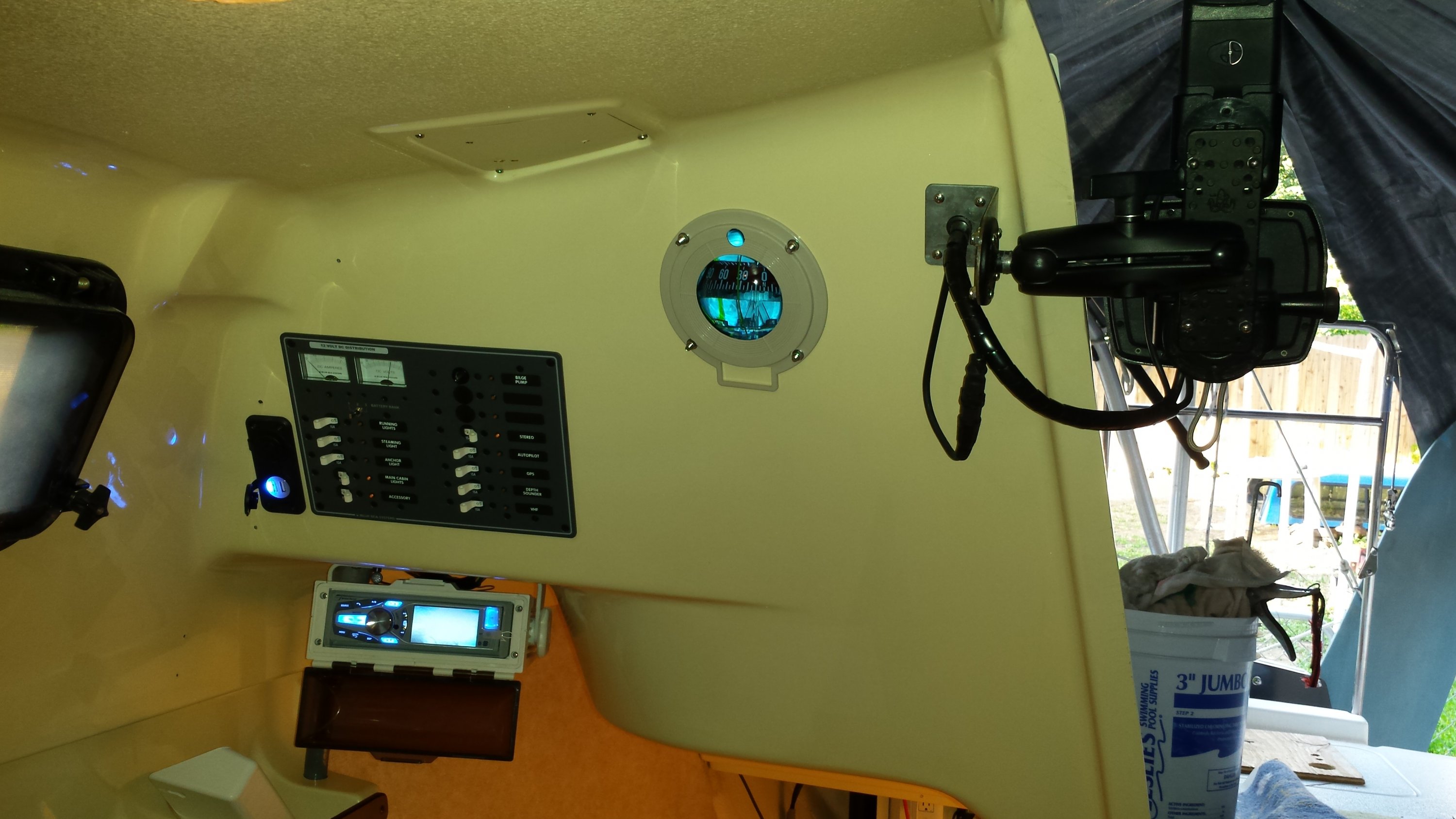

Here you can see the compass inside the cabin. I upgraded the DC switch panel with a Blue Sea 13 position circuit breaker panel, that has voltage and amp meters. There is also a dual 12V/USB outlet, a new West Marine Stereo, Garmin GPS and FishFinder on a RAM mount.

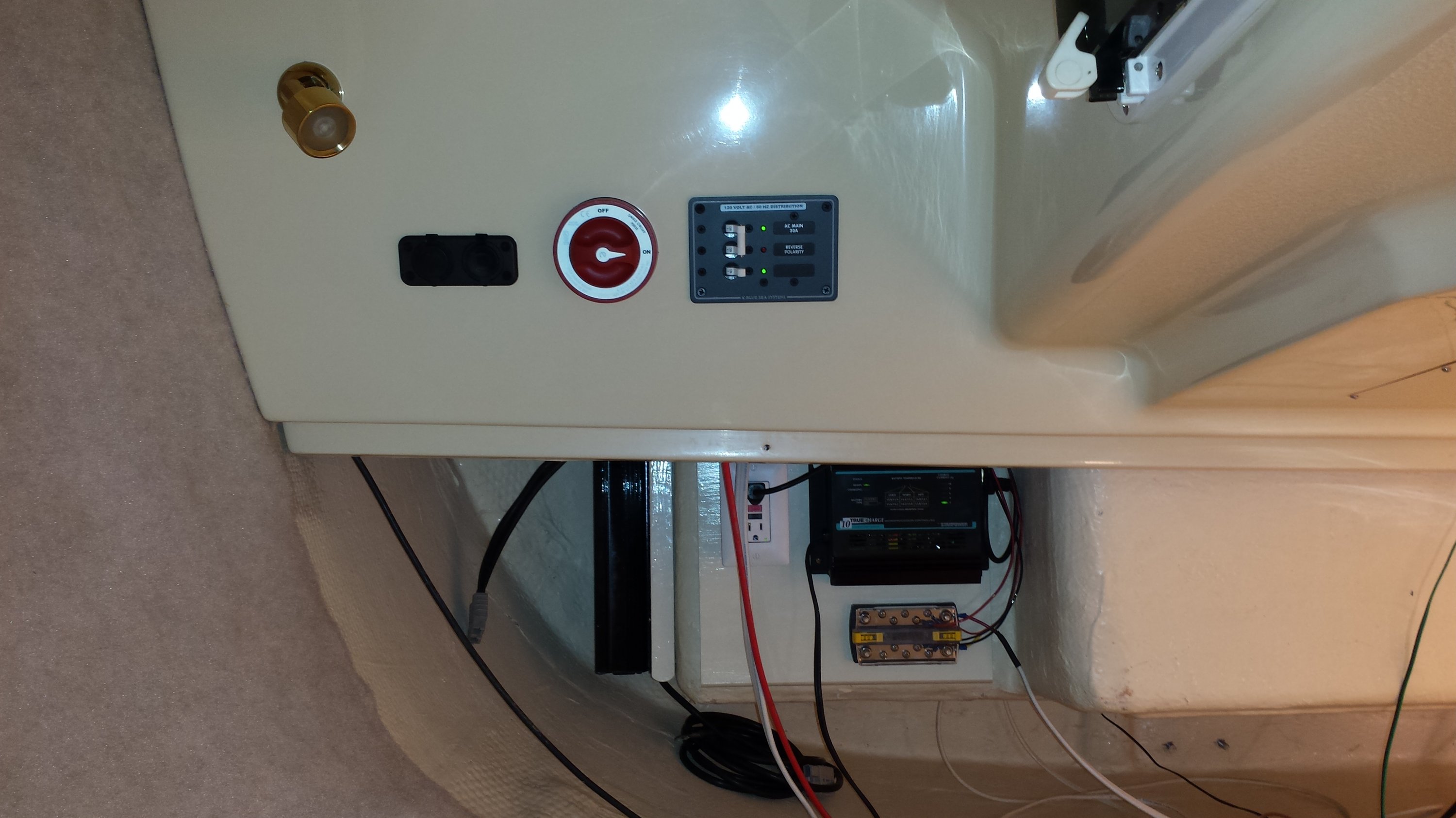

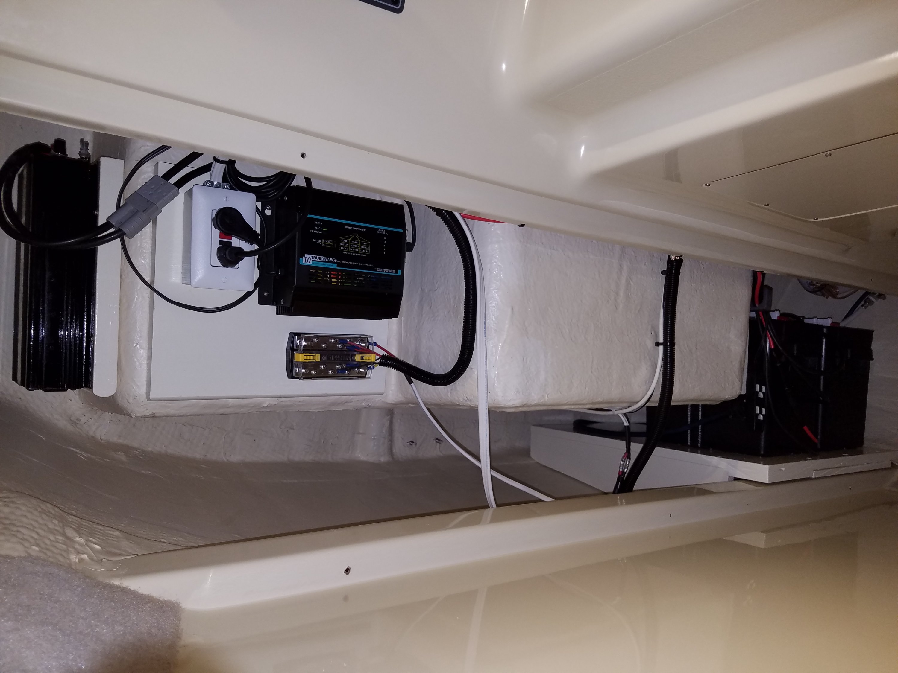

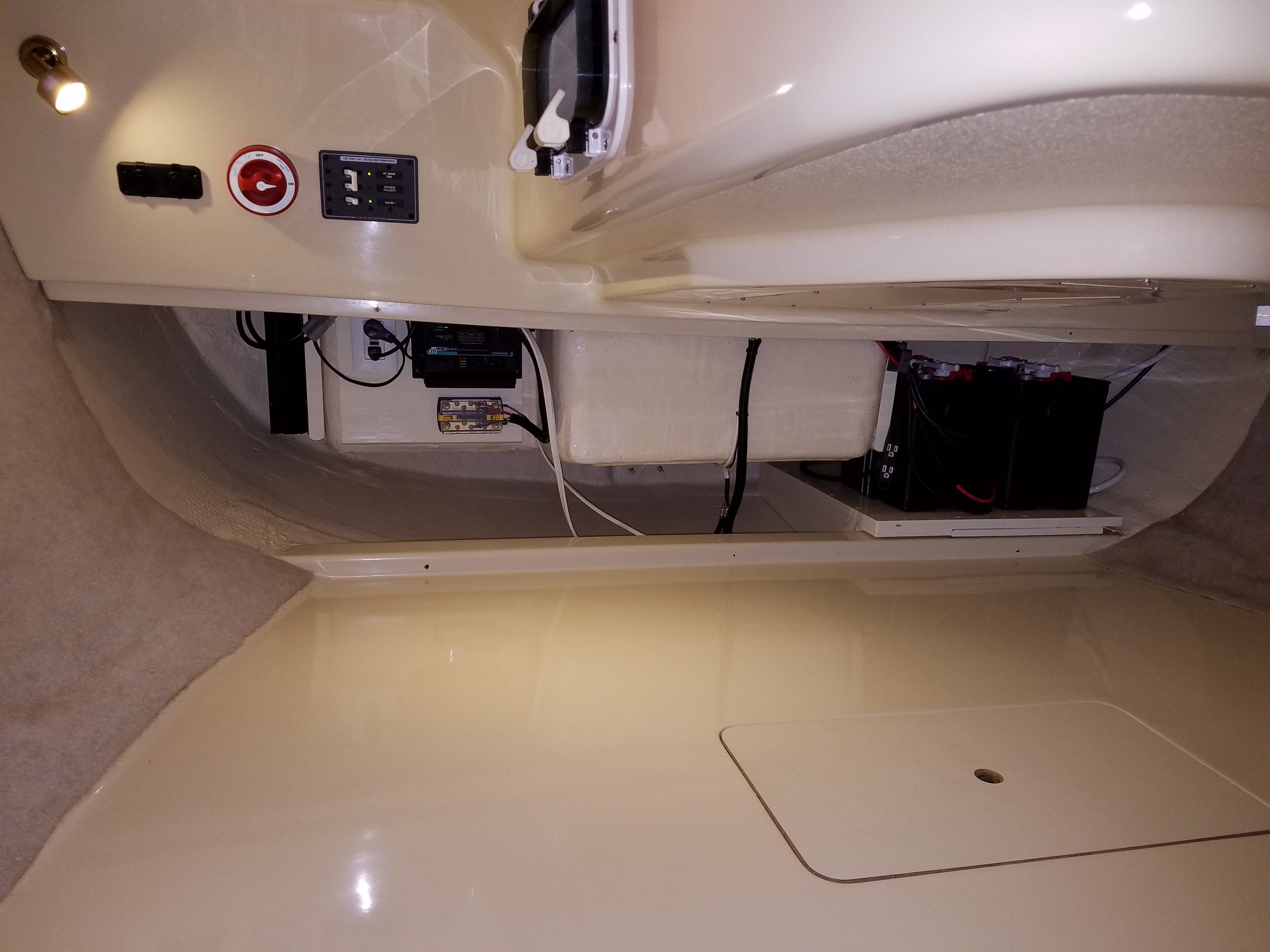

In the aft berth I installed an AC shore power circuit breaker with a separate breaker for AC outlets, DC on/off switch, 12V/USB outlets and an LED reading light. Below you can see a battery charger, AC outlet, an 1800watt inverter and a DC bus bar.

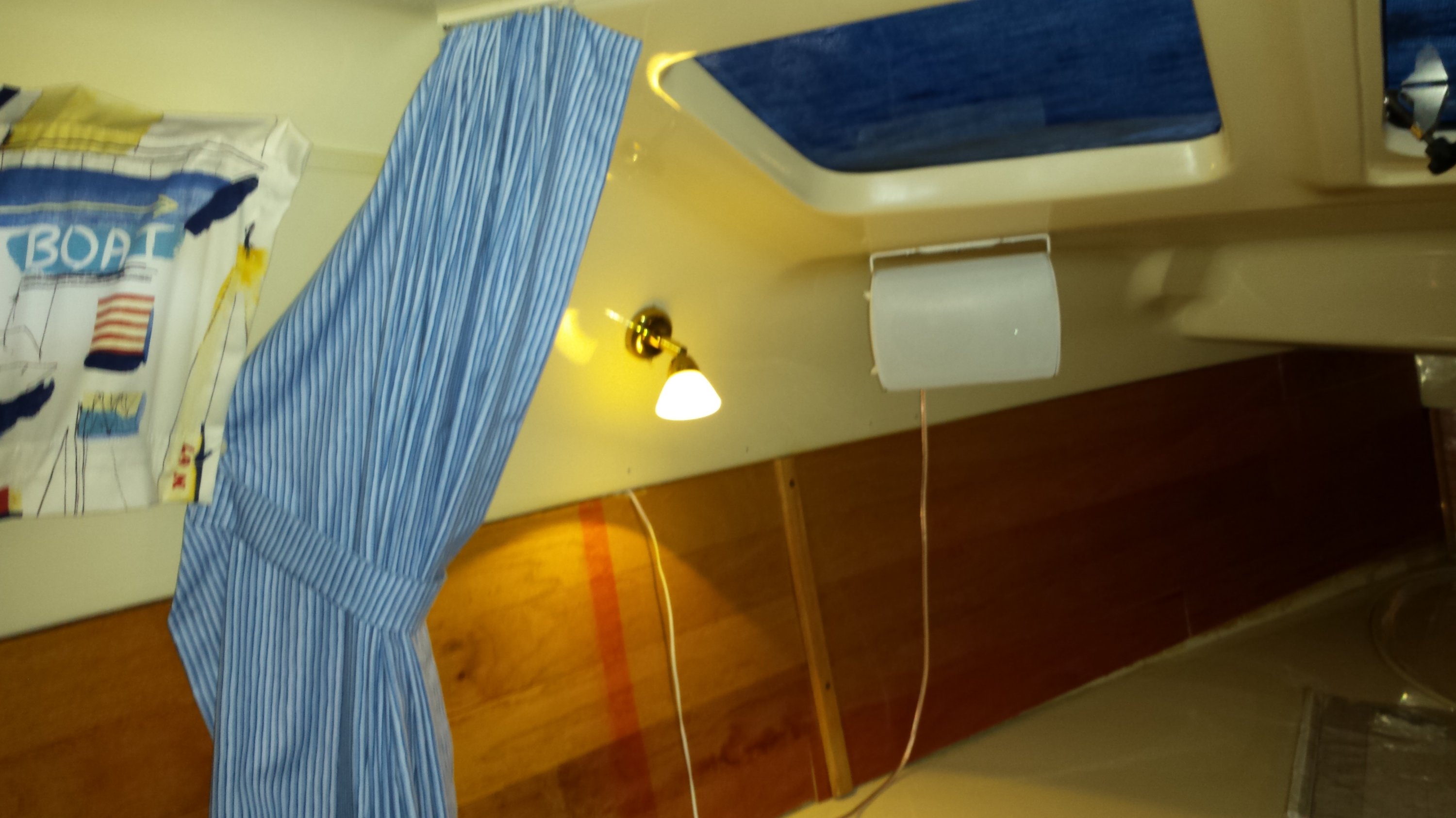

Here you can see one of two LED reading lights (port & starboard) and the new stereo speakers. The wires will be hidden behind the wood paneling I intend to replace.

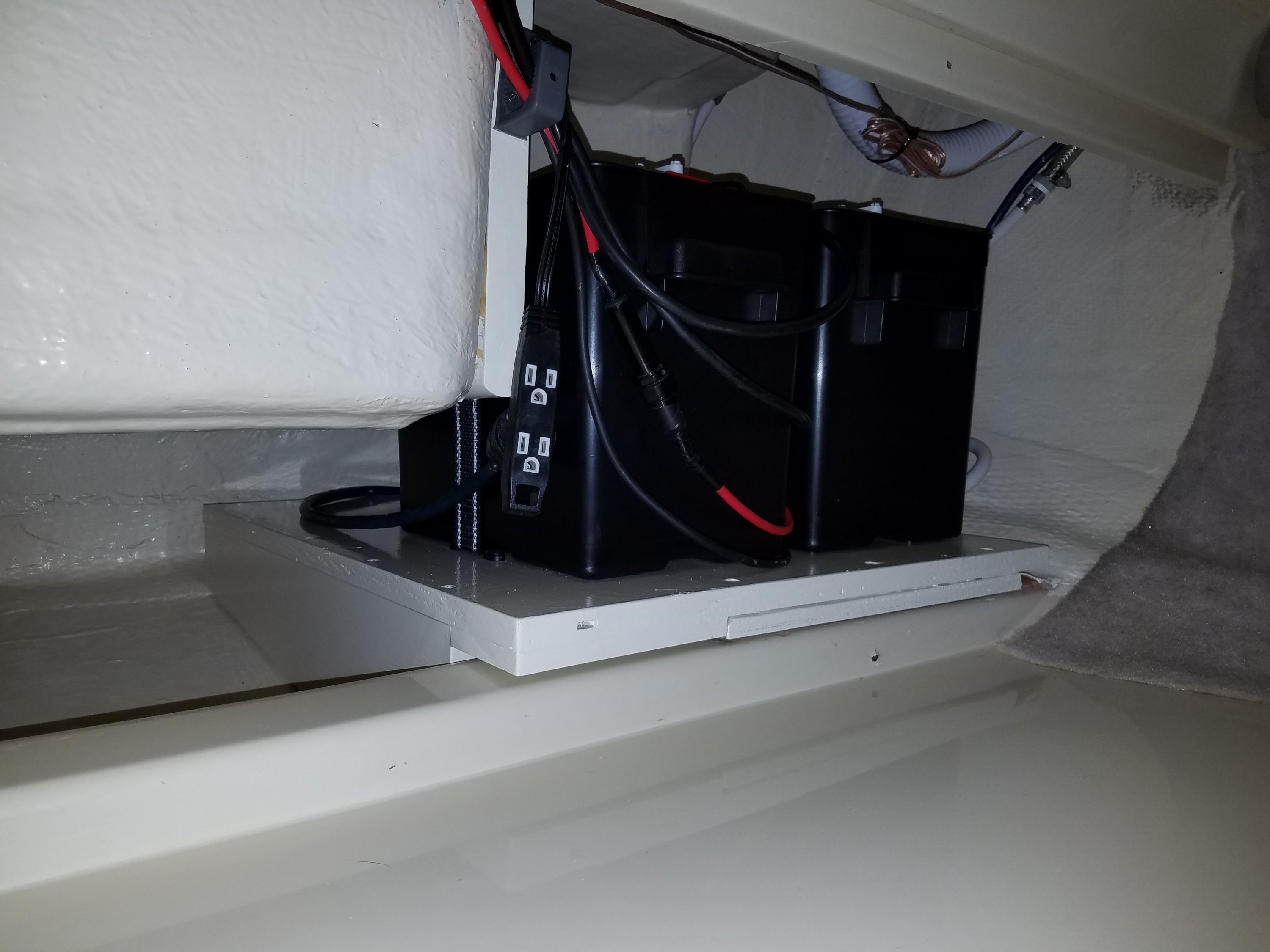

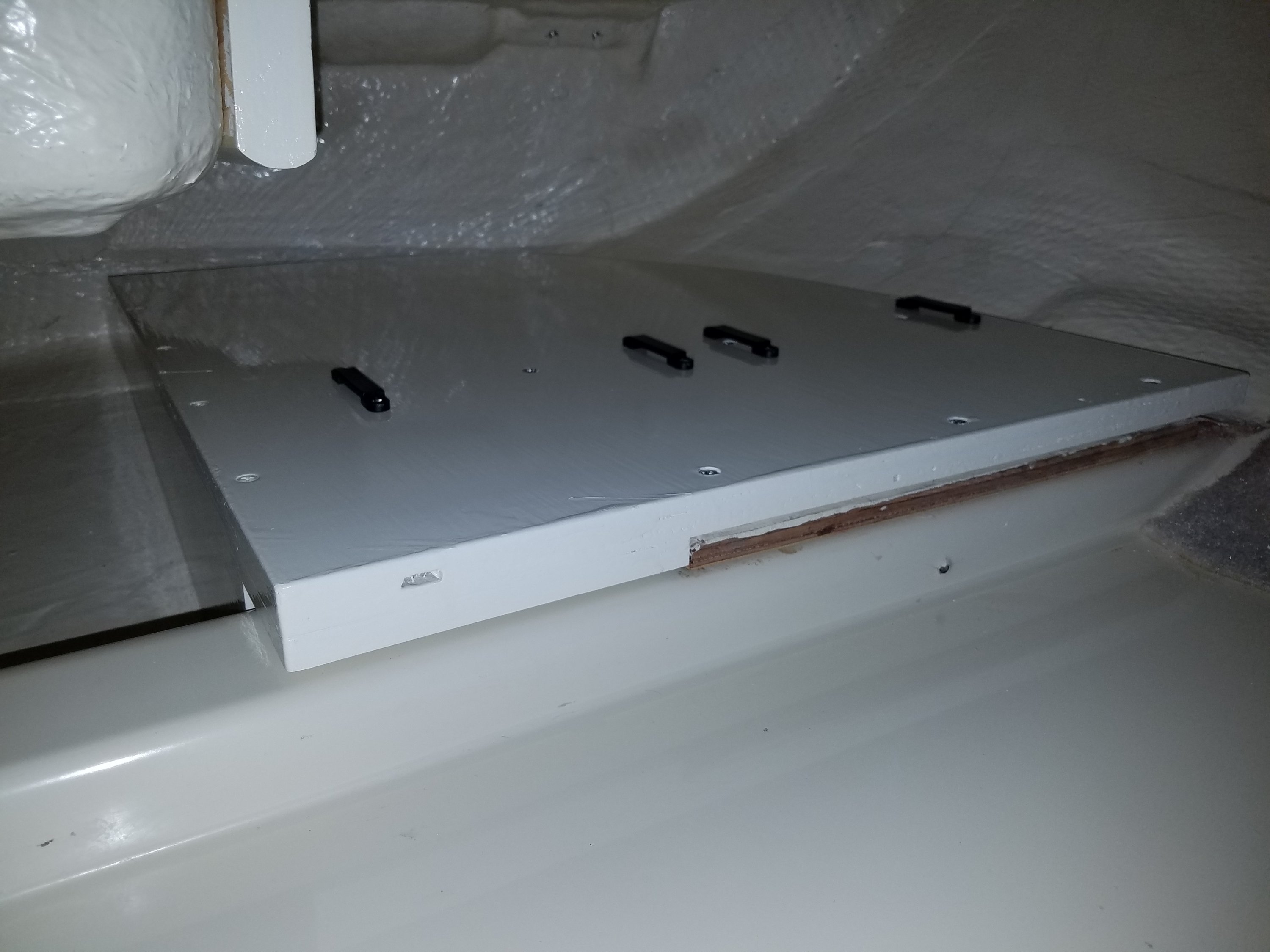

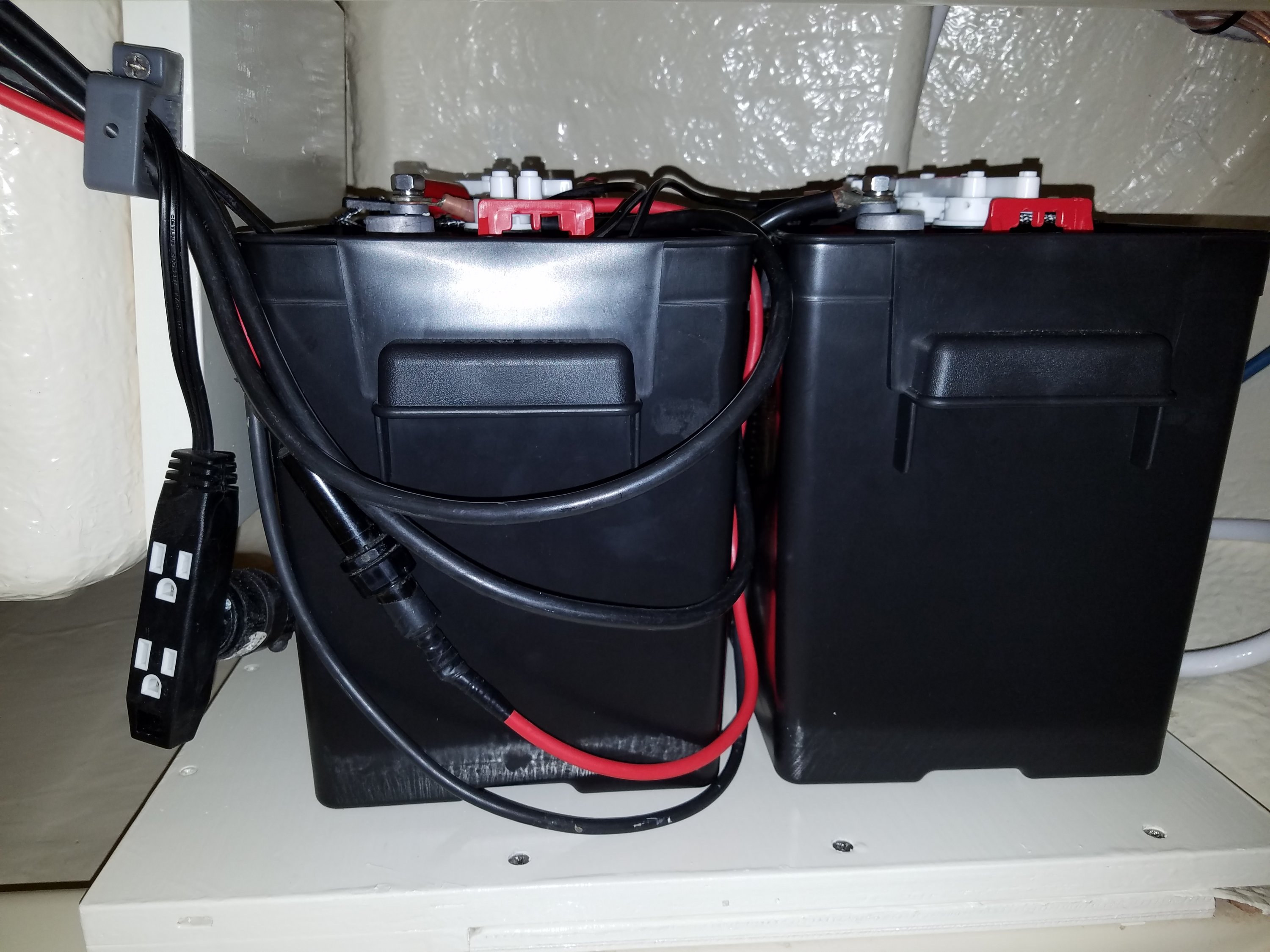

Work is ongoing. I purchased two 6 volt golf cart batteries for my battery bank. I will need to fabricate a new battery mount platform, clean up the hanging wires, connect my AH, etc.
