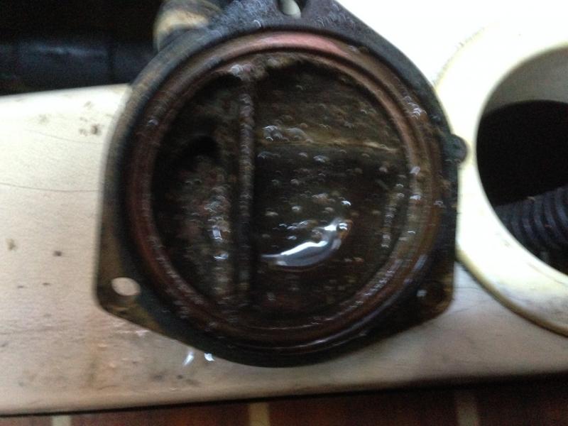

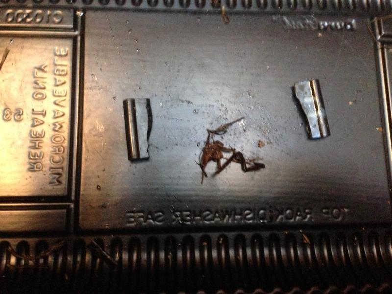

Well I went to check my Yanmar recently and checked my 2 belts and changed the water pump belt after finding a kind of cut on it and while checking the impeller found one of the vanes missing and after just coming back from cruising
for about 3 weeks with much motoring and will check everything more before
going on one of our longer cruises and the motor did run great.

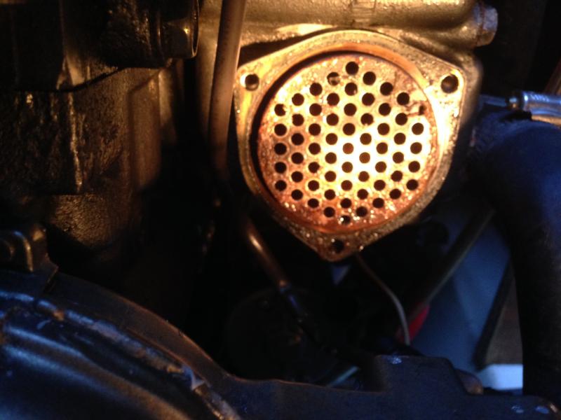

After finding the vane gone i decided to take the heat exchanger on my 2007
3YM30 and found 2 vanes in the front part of the heat exchanger and also some
sea grass but all good now.

My H-36 came from the factory with the clam shell for the engine thru hull and
this was the first time I took a look inside the heat exchanger since boat was new in 2007 and thought it looked pretty good for sure.

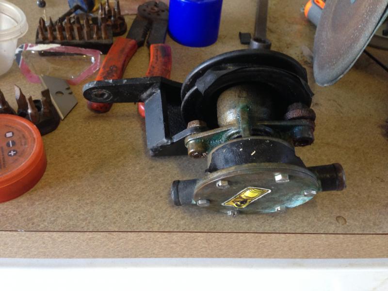

I did rebuild the sea water pump about a year ago after it started leaking
and causing rust on the bracket and motor mount but have wire brushed it and repainted it

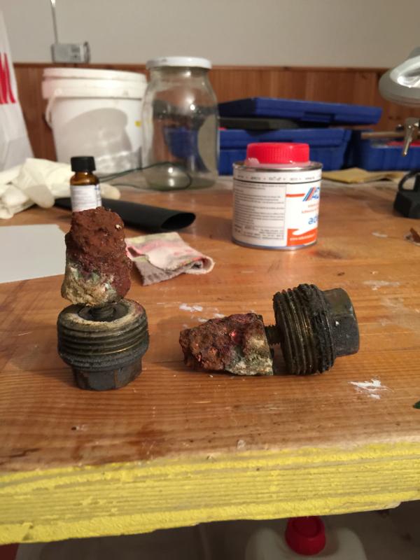

I would also recommend, to control the zinc sacrificial, I decided to do a restore of the engine, and I also replaced the exhaust smoke but my water and very old. The impeller to change every year, if it does not turn sea water, before the engine warms up, it burns the muffler, because it is not soft dim the temperature of the exhaust smoke, and there is the danger of fire.

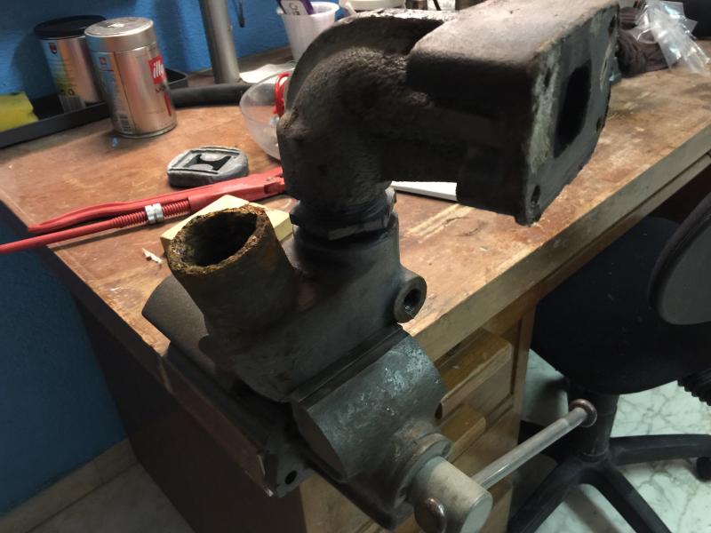

Sorry for my English I think this is best to understand me.
The Council controls the anti corrosive zinc, i made the restoration of the engine, and I found the broken elbow mixing. The impeller to change every year, but it depends on how many hours the engine are made, if the impeller breaks, before damaging the engine burns the muffler, exhaust smoke is not cooled by sea water, the danger is a fire.
To find out if the impeller broke, i put a temperature sensor 85 degrees with a alarm on the muffler

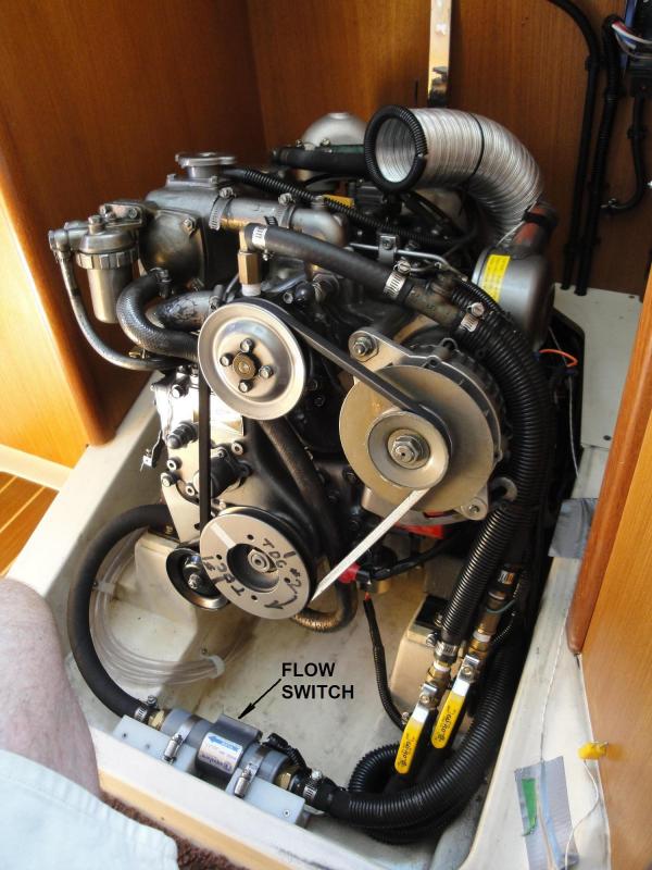

WOW. You could eat lunch in that engine compartment! Nice Ralph
Who makes that flow switch?
Check the attached literature for flow switch specs. I believe it was about $70.00 when I bought it 8 years back.
As for the engine compartment ................ it has to be that clean. That's where I hide my lunch. Bloody crew would have it eaten within minutes if I left it lying around :eek:.

Ralph, that is a brilliant idea, flow switch. I assume it is attached to some kind of alarm? I did not see any literature attached, I would be interested in doing this to my Yanmar 2gm. What kind of switch did you use?

No Attachments ? ? ? ? ...................
Had another enquiry complaining about not being able to see the .PDF attachment so maybe it's common problem. If you can't see the previous .PDF attachments, please see this site:
http://aqualarm.net/cooling-water-flow-c-2/
for Aquaflow products.
I see they've changed their technology from a magnetic slug on a guide rail being moved by the water flow against a spring ........... to a flow paddle which has a pivot point. This is the same as used in industrial flow detectors so if anything, it's better than what I have and it's $5.00 bloody dollars less than what I paid eight years ago :eek:.
The alarm can be wired through the same alarm as the low oil pressure alarm. I went a little more exotic and wired it through a different sounding alarm (physically the same alarm but on a different audible output) just so I can audibly check both alarms on engine startup. They both sound until I have both oil pressure and water flow.
With their expanded selection, for a Yanmar 2GM20F, you'd want the 10235 Cooling Water Flow Detector.
I hope this helps.

Flow Rate Requirement
Mine is a straight 2gm with raw sea water cooling, there is no fresh water component. Would your recommendation be the same?
Not familiar with how much sea water your engine would pass.
Best to try a test measuring the raw water pump intake from a bucket and compare to Aqualarm's required 3-4 gpm flow rate for their 10235 detector.
