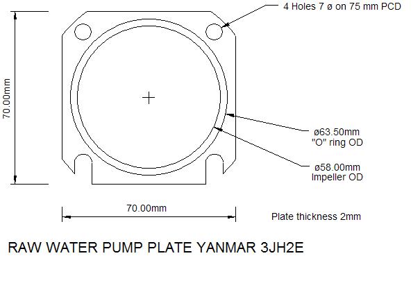

My 3JH2E Impeller Experience
On my H376 I only needed to undo the 2 alternator bolts and move it forward without undoing the wire connections.
Then I removed the 4 off M6 screws from the pump cover and prized out the impeller using 2 small screwdrivers.
I then modified the pump plate with a file as per the diagram below so the 2 lower bolts remain in place and guide the plate back in to place (All before the days of "SpeedSeal"). I should have replaced the screws with allen heads but didn't bother.
All this to make life easier for next time.
