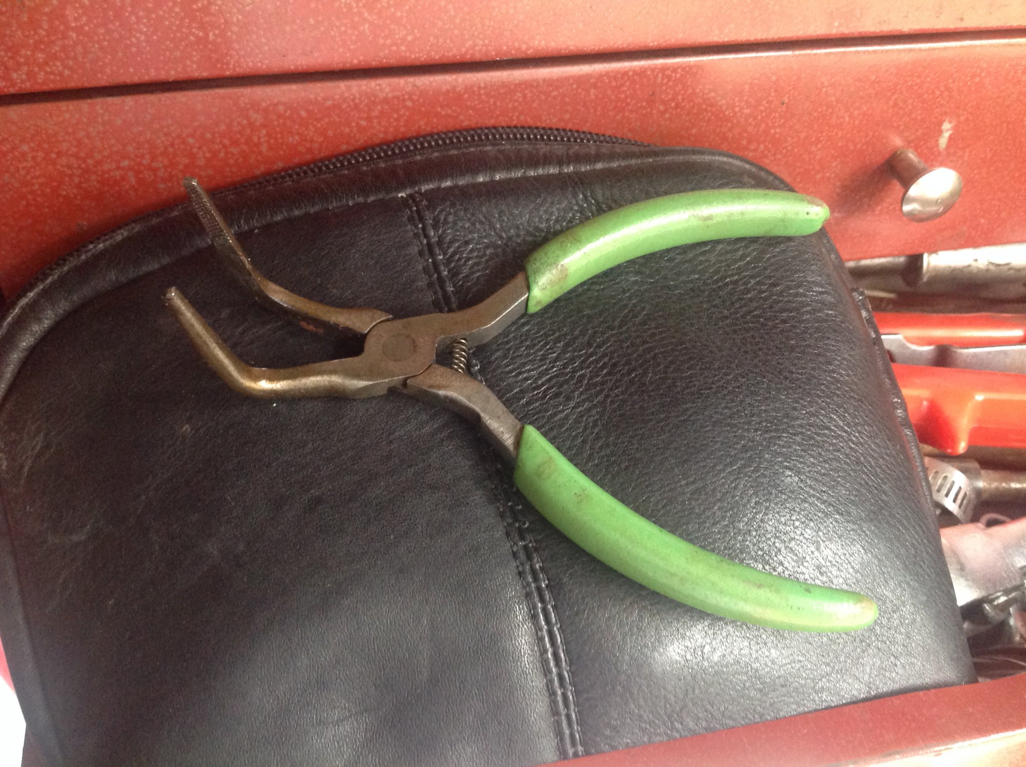

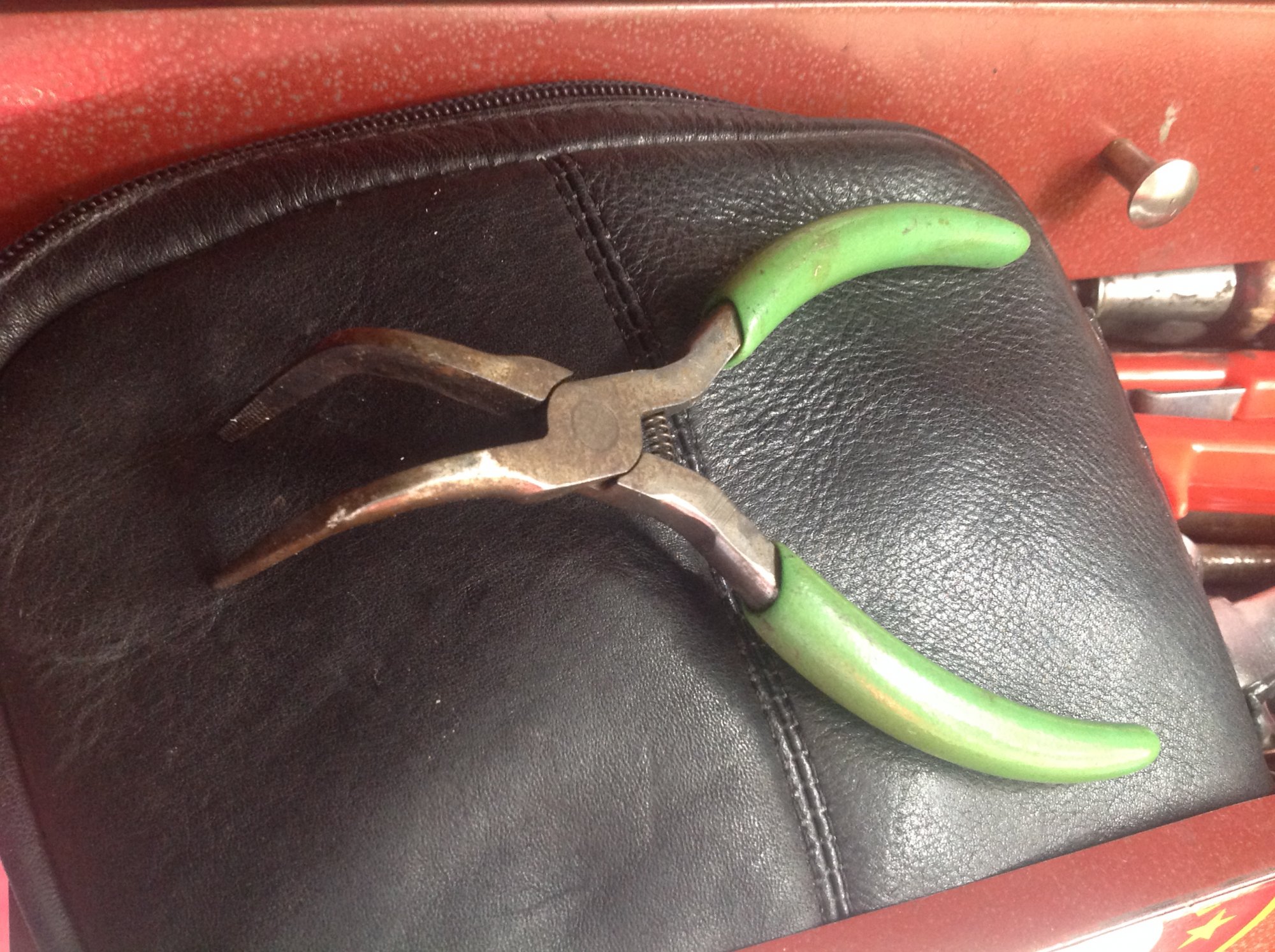

I use a pair of Bent Nose Pliers (right angle as "all you get" suggests). Mine have a 1 1/2 " reach. These can be use in both directions, with a little ambidextrous hand motion. To remove my impeller I push the tips against the inner sides of the impeller and pull up. It spans the iner bar across the diameter and once up I grab the bar and pull up until it's out.
There in there pretty tight so it does take a little effort but with this tool you'll be done real fast.
It's also perfect for my Mercury 3.5 Outboard. If you remove the lower gear housing to replace the impeller in there, it's next to impossible to get your fingers inside the 1 1/2 inch grommet hole to hold the two halves of the linkage connector and hold a ratchet and tighten the bolt.
It has a good heavy duty spring which helps too.
Hope this helps.
