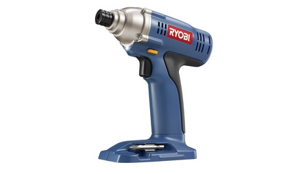

For the actual extraction of small fasteners, I have had good luck with a Ryobi 18V impact driver like the one pictured. It hammers rotational impacts and it can be controlled for speed.
For larger fasteners I have a Dewalt 1/2" drive electric impact wrench. I use this for shock absorber and chassis work. It is worth it's weight in gold!
