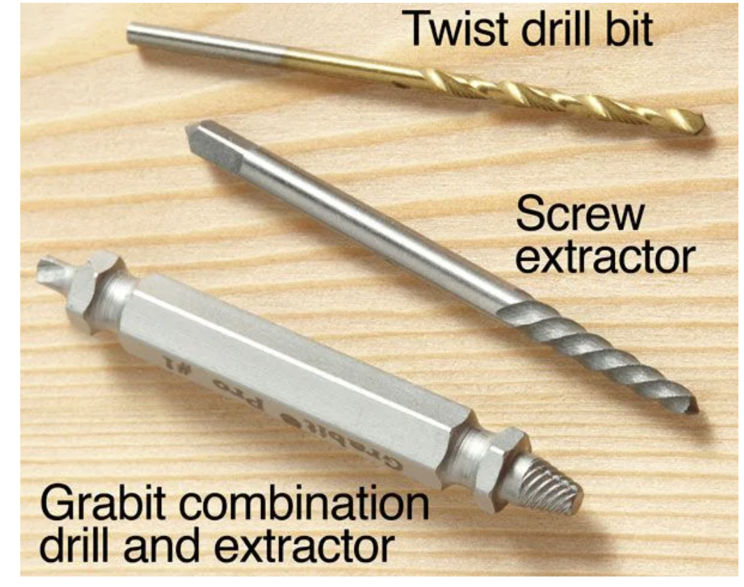

I have used a drill, using the adjustable screw tension feature. It acts like a weak impact driver. Reduced power and lees chance to strip the screw head. Yet that has happened. Then you need to resort to a drill and a tool like this,

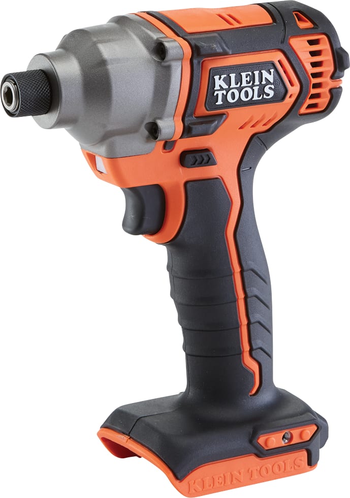

If you are using an impact driver, I don’t think you will do damage to the boat (the screw heads may get worse though).

I have found that an impact driver will do less damage to the screws than will a hand screw driver or drill. As for any damage to the fiberglass house, the impact driver only impacts on the rotational force being applied so it would not affect the fiberglass at all.
