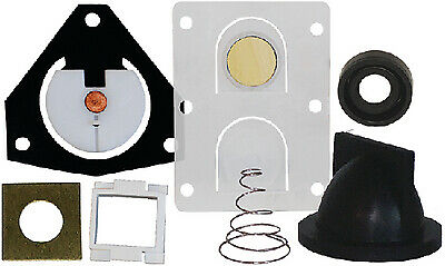

I'm tired of Groco repair kits $$$$ Are you?

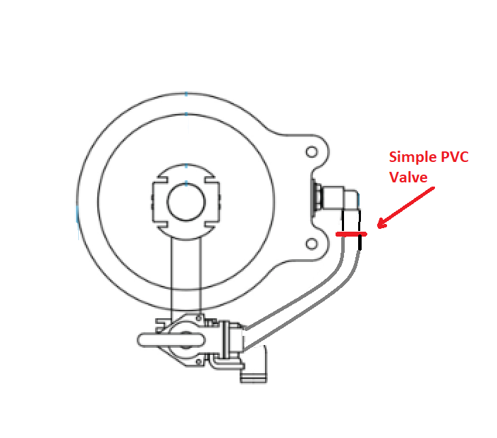

No matter what I do my Groco system fails to stop raw water from filling the bowl with raw-water only to resort to shutting the seacock after usage. Or, just maybe I don't know how a system like this works...LOL Anyway, I have solved the problem and works for me and others too. I have taken the output of the Groco pump leading to the bowl that fills the bowl to flush and installed a simple PVC Open/Close valve so after your done flushing close the valve. No need to close the seacock and no more BUYING KITS! I have used this the last two seasons and IT WORKS! I have saved hundreds of dollars already. Capt. Rob

Peggie claims that if you insist on keeping the Groco, the smart money is to just buy a complete pump.

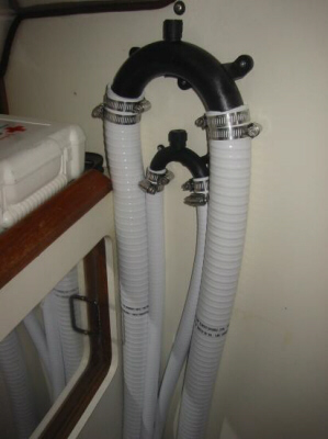

Stu nailed the problem...but believe or not there's no mention of a vented loop in the intake in the Groco HF installation instructions. But it's in the installation instructions for every other manual toilet...see the drawing on p.3 of the Jabsco manual toilet owners manual Jabsco Manual Twist & Lock owners manual ...Figure 2 on p. 5 in the Raritan PHII owners manual PH II Owner’s Manual ...and Figure 5 on page 5 of the Raritan PH SuperFlush (newest version of the PHII) Raritan SuperFlush Owners Manual As you'll see, it's in the same place in all of 'em: between the pump and the bowl (if installed between the thru-hull and the pump it interferes with the pump's ability to prime). It needs to be at least 6-8" above waterline AT MAX HEEL, not just when the boat's at rest..which puts it about 2-3' above the bowl on most sailboats. That requires replacing the short piece of hose that Groco used to connect the pump to the bowl with two lengths of 3/4" sanitation hose long enough to put the loop where it has to go (see attached photo for the most common location...the smaller loop is the intake...a discharge vented loop is only needed if you flush directly overboard when at sea beyond 3 miles).
But I wonder if you DO know how your toilet works...'cuz it already has a built-in "open/close" valve. At the bottom of your drawing, you'll see a little lever on side of the pump...that's the wet/dry control (aka "dry/flush" control on some toilets). It only allows flush water to come in when it's in the "wet" or "flush" position...blocks the flow of flush water when in the "dry" position. It can fail with age, but since you didn't mention that water comes in no matter which position it's in, I doubt that's the problem. It is NOT a substitute for the vented loop because people can accidentally leave it in the wet mode, but it does prevent water from filling up the bowl while it's in the dry mode.

Thanks, Peggie and yes I do know how the pump works, however, all that I've read on do this do that, was just eating up my time to enjoy boating. I have installed the two loops that you have but can't take them high enough in the space allowed. I do not want loops of hoses climbing up my headwalls. I've tried it all and this is the only thing that guarantees it won't fill the bowl regardless as to any sailing conditions. After putting in a new pump and it failed too within 2 weeks. flip the lever up and flush it down, flip it down and empty the bowl. close the lid and shut the new valve, DONE! You don't have to worry about what position the lever is in, vent hoses and where do I put them, and in some boats, they are in plain view. IMO.

This is my installation to date. above water level. In the current condition with it being brand new... It leaks raw water into the bowl.

You can't run the toilet intake line straight up behind the toilet to put it on the bulkhead behind the toilet as shown in the photo I posted in my previous reply???

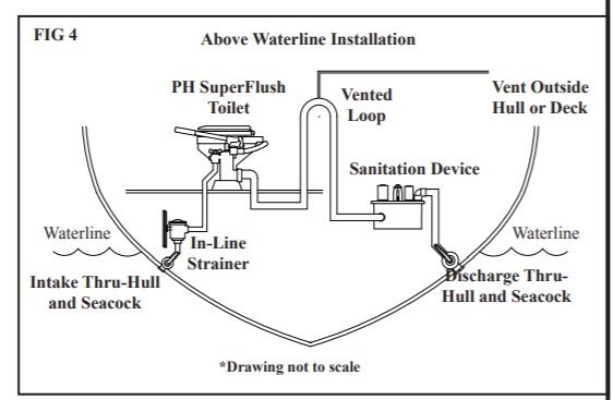

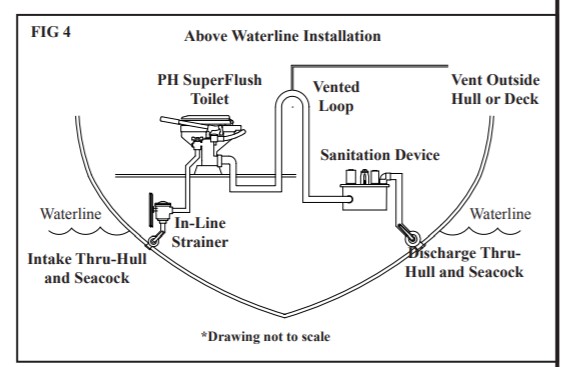

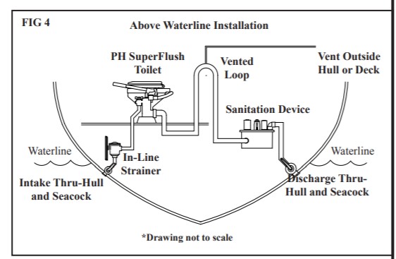

Peggie thanks for the info. However, mine is installed above the waterline.. does the loop still apply?? see Fig 4 drawing as a referance. Thanks, Capt. Rob
Dec 2, 1997
9,011
- - LIttle Rock
As long as it's installed entirely above waterline and remains entirely above waterline even at max heel, no. But there's no way it could be entirely above waterline even at max heel if sea water was flooding your bowl when the intake seacock was open.

It'll be easy to do and work just fine if you install it between the pump and the bowl and high enough directly above the toilet. Be sure to get an air valve for it...it's a li'l doodad that threads into the nipple on the top of the loop...needed to prevent any squirting.
