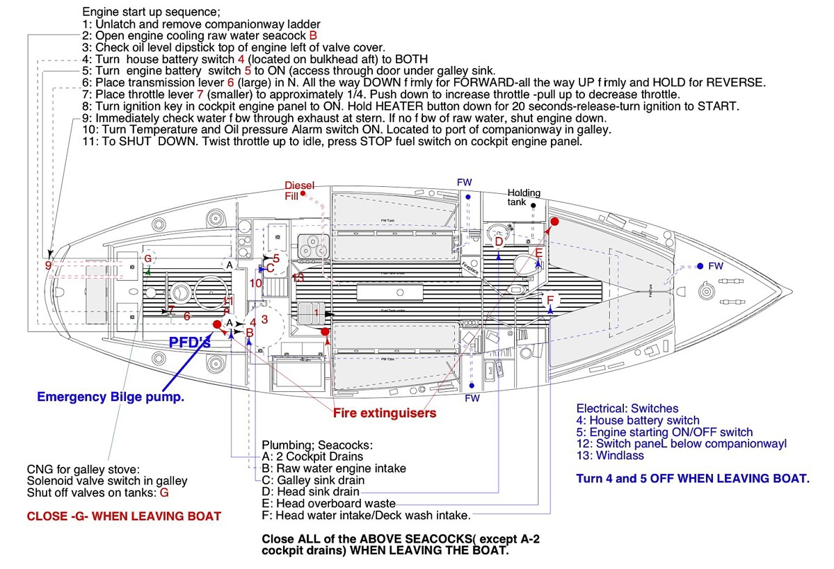

As simple in systems Christmas is, it's complicated enough that I don't think someone could come on board and operate the boat without a lot of searching. I realize even my family would have trouble so I thought I'd put something together that I could go over with them, kids now fully grown. And although it's not the norm, there could be the time someone from the local yard needs to move the boat. My target is someone who knows what a raw water seacock or battery switch is but they need to search them out, maybe in a hurry. Also, I want a simple Quick Guide, not a manual, that I know even my son or daughter may use to go on board and off and leave the boat safely. My goal is to have them go out this season alone and bring the boat into the docks.
Once I have something suitable, I'll laminate it and mount it somewhere visible and loose. Details are endless so I'm leaving most out or may use the back for important notes. Does anyone have a better system of doing this? Advice welcome
