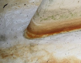

A common place for cracks is the forward joining between centerboard trunk and hull because of the stress put on that area by rattling centerboard and the lateral strain against the pivot pin when under sail. If you have made contact with the bottom, that too can lead to a break. The damage may be most visible inside the trunk, but you are likely to see it at the bilge.
Here's a couple of pictures I found on the Internet to illustrate.
