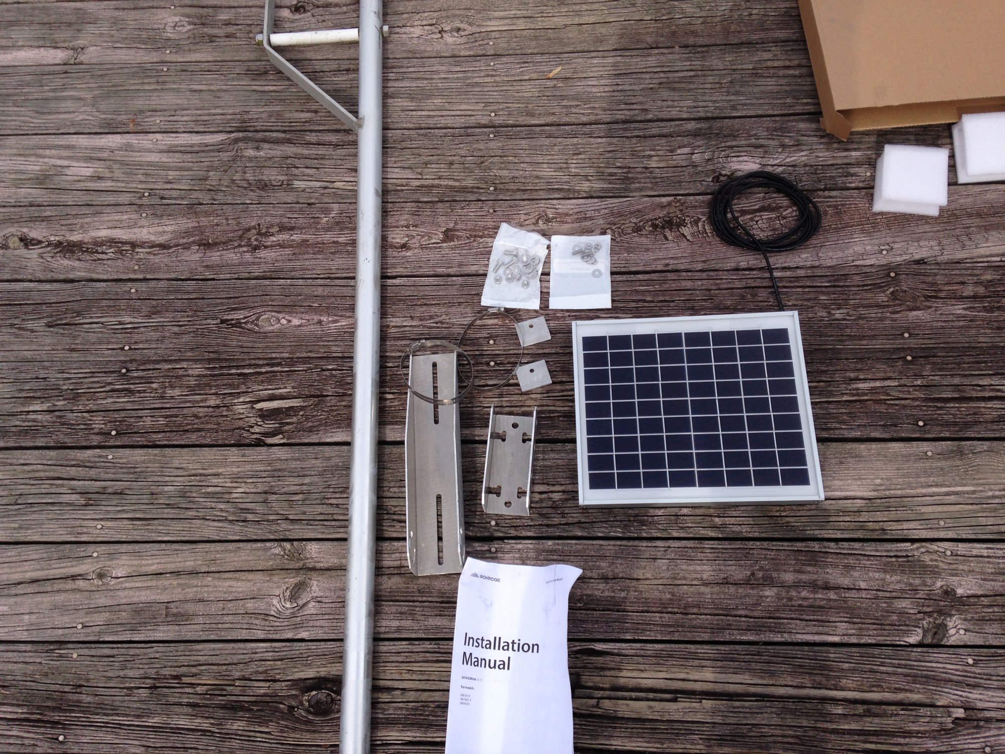

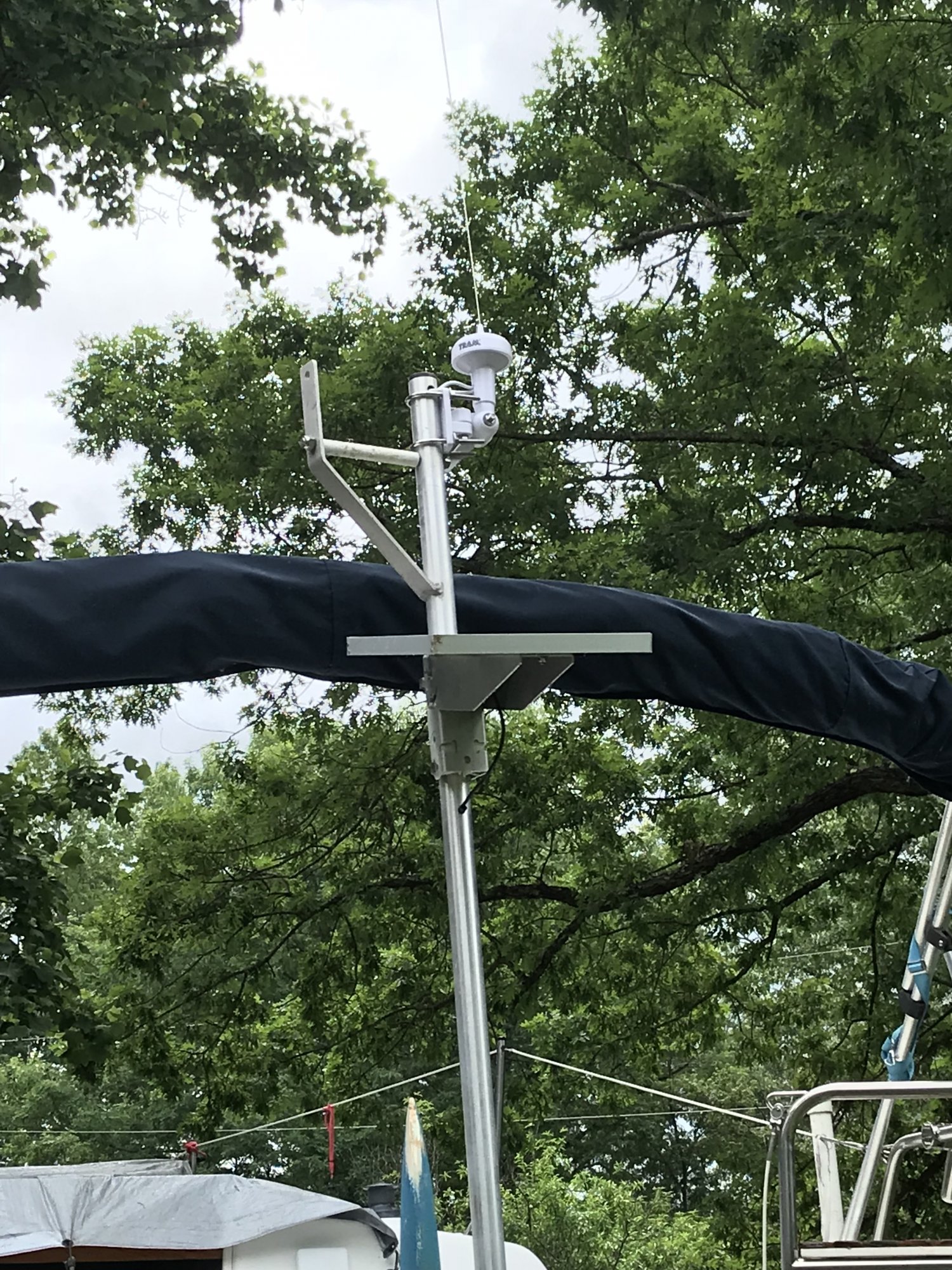

I mounted mine on the mast crutch pole.... and then just left it installed all the time. I also have my GPS and VHF ant. there (see pics)

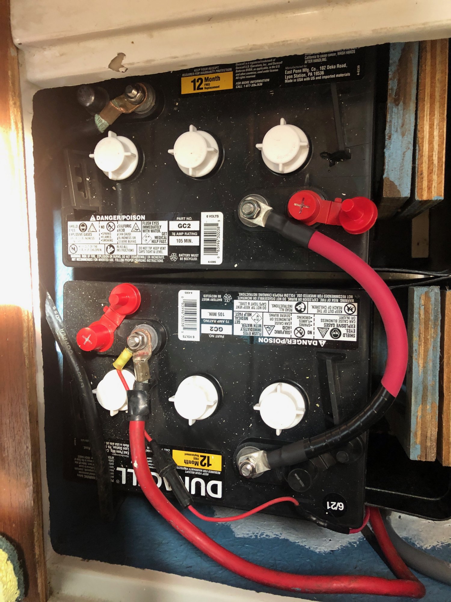

I used to use 2 group 27 deep cycle batteries, and I would isolate one of the batteries during overnight stays so I always had juice to start the engine.
This year, I upgraded to 2) 215 ah 6-volt GC batteries in series.

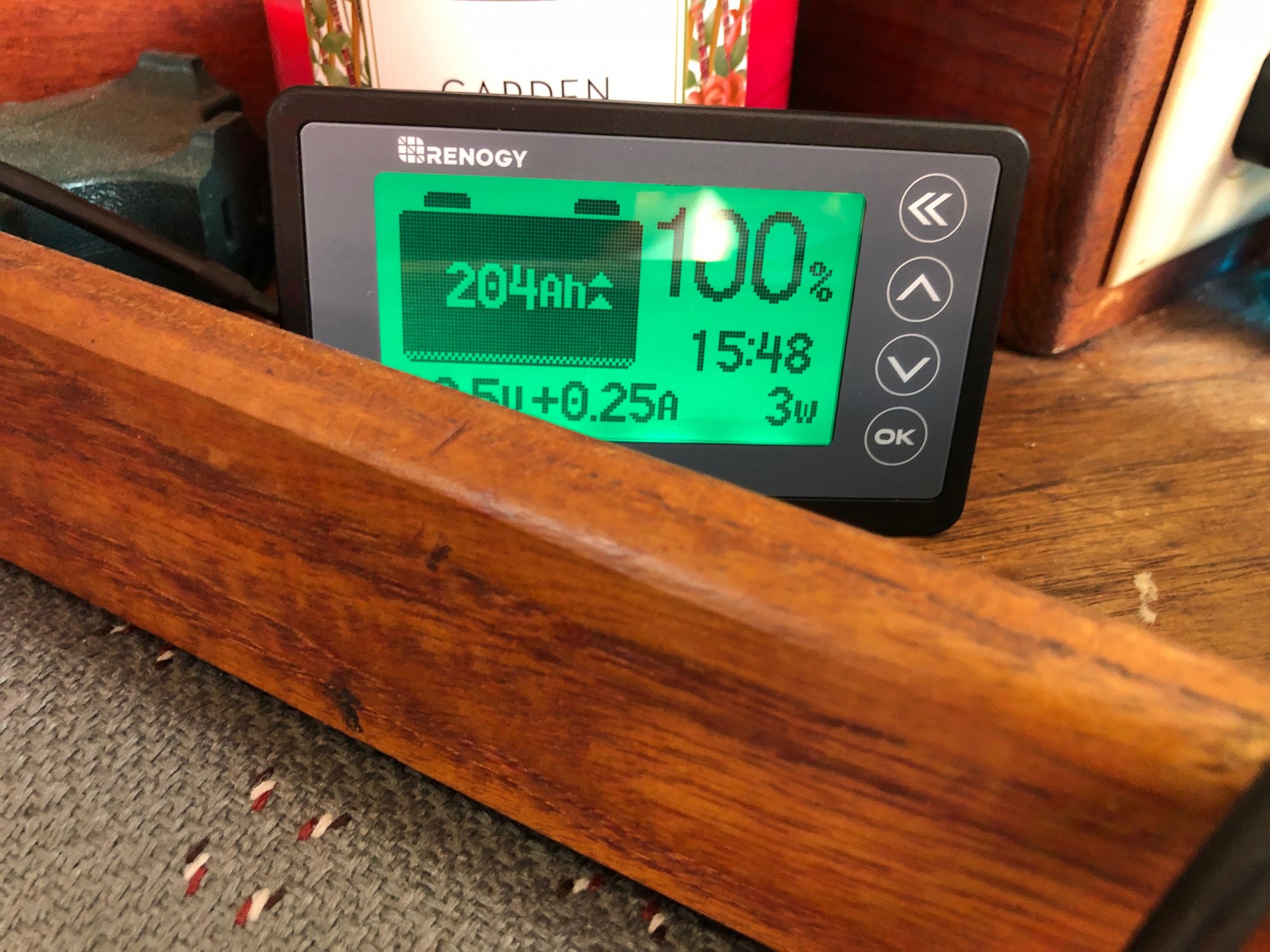

I don’t yet have an engine start battery set up, but I did install one of these Renogy battery monitors..
Very comforting to see ins and outs to the battery bank and have the monitor calculate remaining capacity and hours of use.
i do hope to add a dedicated start battery to the system next year, but this has worked great for my normal day sailing and an occasional 2-night sailing weekend on the hook.
