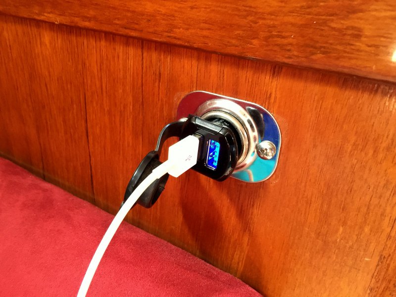

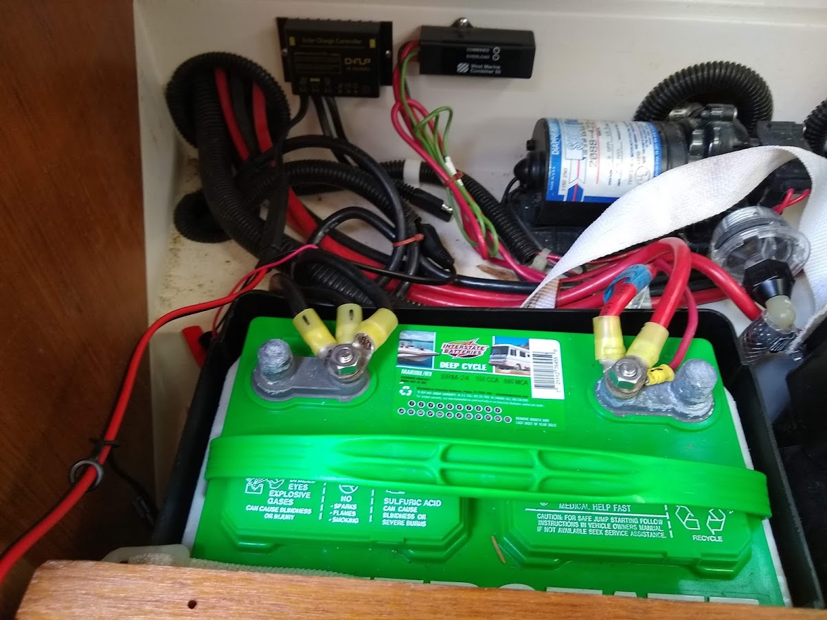

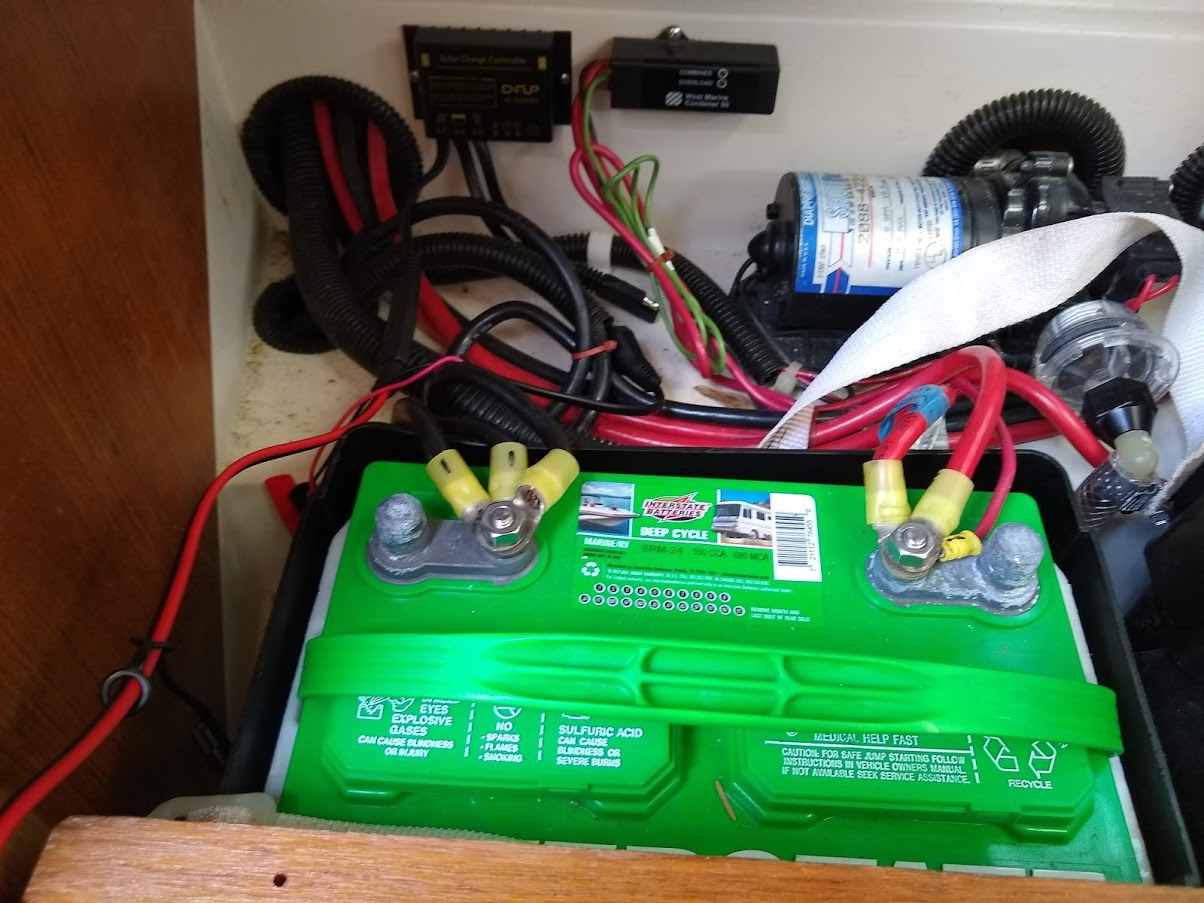

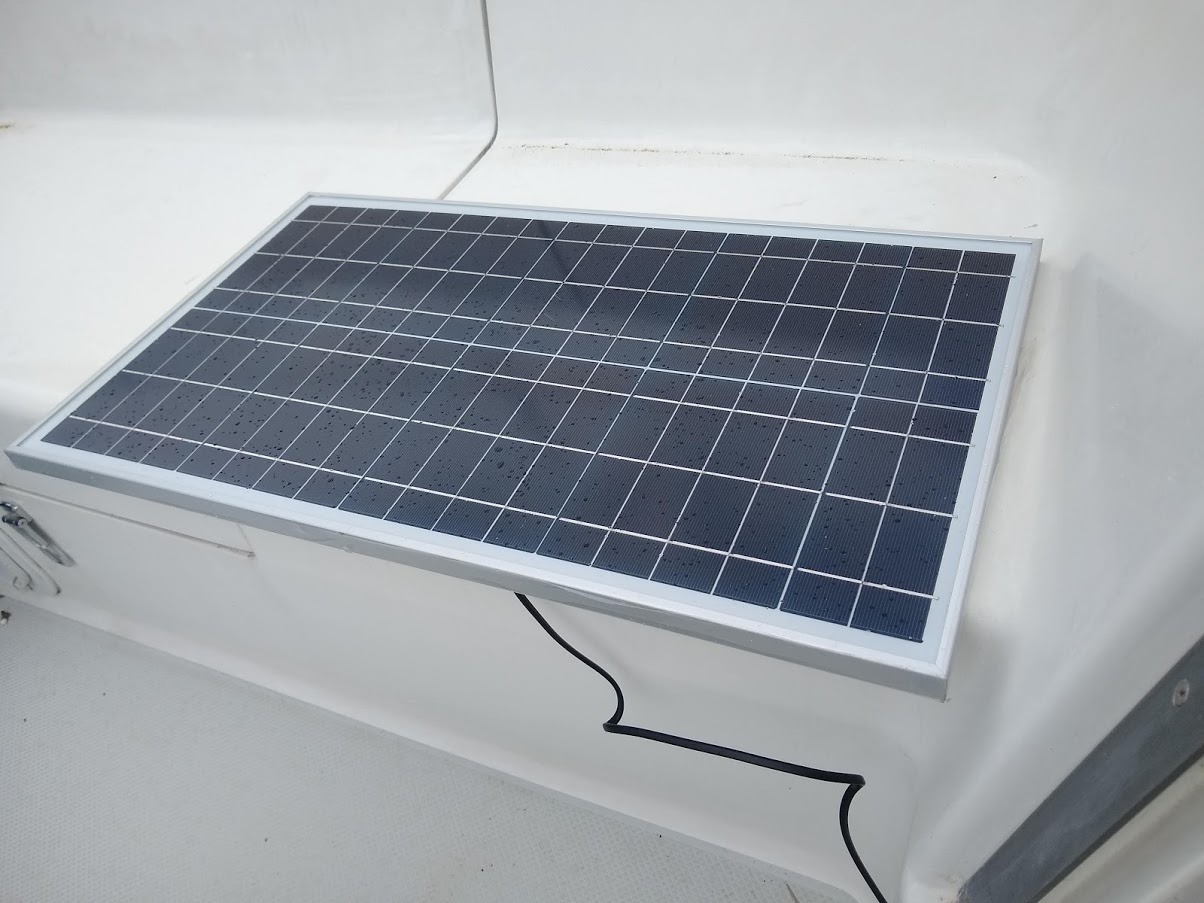

In 2019 I lost shore power due to flooding on Lake Ontario. I purchased a 30 watt panel (Suner Power) from Amazon that came with a controller. I mounted the controller to the battery, run the cable over the hatch boards, and leave the panel on the cockpit seats. Works great.
Thanks - this is exactly the kind of simple solution I'm hoping for.
