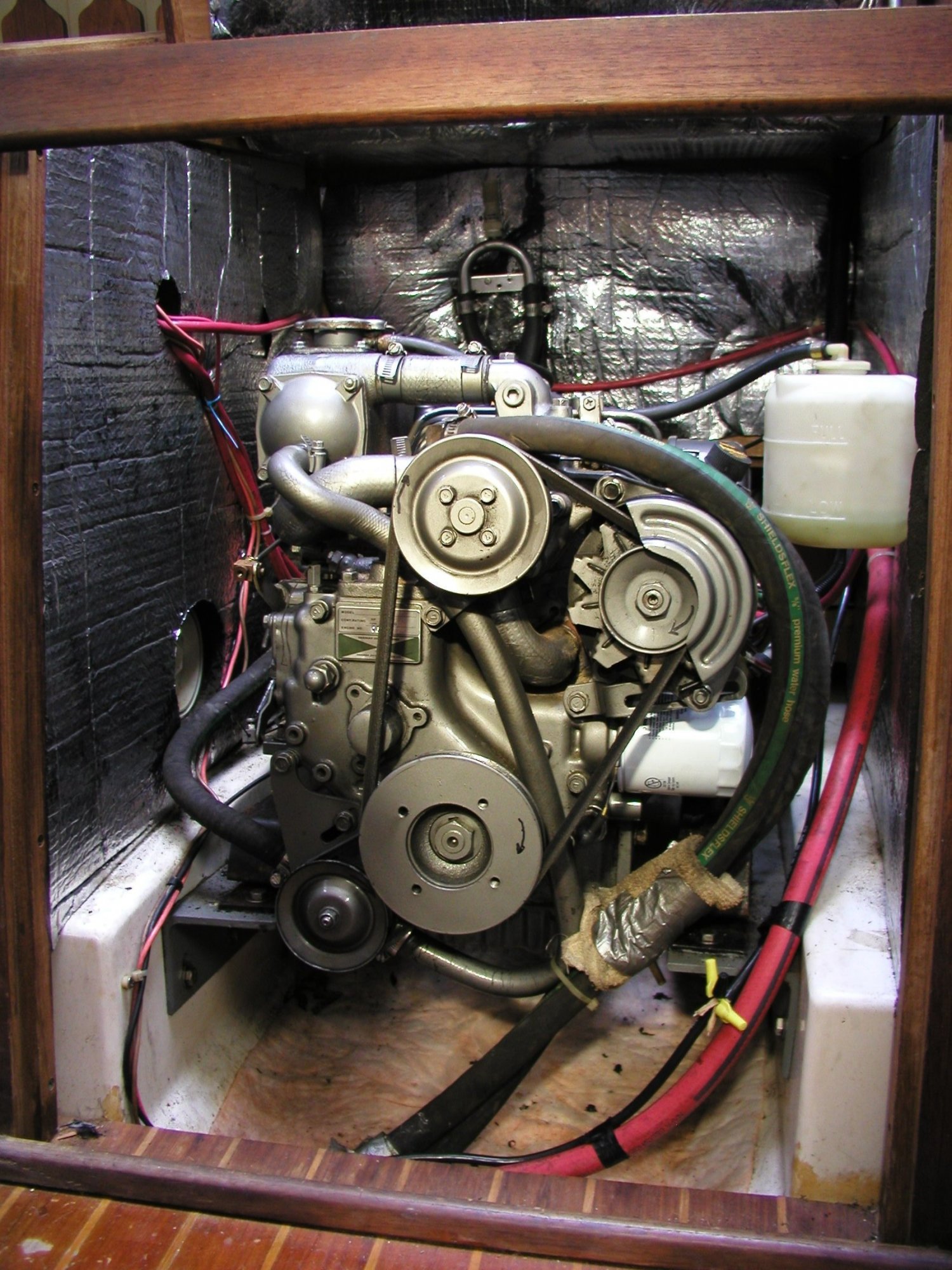

Bad connection between the battery of bank 2 and the battery selector switch.. since you were in the vicinity of the connections on the back of the battery switch, my guess is that ya got something a little loose.. The big red wires in this picture coming from the wall to the left of the engine.. Be VERY careful with putting a wrench around there to tighten the nuts on the connections.. If a wrench were to be on the connection and touch the engine, it may weld itself to the block followed shortly by a big fire.. A couple of layers of towel draped over the heat exchanger to insulate the wrench from the battery voltage is definitely in order..

Well, as usual, you guys were right. Strangely, the loose connection wasn't around the switch in the engine compartment, but at the battery leads. How they both got loosened and why it occured just when I was working on another part of the boat is a mystery...but I'd rather go sailing than solve it.
