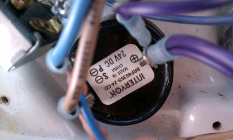

Here is the buzzer from my Catalina 310. I replaced it this summer. Put the numbers in Google and you I'll ind a supplier. Sorry the picture is upside down. Gary

I bought 2 from radio shack. (In case I broke the first one installing it.)
PM me and I'll drop it in the mail.
