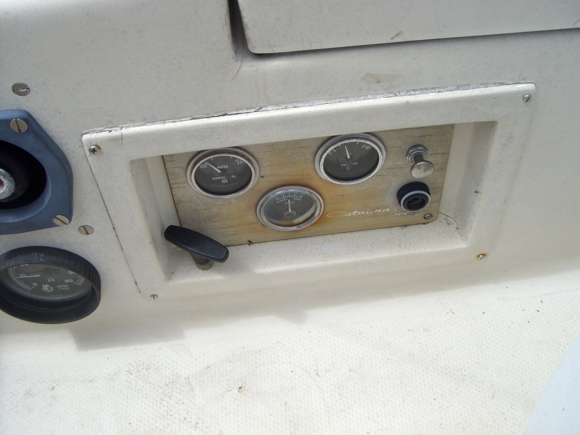

Anyone have a good solution to building or purchasing an ignition key cover for the side mounted control dials and ignition key
for a Catalina 30 1978? The cover would prevent skipper and passengers from kicking a breaking the ignition key that sticks out into the cockpit area.

A photo would help those who don't own a Catalina 30 or if the design changed over the years. I would assume aryclic sheet would work without seeing the controls.

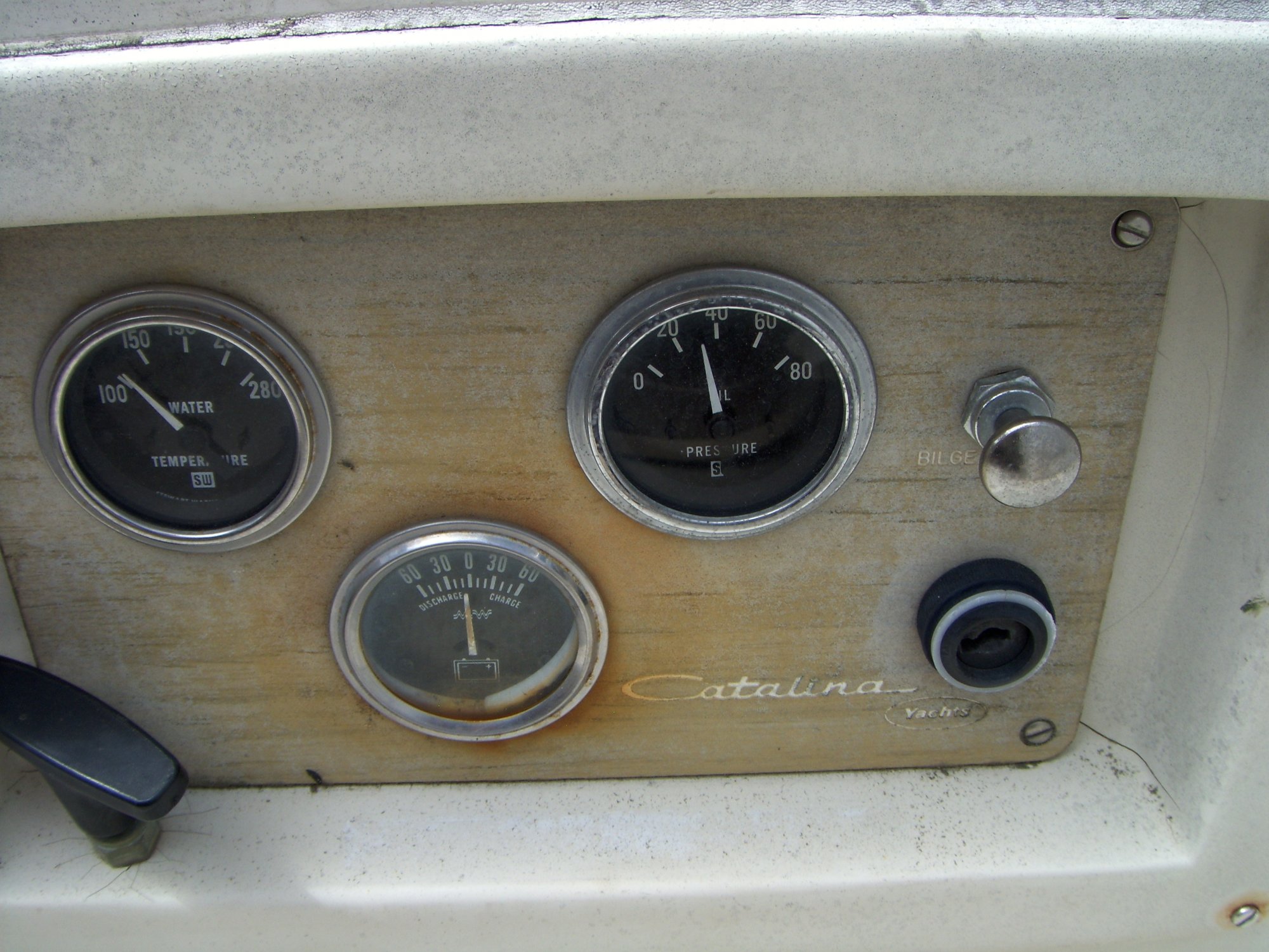

Thanks for the response. Here are a couple of photos. Once the key is in the ignition, it stick out into the cockpit area at leg level

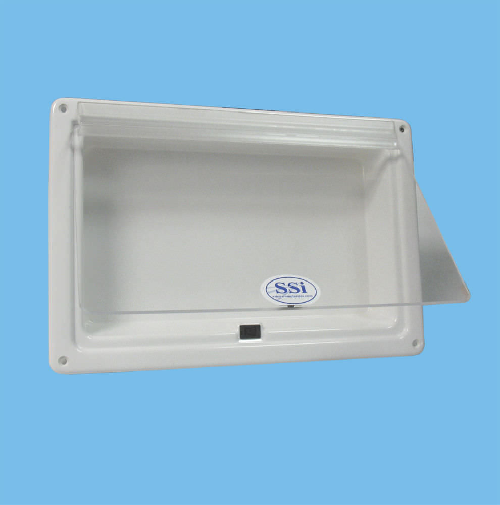

1. Hinge a piece of plexi from the top (commercial unit shown, easy enough to DIY):
2. Replace with a new panel that already has a piece of plexi hinged at the top:
(This is what was done to my C-30 by a P.O. )
3. Remove the keyswitch and replace with an On/Off switch and a start button. Now you have newfangled keyless starting. After the keyswitch that was installed in the replacement panel failed, I made this mod to my C-30. No more lost keys.
