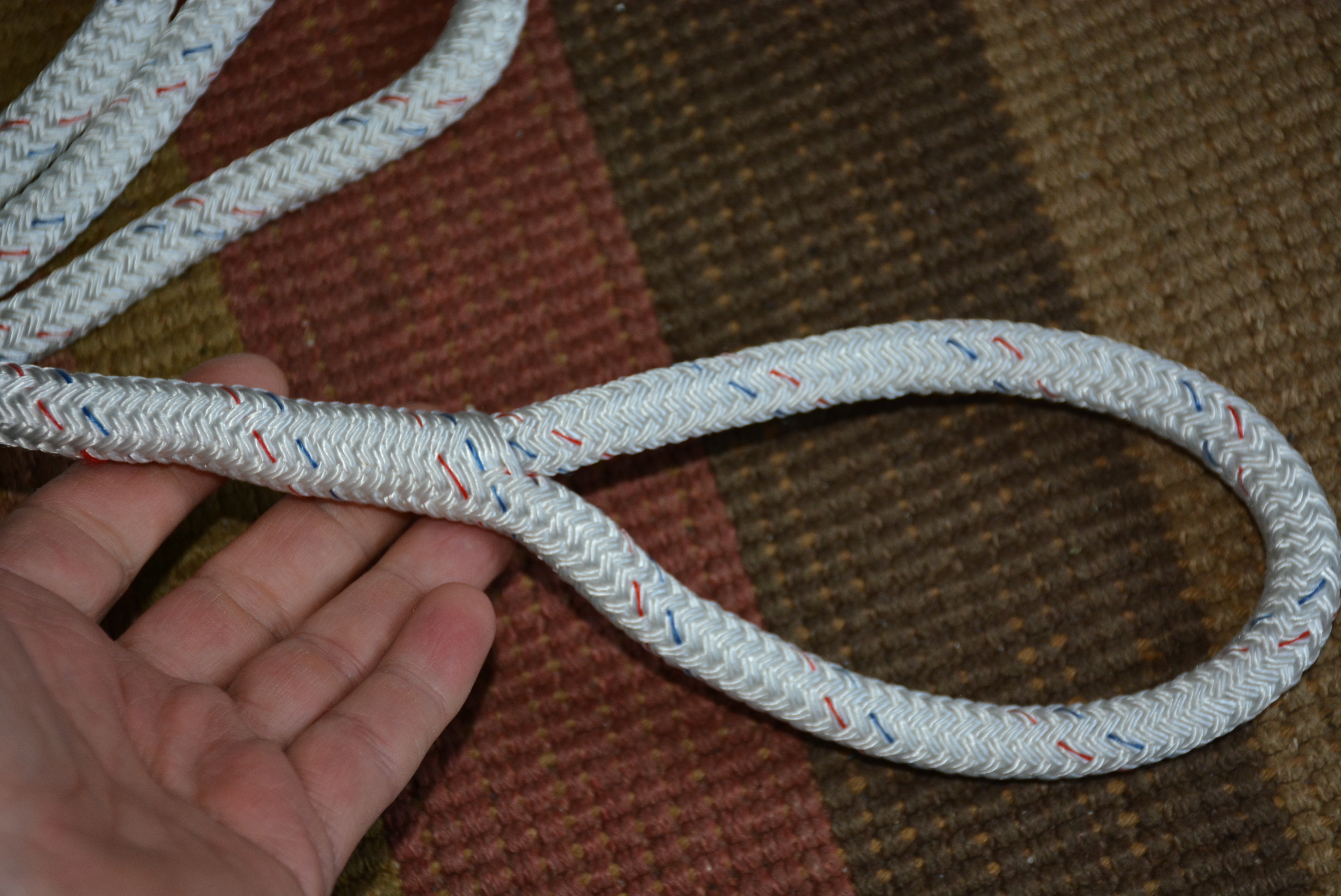

I just posted about splicing an eye in my new dockline... it came out great even if I do say so myself! :D
Well... anyway... TODAY'S YOUR LUCKY DAY KID! ;)
Here's the video that made perfect sense of the Samson Splicing book page 112, I struggled with....
Hope it helps!

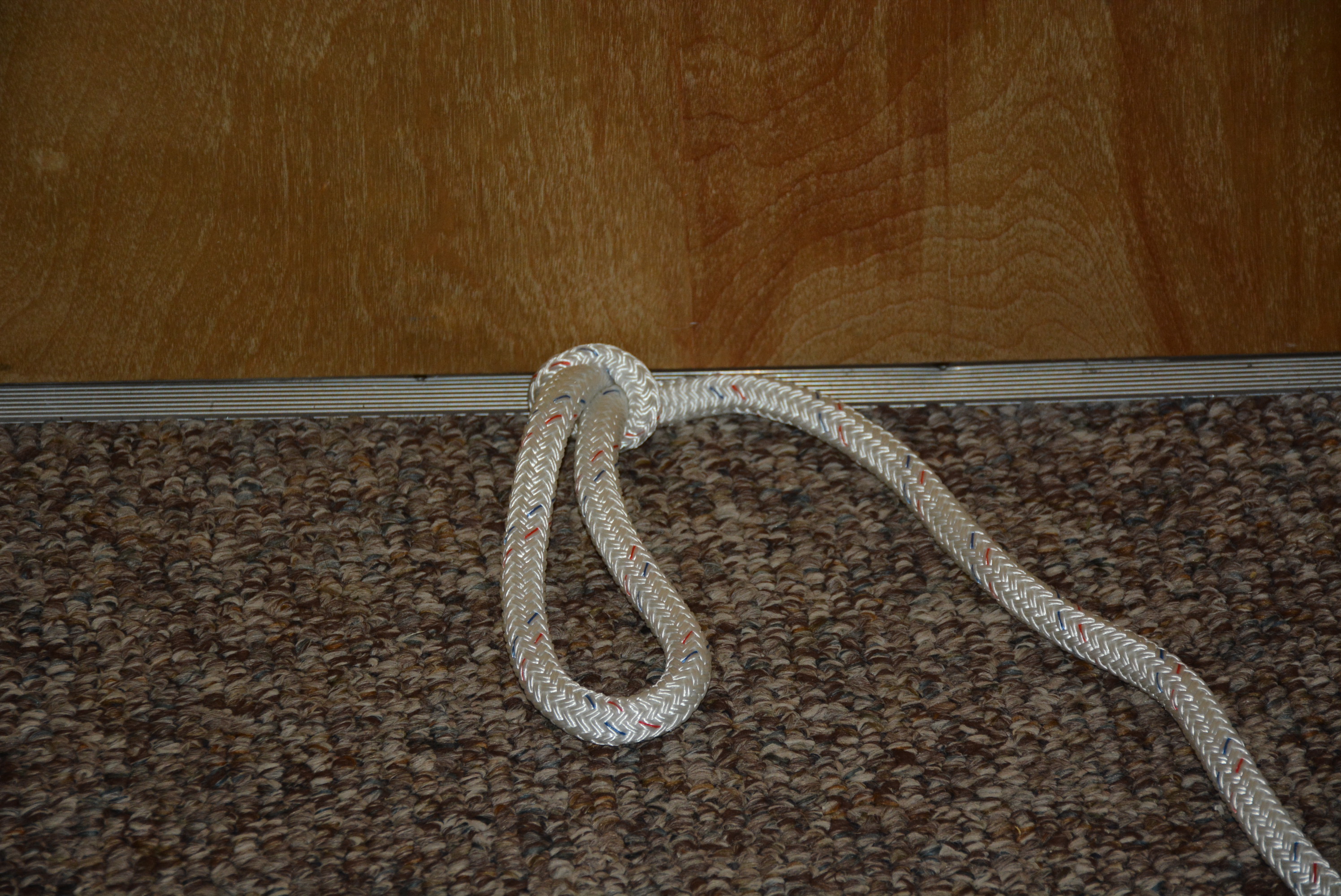

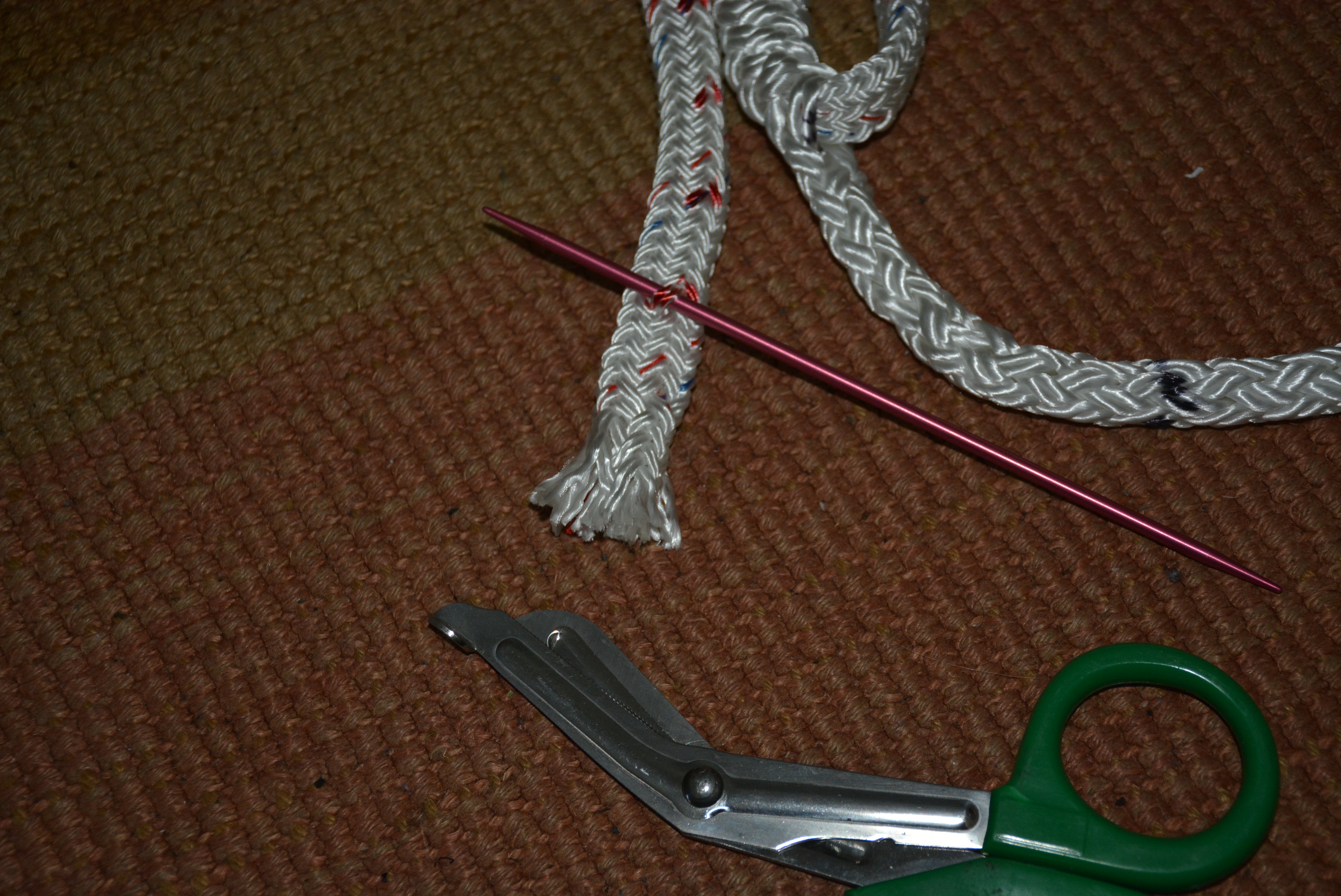

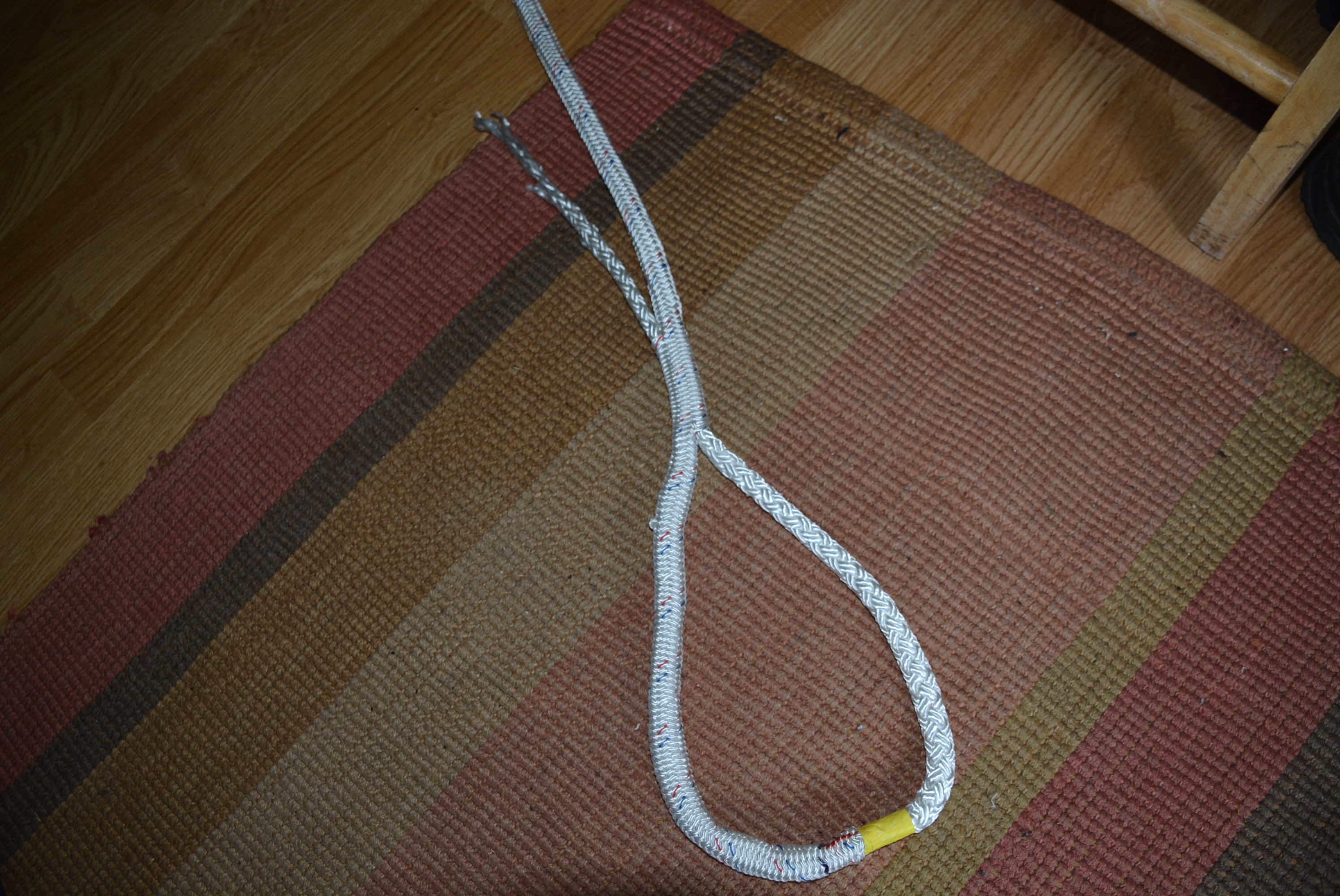

here's some shots I took...
first one is the knot holding the line anchored on the opposite side of the door... I worked on the floor since that was the largest continuous space I had for this job.
DSC_4158.JPG DSC_4159.JPGDSC_4160.JPGDSC_4162.JPG DSC_4165.JPG DSC_4167.JPG DSC_4175.JPG
