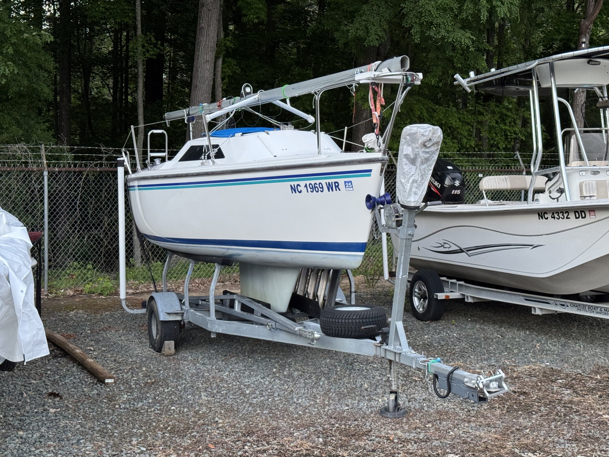

I own a Catalina 18 and due to its fixed keel I need to launch at ramps that are steep enough to get the boat into deep water quickly or that have enough pavement to allow me to use my trailer extension. I’m interested in finding ramps generally in the Chesapeake Bay, Eastern NC, Charleston, and Jacksonville FL regions. What is the best approach to identifying suitable ramps? Presumably finding ones where other keelboats have launched without any specific mention of my boat model.

It’s a Performance Trailer. With a detachable extension and extendable tongue it extends 16.67 feet past the jack wheel.

Is the fixed keel a wing bulb keel or just a straight keel? I will ask for several more poctures. First remove whatever is stored on the trailer starboard side of the keel tray. Now take photos from the side and aft of the keel sitting on th the keel tray. Your first issue is dealing with a fixed keel sitting that ca be considered as a deep fin keel. This is why the request for more photos
There was a book for NC ramps suitable for trailerable sailboats but I can’t remember the name. However, the best suggestion of contacting sailing clubs as well marine yards is the best suggestion already suggested. Pick the area you would like to go and call the local clubs and/or yards for baby suggestions. Tell them your sailboat is a Catalina 18 with a fixed fin keel. You will need to know the depth. Keep a notebook on the ramps. A good example of a yard in Oriental NC to call is Sailcraft.
