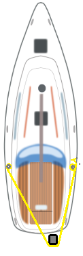

I know I posted this before but here is a diagram of what I was trying to say
This will translate all of the stress to the winches and they are designed to take a lot more stress than the bolts on your motor mount. Also, the strap absorbs a lot of the shock loads.
Put the loop on one winch... and then cinch it up on the other.
What @rgranger suggests is more or less exactly what many people do, with good success. I have seen it done using cleats, but the winches are stronger.
Worked great on our C22, with both the 15hp 2 stroke Merc and the 6hp Tohatsu replacement. We used 2 ratchet straps run forward, and tightened until there was no movement in the motor.
The triangle configuration, with lines to port and starboard is important. Just running a line/sling vertically wouldn't be as effective.
