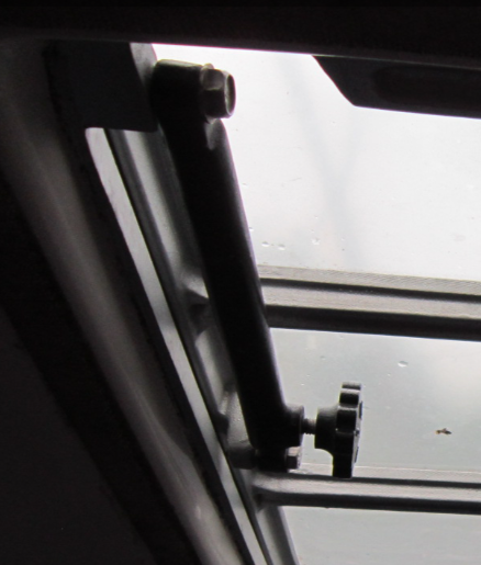

:plus:This is what I have on my 40-yr-old boat.
What posses these dumbasses to abandon something which works perfectly and get into something which doesn't, surpasses all understanding. Maybe it looks better, but isn't worth the powder to blow it to hell.

I'm just spit balling, the only thing I can see that would make it a lot harder to loosen than tighten would be the fingers flexing as you tighten it. They may twist in a way that causes them to jam and resist the opposite rotation. That may not help you since I cannot think of an easy fix.
I sure do like my old hatches with the knob to tighten in place. The small hatches in the salon have struts with enough friction to just hold them, no tightening at all.

I recommend replacing the strut with a Multi-position gas friction strut.

If you are hell-bent on fixing what you have, first, I suspect there is some kind of galling on the plastic pieces that screw together. I would try removing and disassembling the strut, and working the screw part of the collet with some aggressive polishing or lapping compound.

This was the epitome of simplicity .............
.................. with the screwed lock mechanism. WHY did they have to change it to a new and sleek design which just about kills you when you want to release the rod ?
Thanks for the idea but I'm afraid it belongs to a long ago and far better design.
I had these on my Catalina 36. They work, when they work. But they are not perfect. On two of mine the screws were seized - corrosion between the stainless screw and aluminum body. One plastic knob broke off trying to tighten the screw! The solution was some new parts and re-assmbly with Tef-Gel.
