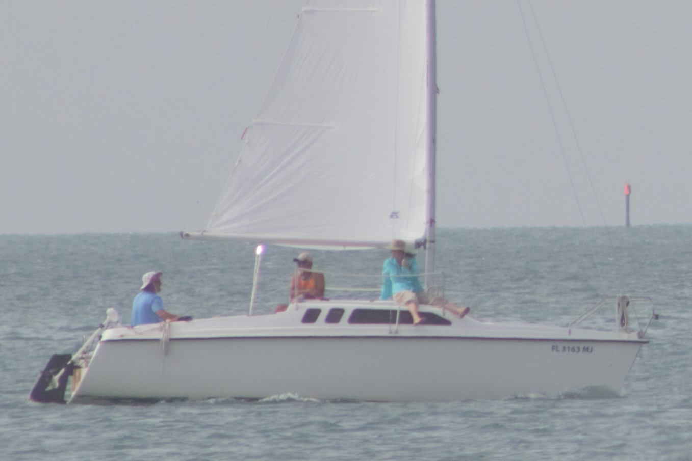

Thinking now of moving the batteries. Here's a shot taken from shore. Winds were around 15 and gusty so I was sailing on just the main. You can just see from the blurry pic that the stern is riding a little high. I think that the two batteries up by the v-berth is too much weight too far forward. I guess I will have to separate the batteries and install them farther back.

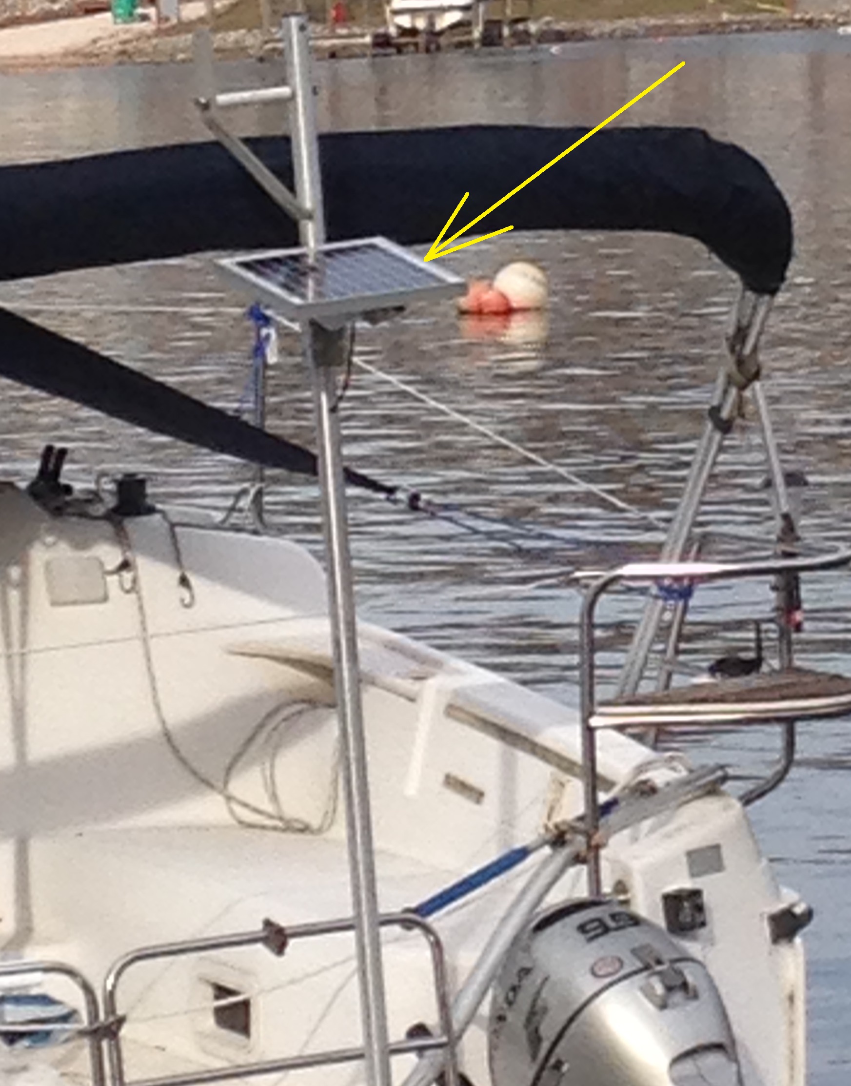

I have two batteries on my H26. They are behind the bulkhead in the cockpit berth (aft port side). The battery switch and shore power plug is in the cockpit locker (also port side) so the run to the batteries is very short. The battery charger is mounted to the bulkhead in the cockpit berth so I can see the indicator lights easily. I also mounted a solar charge controller to that same bulkhead and I leave my mast crutch attached to the stern so it doubles as my solar panel pole.

I did a quick moments calculations, and got the design moment of the motor, fuel, and battery (on the h23.5) at around -1160 ft-lbs. With your setup (assuming 100 lbs of batteries and 25 lb motor) I get a total moment of +113 ft-lbs. So, yeah, I'd say you're bow heavy. Moving the batteries behind the aft berth I get around -1520 ft-lbs, which is about the same as adding stern rail seats to the original boat, or having a 9.9 hp instead of a 4 or 6 hp. If you put your two batteries in the original battery location I get a moment of -660 for the system.

Update on this mod. Batteries are now in the stern and now she's squatting just a bit but much better than before. In other news, we're contemplating some longer trips so I decided to spring for a little 6hp Tohatsu. It just took one trip with the outboard to confirm that the trolling motor was the way to go. What an unpleasant racket. As soon as I'm through the break-in period, the outboard is going in the V-Berth to serve as ballast and a backup in case I run out of battery.
