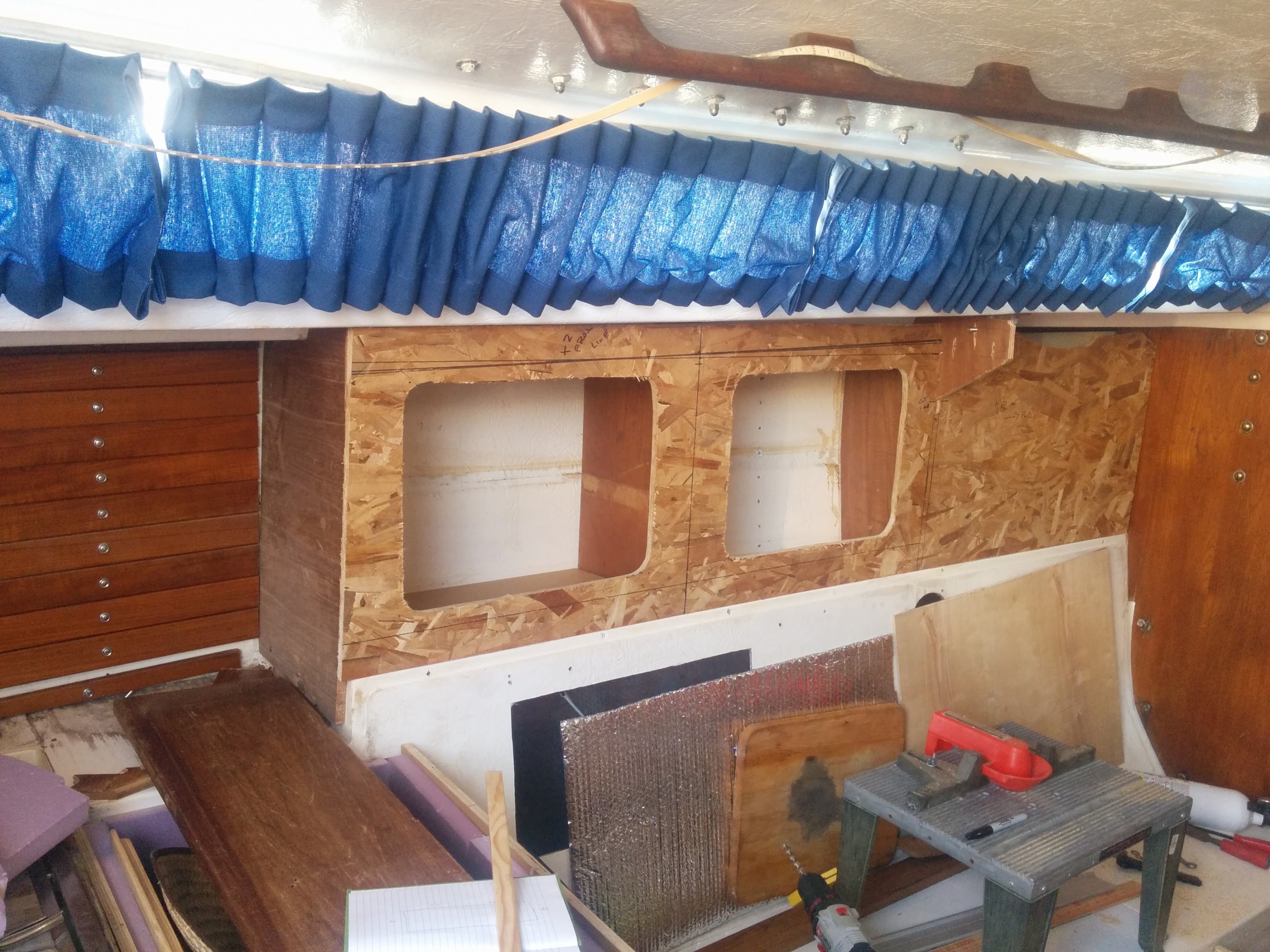

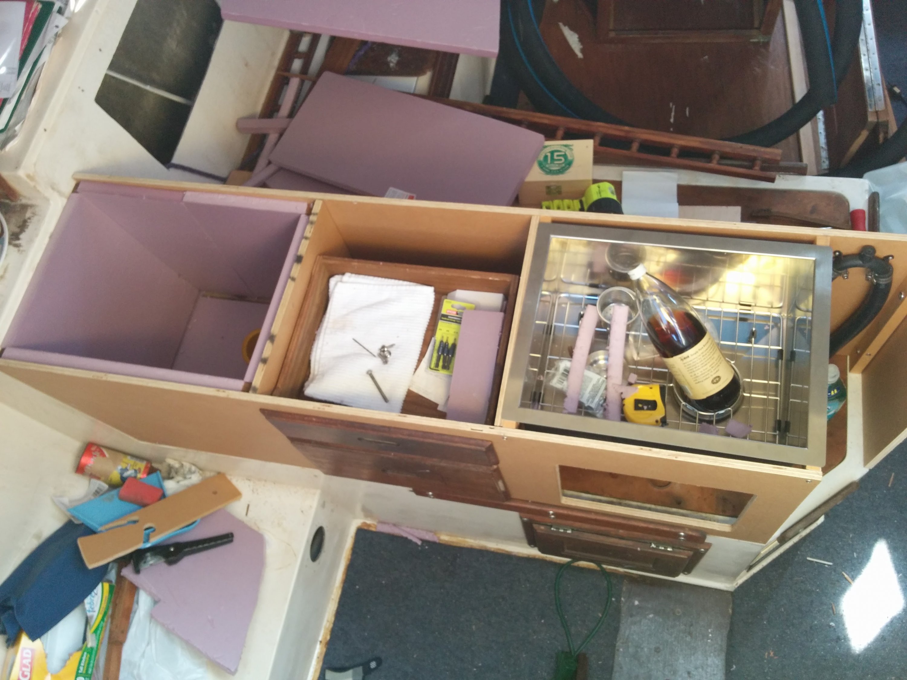

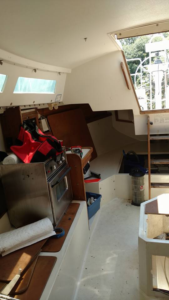

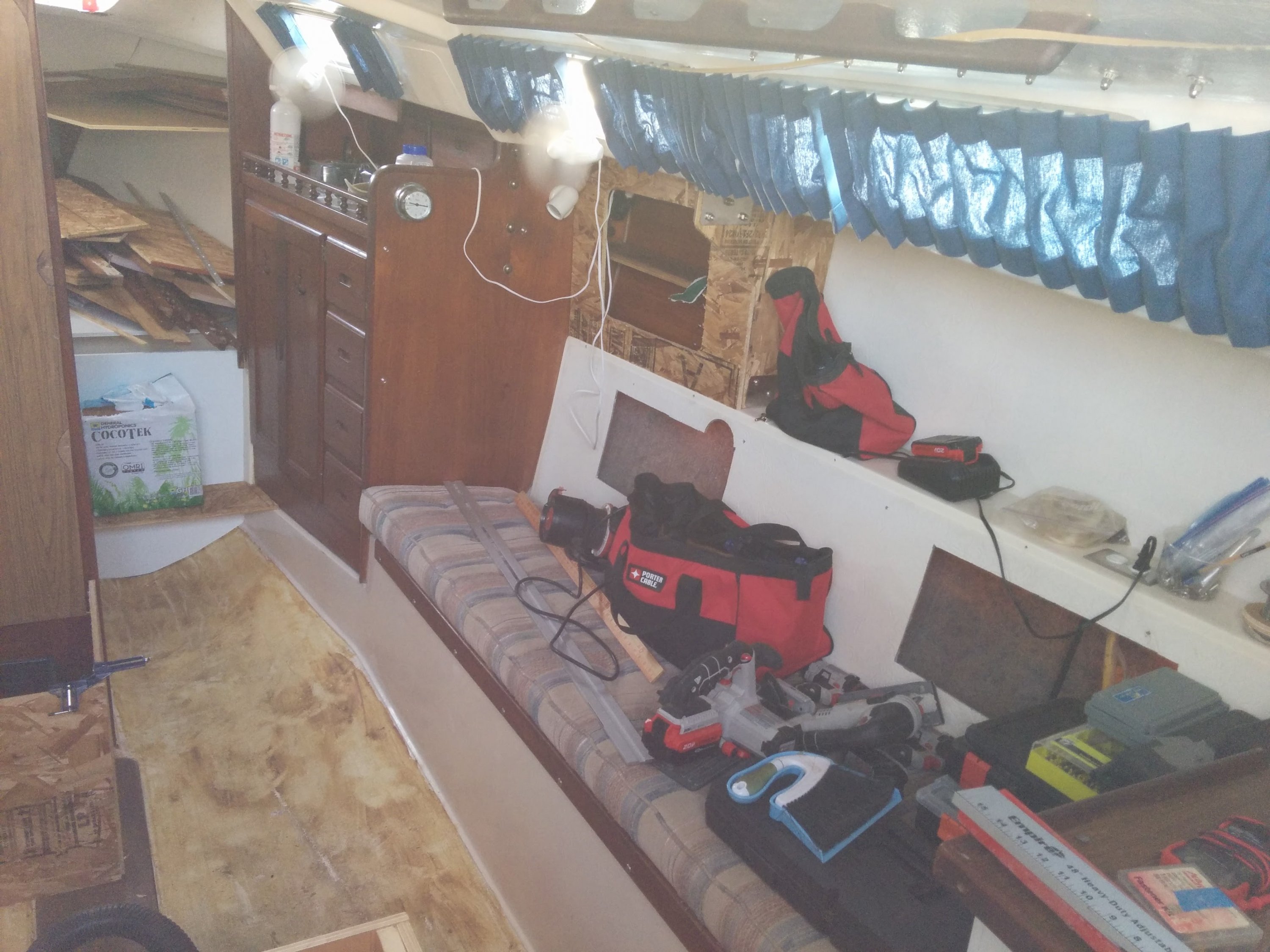

I've not re done the counter top yet, but I've moved the sink to the centerline, drawers in the middle, and now there is a empty space where the double sinks use to be. I've also got a pattern up for adding cabinets where there use to be shelf on the port side of the boat

That's really looking good. Your idea of osb is great for patterns. I had not even considered making patterns. Glad I asked!!!!

Thanks
The OSB is much cheaper to make a mistake on then the 1/2 MDO I'll cut the final piece out of. With your boat being a Mark III, if you decided to do something similar you would have an easier time, as there is no lip that is present on the mark 1 model. There are also some good ideas for storage on the yahoo group for the Catalina 30.

Hi Kevin, What is the purple material you are using inside the cabinets? Also, where did you get the batten material for the rear of the shelves? Thank for the pics.

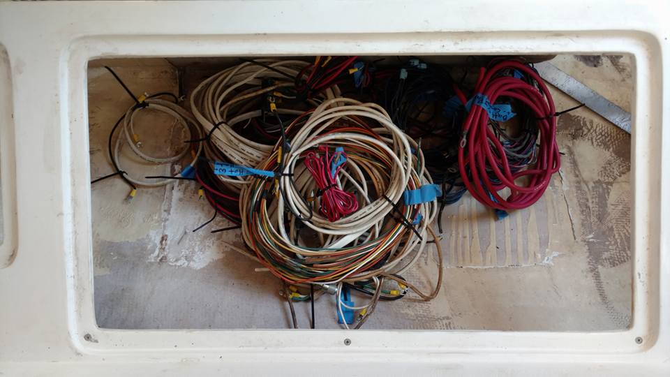

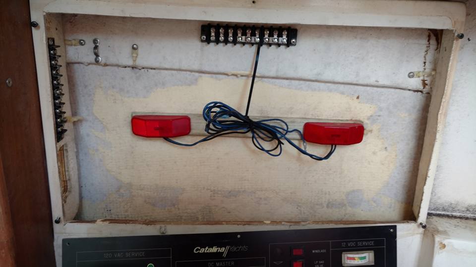

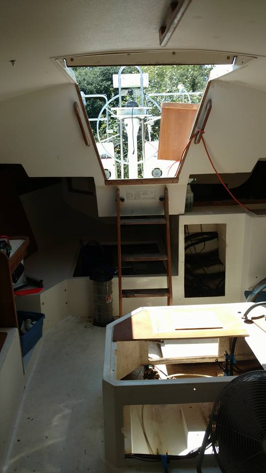

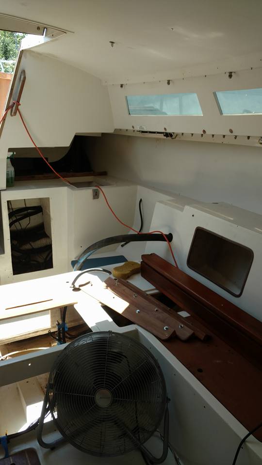

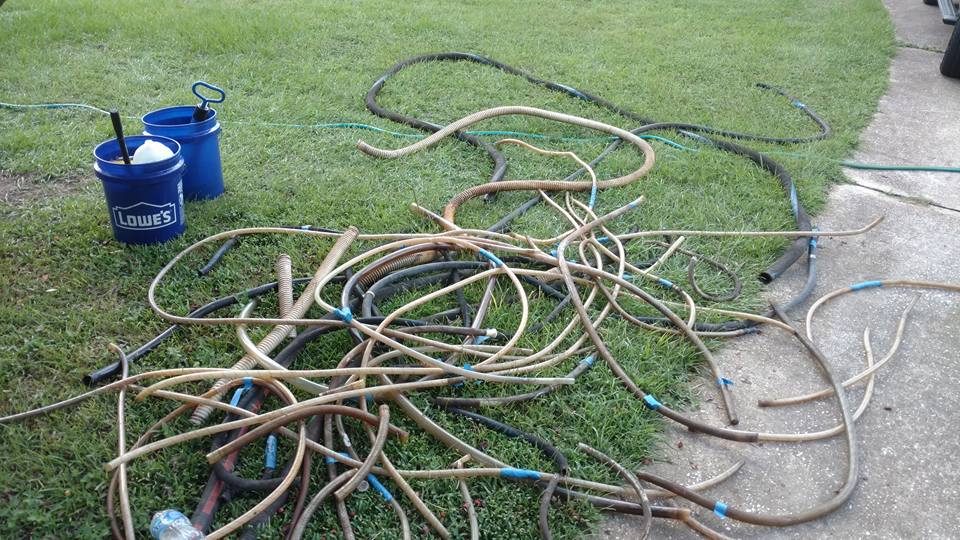

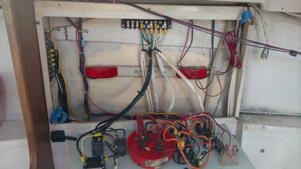

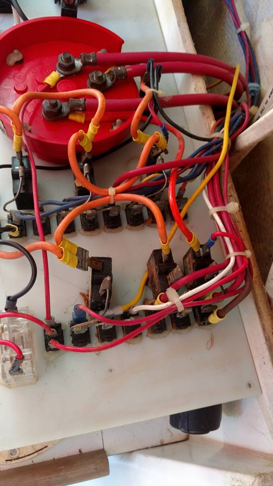

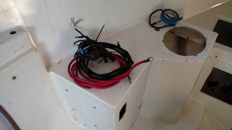

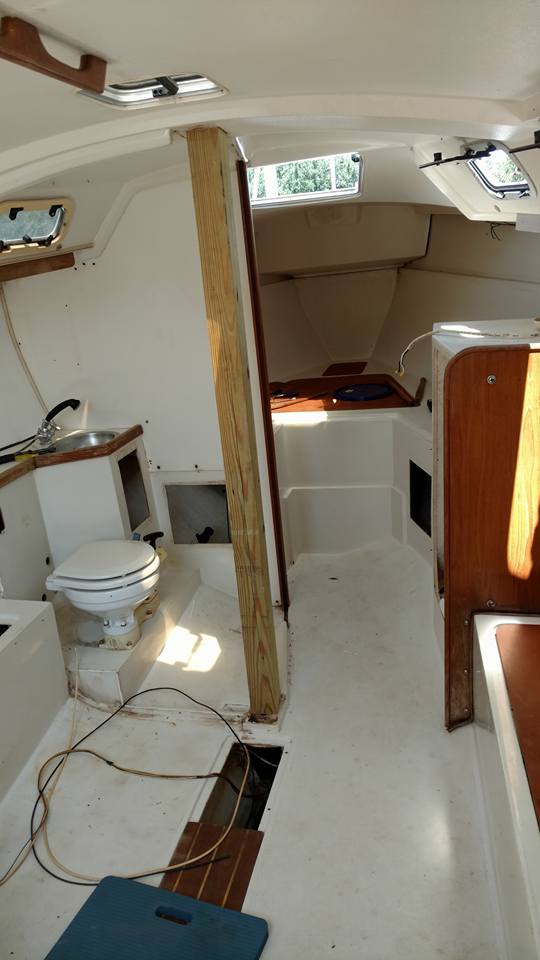

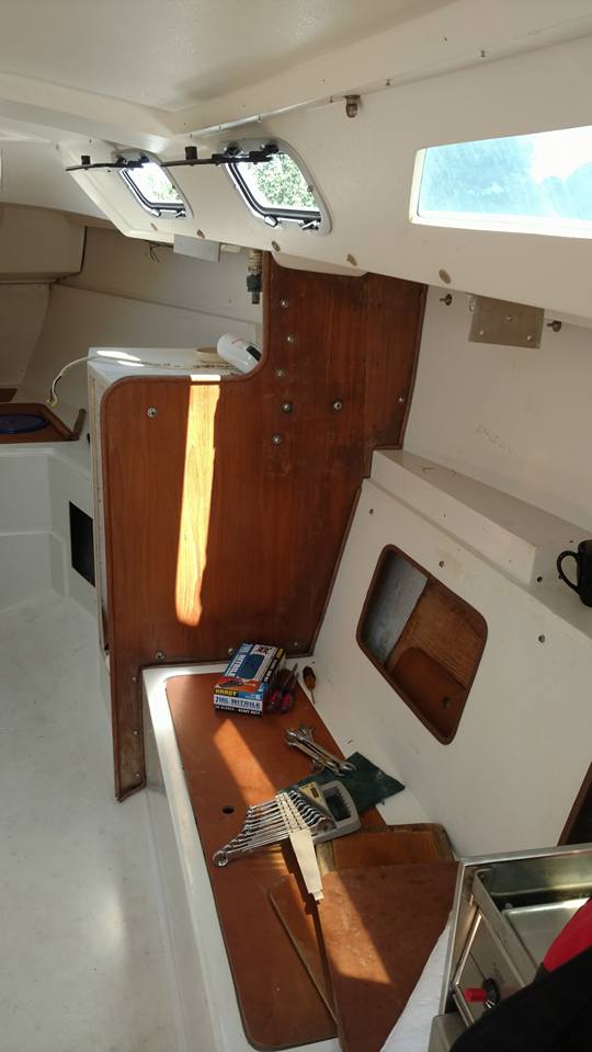

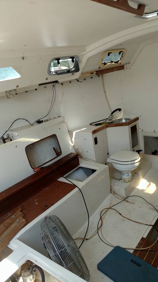

Mine is a Mark II. I have the "T" cockpit with the walk-through transom, no swim scoop. Here are a few more pics after a day of pulling out the wiring. I am so tired--Thanks to my man servant Patrick.

The purple board, is just some Pink board from home depot, Insulation stuff.
The teak slates, (batten material) was done by the previous owner, it looks to be 1/4" teak boards.

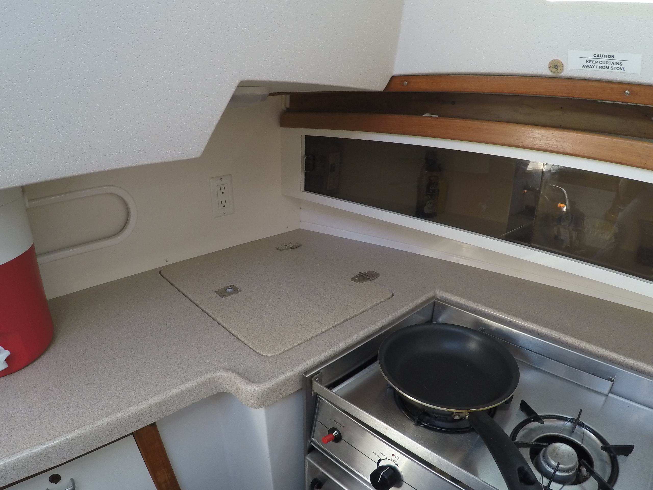

I love the way your tops look. That is exactly what I am looking to do. THX!!
