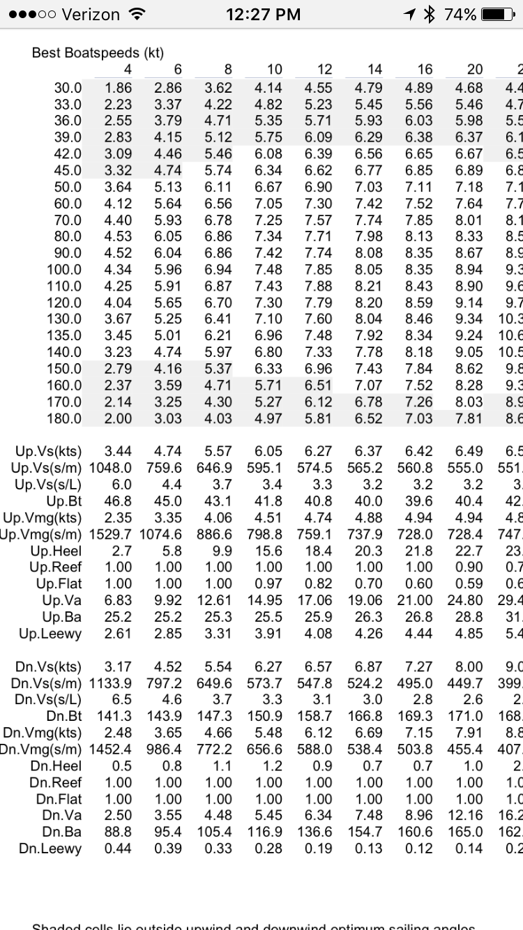

As an example of ideal upwind heel, look at the line Up.Heel for typical heel angles for increasing wind.

Jackdaw, any chance of getting the source for this data so that I can make some sense out of particularly the bottom 2 tables?

Sure. Remember that is is example data, generated by a velocity prediction program (VPP) for particular boat, in this case the first 36.7. It's a computer model that the designer uses when creating the boat. It's primarily used in creating the so-called polar charts for a boat, which give maximum speed based on angles and wind speeds. I'm pretty sure that there is no polar data available for the Catalina 30, but the Idea is the same.
In this case it's interesting because it also shows the optimized heel angle for any upwind speed. While first 367 specific here, the concept applies globally.
You can find the entire document here.
http://www.blur.se/polar/first367_performance_prediction.pdf

Thanks, Jackdaw, I really learned something from your comments and link. Conforms well to my experience on our '77 h27.

Its important to remember that the 'ideal' angle of heel for any boat will ALWAYS be a function of true wind speed. In general, flatter is better. The foils simply work better.
The why is any heel ideal? The heel angle is a function of the rig/sailplan powering up, and working against the keel's Righting Moment (RM). That's a good thing as thats where the boat gets its power. But always remember that when the boat heels everything is less efficient. Its a trade-off that generally says the the more wind, the more heel. Up to a point!
