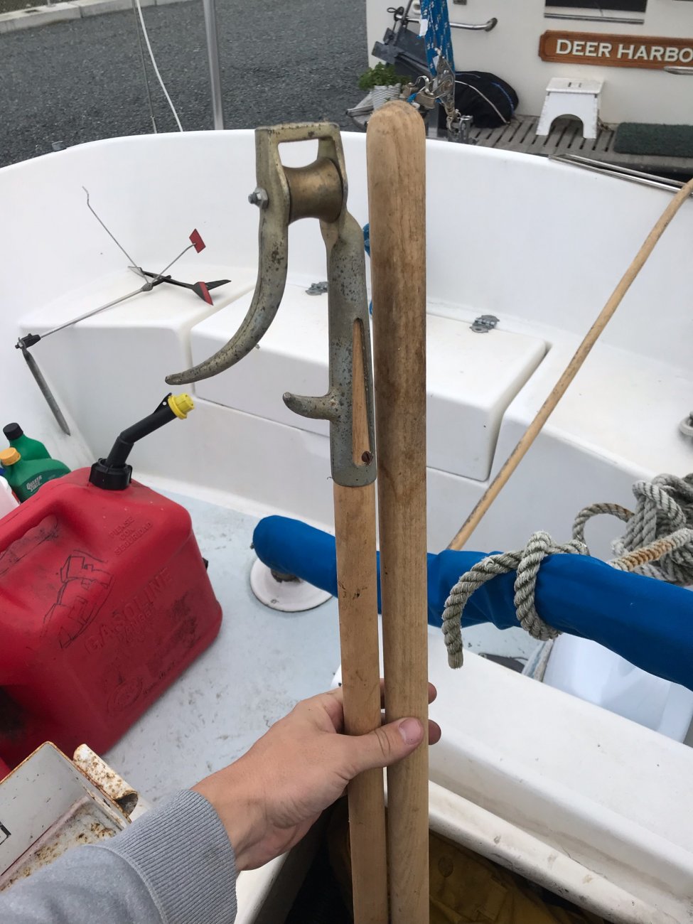

Next question..when i picked up spinny pole..there was a shorter pole as well with a pulley on one end..maybe 3-4ft long...the other end has the typical pole c clamp deal. PO's wife wasnt sure if it went to the newport but thought it matched the spinnaker pole well amd had me take it. You guys know this mini pole?
Jazzy
24,677
How Long? Does it collapse?
Could be an adjustable whisker pole. Used to hold jib out - extended to go downwind wing on wing...
Jan 2, 2019
39
Newport 30 Gig Harbor, WA
Super beefy..about 4ft long...looks just like a short spinny pole but one end has a pully instead of the clip. Not collapsable...seems short to hold a sail out.

Yes that looks like exactly what I have! Thank you...reaching strut! And now Im at the boat with a new question...last here i was sanding and cleaning the bilge with hopes of glassing today. I come to find an inch of water in the bilge. As the boat is on the hard and the icebox is dry and no showers...i can't figure from the drawing 6-7 where this may have come from?? Boat appears dry inside otherwise... Can someone shed some light or ideas please.

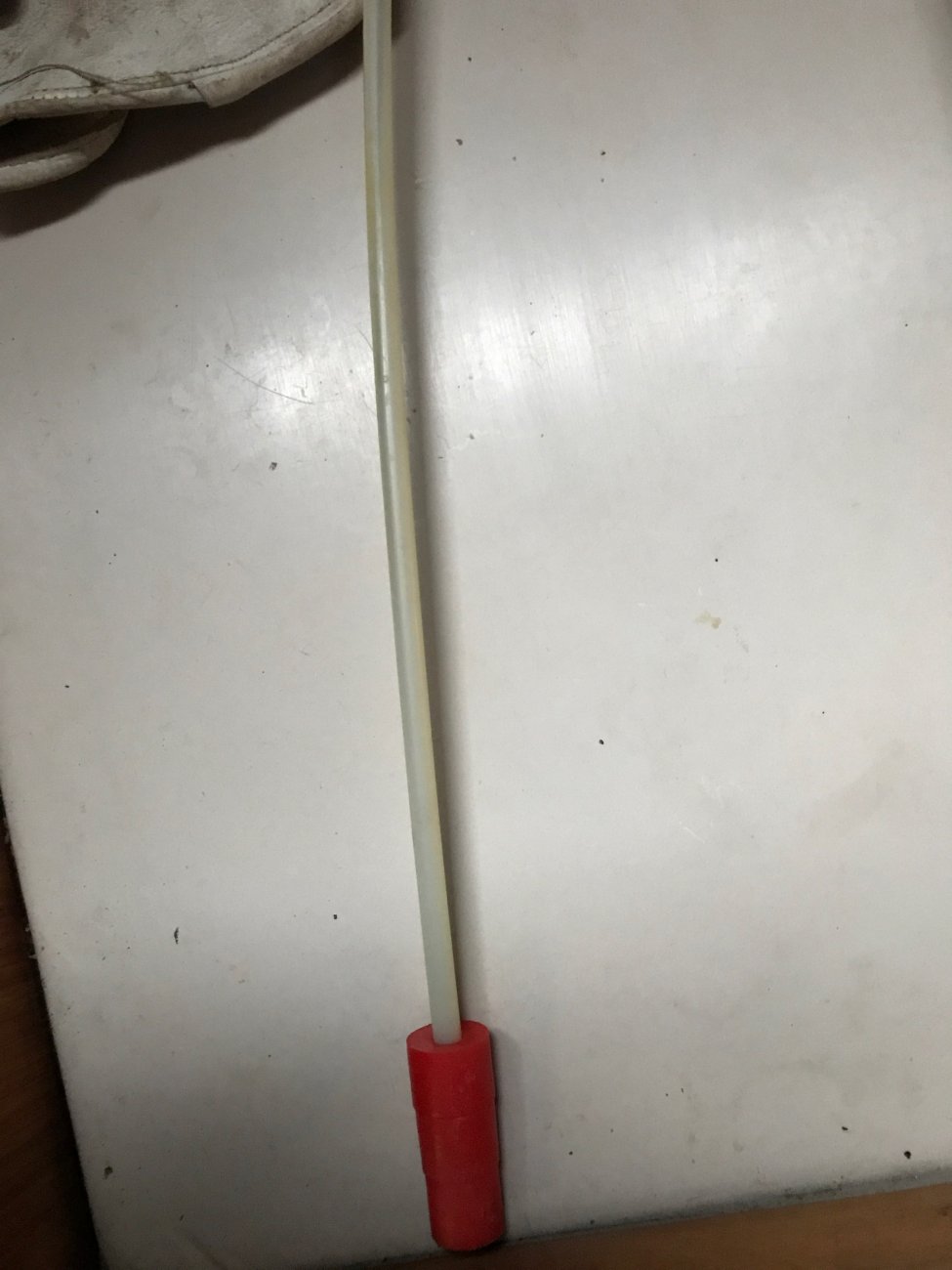

Plugging along.. got oil pressure gauge installed, battery condition meter, removed headliner to find a leaky winch, drained old gas...blah blah the tiny projects are endless. And of course ran into what the....????? The rod like thing was next to gas tank...
Maybe you guys can identify...
24,677
Might work well to grab the line of a mooring bouy.
May 20, 2016
3,015
The tube with the red end is for sucking oil out of your engine or transmission -- there should be a thing that looks like a garden sprayer that the red part hooks into.

Sweet, Ill look at the mystery tube more carefully with that in mind next time. Ty!
