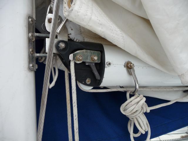

10,220
Outhaul
Sounds reasonable, Capn' Kev.. Ya might want to consider moving the cleat forward some, to a place you can reach when the boom is swung out a bit.. It is easy to lead through the boom to a forward sheave so it exits at the gooseneck and you can adjust while sailing any point.. The small line coming out the bottom and going aft to a cleat.. That bundle of line in the bail is the outhaul.

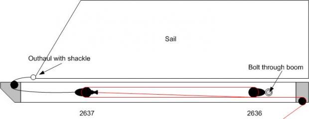

As Kevin3447 said you will want a couple blocks for more purchase. Even my H22 has blocks (inside the boom) for more power. This is how my H22 is set up.
