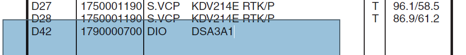

There is a diode that is intended to protect against a reverse polarity event. I believe, that IF you were were lucky, that's the only part that would need to be replaced.
I think that you'd have to take the radio apart, (as generally shown in the *.pdf below; and trace the power 12 V to the power supply. It isn't shown (except in the diagrams below) in the info from Brian's post; however, I'd call a local real electronics type if you want to take a shot at it.
From Brian's post, I think this it it.
Good find.. That diode is intended to work in conjunction with a fuse in order to protect for reverse polarity. I didnt look to see if some external fuse was specified in the wiring diagram but if so, all that should have happened with the reverse polarity is that protection diode forward biased so there was a lot of current flow and this would blow the fuse in an instant. If the proper fuse was used, that protection diode should be just fine.
Walt makes an excellent point. If the reverse polarity protection diode worked as designed, that is, the in-line fuse blew, you would merely need to replace the fuse. If there was no in-line fuse, then the diode probably burnt out, failing 'open,' and then subsequent damage occurred. This could be almost anything connected between HV and GND, and also anything connected to the other side of a component that might fail to a short circuit condition.

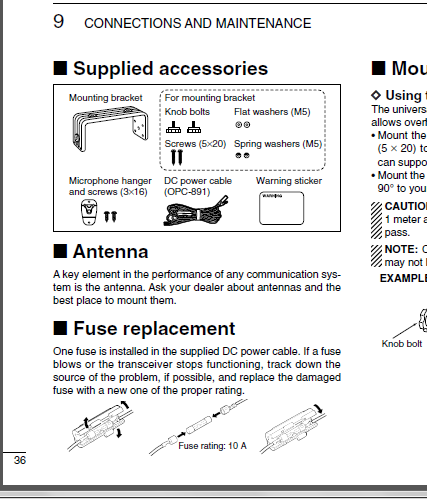

The operating manual, plus the service manual seem to say that there is an inline fuse.

On my radio the fuse is at the opposite end from the radio - a few inches from where it connects to the on/off breaker at the DC distribution panel. And as jackdaw indicated that connection at the radio end is a female bullet connector.

No. If the protection fuse, which is outside the radio, in the wiring harness, blows, the circuit becomes open. No damage to the "power," though I'm not entirely sure what to what "power" you refer.
It's really quite simple, and works perfectly if you install the radio per the manufacturer's recommendation, which includes the external protection fuse. Correct polarity, the protection diode is reverse-biased and doesn't conduct; reverse polarity and the diode is forward biased, and conducts. The fuse blows so quickly that the approximately 0.7V forward bias voltage drop of the diode is not enough to do any damage.
