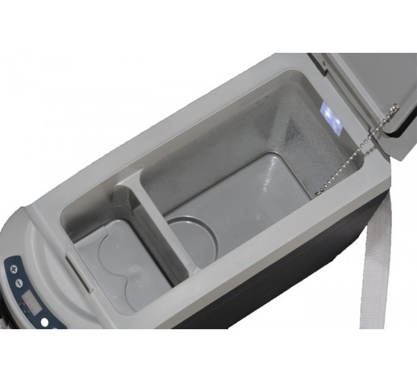

Then I found the Isotherm TB18.
At 18 liters (19 quarts) it's large enough to stow a good quantity of well packed food. Mostly because there's no ice!
Or for a long trip, pack the icebox and 6 days later transfer remaining food to fridge.
It certainly is more than adequate for weekends, for creamer, milk, juice, some food, and maybe beer. Or Perrier.
It has a danfoss compressor, internal light, digital temp setting, etc. with the controls on the front where they should be. -another box I had been looking at in this size had them on the rear.
The TB 18 is rated at 12 amp hours per day, but I swear I found a real world test by someone who showed half that. At only .7cf, it doesn't need a lot.
You can set max cooling speed on shorepower or Econ mode on (example) solar.
Also can be used as a freezer.
And it weighs less than 10 lbs. so can use it in the car, camping, etc.
also fits and hides in the quarter berth with easy access.
The beauty is that I don't have to install anything.
And it cost $335 delivered to my door.
