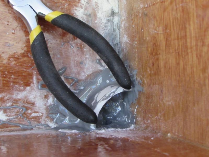

For the drain, I have a PVC pipe that goes though the foam to a drilled hole in the inner box. The inner box is all epoxy/ glass taped and sealed and I used some 5200 fast dry to seal the PVC pipe to the inner box. It’s all hardware store stuff for the drain on the outside, just unscrew that cap to drain. When the drain cap is open you can feel a nice flow of cold air coming out.

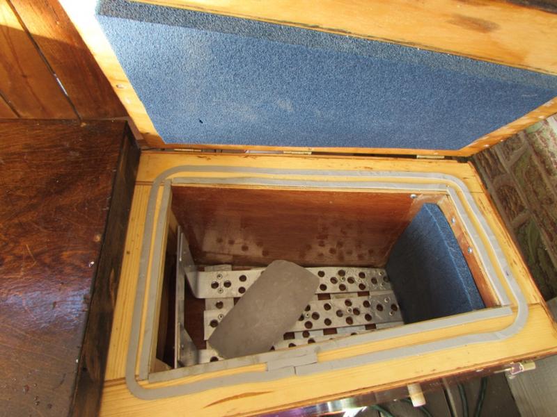

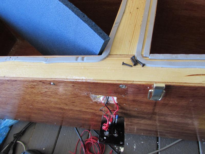

Time to modify.. I don’t want to mess with the outside of the ice chest.. it already is something only I will remotelly think sort of looks nice. However I do want to add some insulation. The height driver on the inside food area is that a plastic one gallon jug of milk fits in their upright and I have some room here so I’m going to raise the floor. Seems like the flloor would be the best bang for the buck to increase insulation and R value.
What I’m going to put in there for the additional insulation (there is 2 inches of styrofoam already in the floor) is just the old high density foam shown in one of the pictures. This is an old back packing pad and is 5/8 inch thick. I will add another 5mm piece of plywood on top and then re-seal everything with epoxy and glass. Since I already had the drain in place in the ice area, I’m having to raise it a little in order to raise the insulation on the inside.. Oh well.. It’s a prototype experiment..
Also, when I did the test before, I had the cooler raised up off the ground by registration blocks that will eventually hold the ice chest in place on the boat. So I had air flow UNDER the ice chest. When I actually get the ice chest in the boat (not until November), I won’t have this air flow under the chest so this should help.

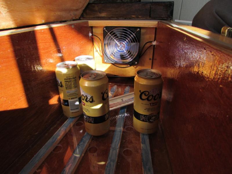

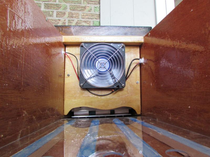

Power on the fan.. yes very low. I added a high brightness blue LED and a switch (which you can see it taken apart in the picture) but run the LED with only 2 ma. Both the fan and the LED burn barely over 0.06 amps. If I run the fan for 1/2 of each day, Ill use only about 3/4 of an amp hour each day - almost nothing.
Doc Holiday, any comments about that high density foam before I get it all epoxied in place and can’t remove it?

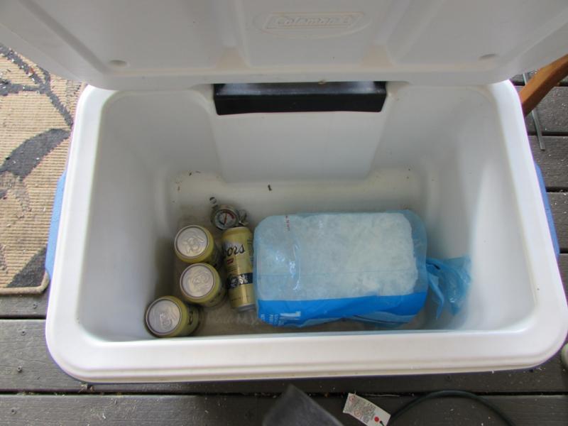

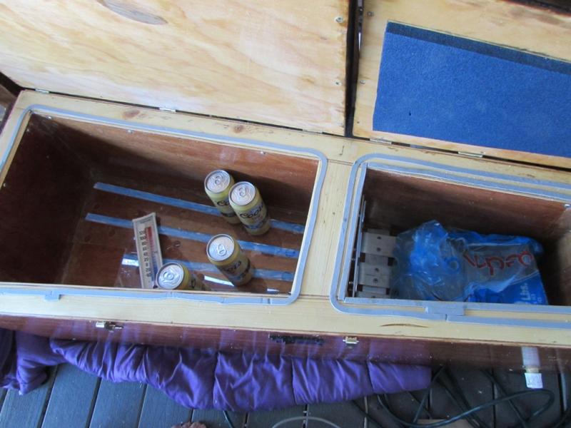

I started this test yesterday and put a 10 pound block of ice in the new version of this two chamber chest with the 3 inch thick bottom and 2 inch thick sides. The fan has been running the whole time.
I also put a 10 pound block of ice in a "5 day" Coleman cooler.
Its not yet one day but the two chamber ice chest is running about 3 or 4 degrees cooler in the food area than the 5 day plastic cooler even though the thermometer is very close to the ice in the plastic cooler (as is every thing else).
Neither will make 5 days but the two chamber cooler is still melting the ice significantly faster that the plastic cooler.

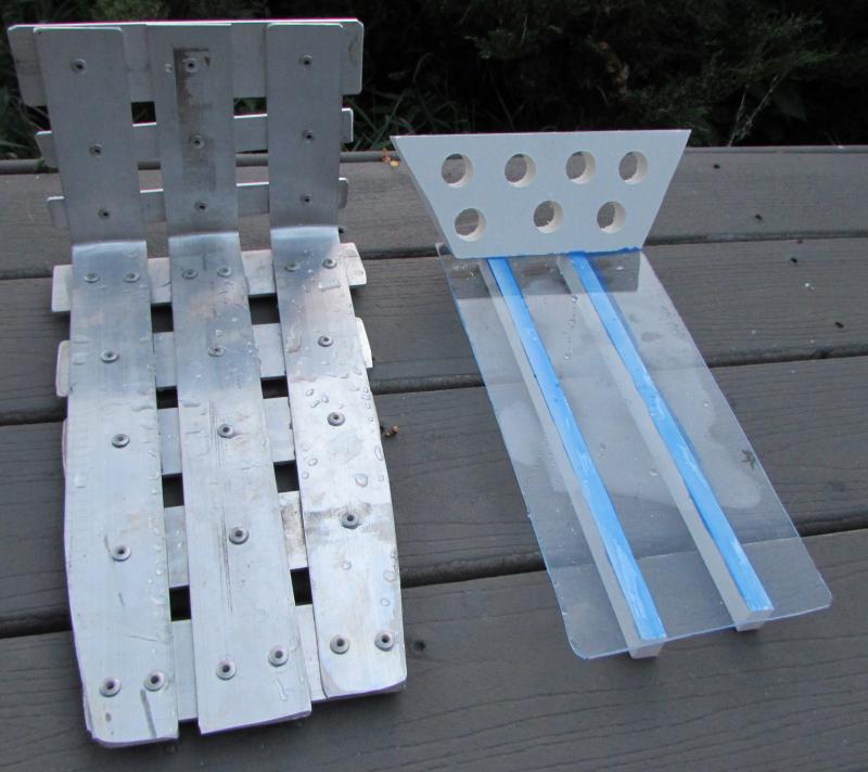

I think that heat sink the ice is sitting on works a little too well if the fan is running..
Ill finish this test but Im thinking about a new heat sink that is much less effective at sucking the cold out of the ice. The cooler wont work as well - but hopefully not go through the ice so fast..

I went ahead and made this "electric ice chest" idea for my Mac 26S and have a little test time on it now with mixed results. The first picture shows the general configuration and there is a .75 watt fan blowing air over ice sitting on an aluminum heat sink in one chamber and the cold air comes in at the bottom of the larger food chamber. The second picture shows a mockup of where it will go in the 26S.
The good thing is that the chest is fairly good at transferring the cold of the ice to the food chamber. I had a little fridge thermometer in the food area and the temperature stayed about 44F - which is somewhere between where a fridge and an ice chest would run.
The negative result was that if I left the fan on all the time, I got just less than 2 days on a 10 pound block of ice. The ice chest has 2 inches of insulation foam on all sides so an R value of maybe 10 and for an ice chest, I think the ice should have lasted longer but I think that circulating air increases the heat flow to the outside. I had the lid clamped down during this test so no air should have been leaking in our out - except when I was checking things which was probably too often.
So.. just partly successful. It will still make a good ice chest and I put a switch on the front so that I can turn the fan off and on which I think will result in slightly warmer temps inside but the ice hopefully will last longer..
It ended up weighing 45 pounds and has nice "Wal-Mart furniture" styling;)

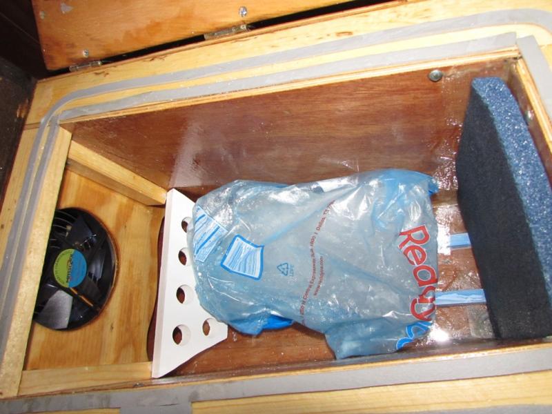

I did a bad thing experiment wise and changed the heat sink to just an "ice stand" in the middle of the experiment.. so I can no longer compare to the 5 day chest. Oh well.. I know the two chamber chest was going to use up the ice block sooner anyhow after one day. Its running agaiin with the same block as before - about 4/10 the original size. The new ice stand is about one pound lighter than the heat sink.

Ill post this before I forget the results - both the plastic five day and the two chamber cooler melted all the ice (one ten pound block put in each chest). When the ice is near melted, both coolers have the inside temperature raise but I would say the five day cooler lasted about 52 hours and the two chamber cooler lasted about 48 hours with the fan constantly running.
I was hoping for longer than 48 hours.. but I guess that is about all it will get. On the other hand, the two chamber chest is a lot nicer to use and the water will be easy to drain. I also attached the picture of the five day ice chest near the end of test.
I screwed with the two chamber configuration during the test making the results no longer "apples to apples". At about 28 hours or so, I had drained the water from the two chamber test and put in the plastic ice shelf instead of the aluminum heat sink. Before I did this, the two chamber chest was running about 3 degrees cooler, after I did this, the two chamber cooler was running about 3 or 4 degrees warmer. So.. I don’t like the plastic ice shelf.
The original aluminum heat sink worked a little too well so I removed some of the Al plates in the heat exchange area and also drilled a bunch of holes in the bottom to reduce surface contact area with the ice. This also got rid of about 0.8 pounds which Im always concerned about since my particular boat sails (and trailers) better if kept as light as possible. I probably wont do another ice block test until I put the cooler in the boat in November (boat is at Lake Havasu AZ, cooler is in Denver).
So.. only partly successful and not as convenient or nice as an electric fridge and goes through ice faster than a five day cooler. But the way I plan to use it, it will end up with about 50 times smaller power load compared to the electric fridge (almost nothing) so my existing electrical system wont need any changes. And I can always put a block of ice in the food area and use it like a conventional ice chest. Or one block in the ice chamber, one block in the foot chamber.
