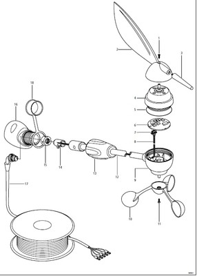

Could you borrow a display unit to verify where fault lies? If it's head unit, could you buy a replacement PCB from eBay and replace it?
That's what I did. It's not difficult to change the small PCB.
