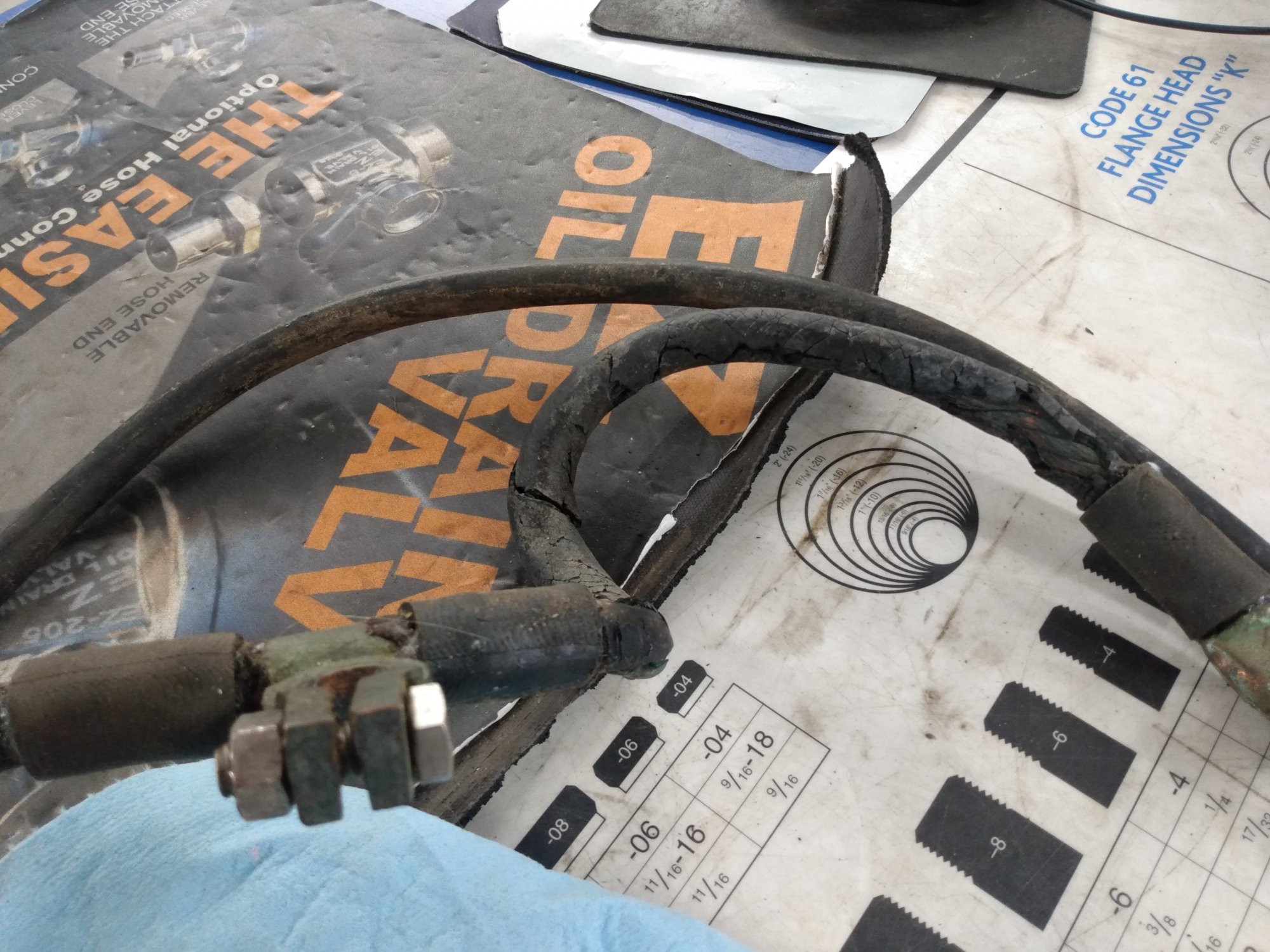

I've got a used boat. OK, OK, it's an OLD boat. Built in 1980. I decided to dump the two old 100ah FLA house batteries for a single lithium 125ah. The lithium battery does not have battery posts but instead you bolt the cables to the battery. PITA because now I have to remove the negative cable from the house and start batteries and the engine block. Need to change the clamp-on terminal for a lug. While removing the negative cable, I felt something strange on the insulation. IMG_20220411_111229366.jpg
Oh, the insulation is completely gone and bare wires are visible. The insulation that is left is completely cooked and flaking off. I suspect that a previous owner had a hard time starting the engine and ran the starter way too long. And I went from modifying the negative cable to replacing all the battery cables. How I and the previous owners managed to not burn up the boat, I'll never know.

That doesn't look like heat damage. Maybe just age, maybe the PO had an ozone generator, or maybe an extreme chemical reaction to NosGuard or other anti-mildew product using CLO2 as an active ingredient.
From a web search: "Does chlorine dioxide react with plastic?
Results show that ClO2 has a deep effect on all the materials tested (plastics and metals) and that severe damage occurs due to its strong oxidizing power in terms of surface chemical modification of metals and progressive cracking of plastics."
Another reference:
"The strong oxidants (i.e., chlorine and chloramine) found in municipal water damage the rubber seals, gaskets, and toilet flappers in your home, and can attack the rubber pieces on more expensive water appliances too."

This photo is exactly why the ABYCstandards disallow welding cable or EPDM jacketed wire.... That's what it does...
